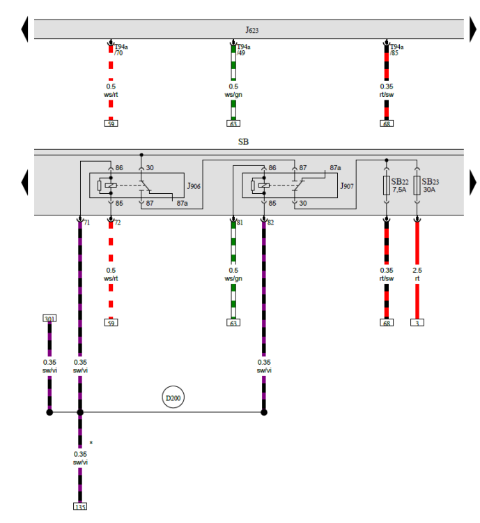

Is there someone here that knows where i can place interruption on a / relay / fuse  ... to prevent car from starting.
I place on my car  a switch so if this is on you can not start car.

The simplest way might be to put a concealed switch in the supply for the fuel pump.
Hi Customer want this because hi wants that driver first need to place a Dallas ID key before the car can be started.
Hello I think i found it fuse box under hood near battery Relay J906.
