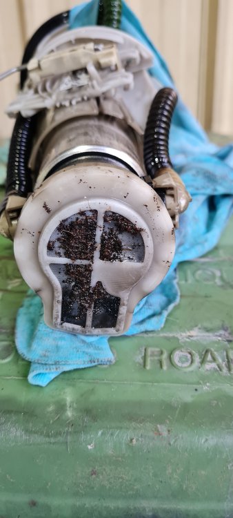

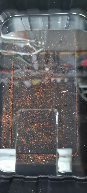

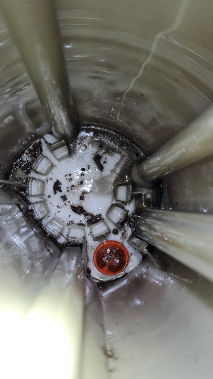

Have a look my diesel fuel pump from last year(different vehicle). The in-line filter positioned just after  this pump was also in bad shape -  imagine getting petrol with those sorts of contaminants in a Fabia. The middle image is the dirt that came out of the swirl pot in which the pump (first image) was located. The third image is the interior of the swirl pot after removing the pump. The fuel came from an independent and generic fuel station - same brand is all over Australia advertising cheaper fuel.
Additionally in the Fabia, there is no sensor in the LP side to monitor pressure output from the LP pump - another omission by the engineers in my opinion. However maybe the fuel pump current is monitored and reported by OBD PID.

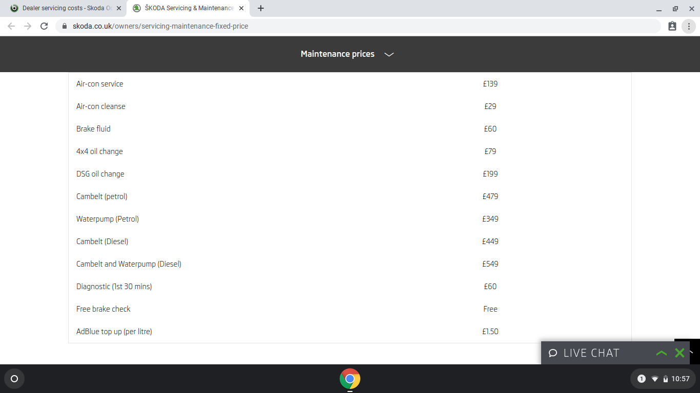

That service interval shows for the cars when there was a filter in-line,  MK2 Fabia and TDI,s.  As with DSG,s it shows a service interval but Fabia have Dq200,s with no oil change interval.     Simples really, don't worry about contaminated diesel when you have a petrol car.  And don't buy European cars if you need a car suitable for Australia.  Buy a Japanese or Korean.
1168293554_37335614_Screenshot2021-09-14at07_38_18(3).webp.ee5b8a609f78b3b2f42441d7532010fa.webp.03b06c85571b53b664b7942fca3ad3bc.webp.f393ed8c476db32331ff95a994fd58a3.webp
