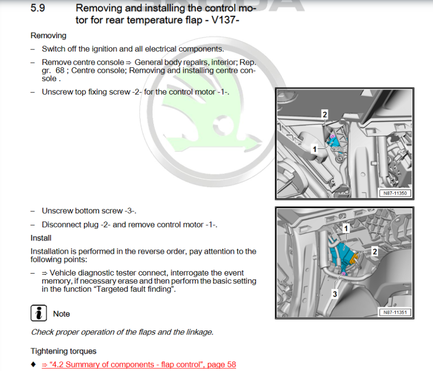

See below; as you can see, although its a very short guide, the second section being remove centre console is a big one.
The motor for the temperature control at the rear is located almost directly behind the heater control panel itself but cannot be accessed without removing the complete centre console.
(Keep in mind this is far from the worst one to access so count yourself lucky you dont have to remove the entire dashboard)
