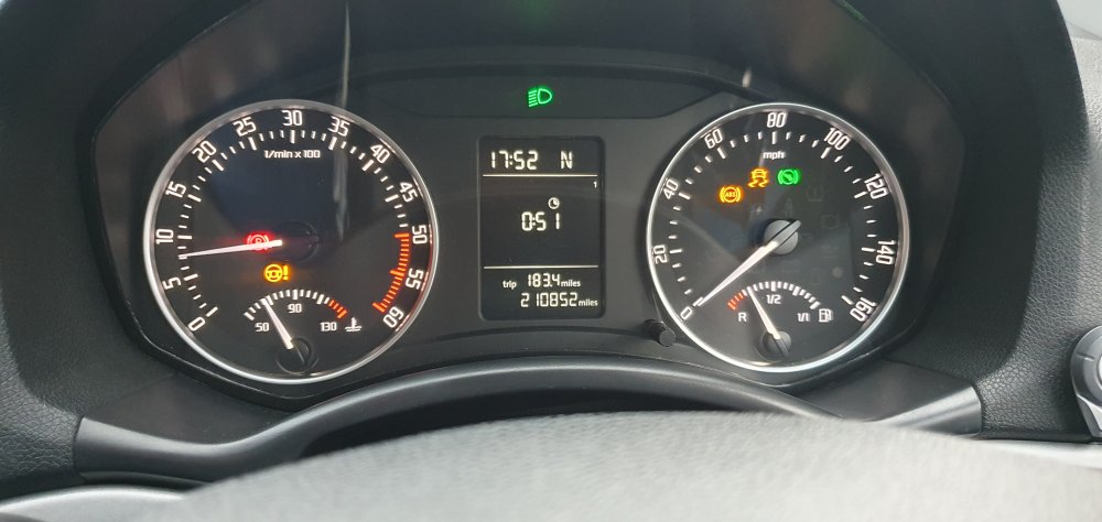

Hello Everyone,
I've noticed these 3 warning lights are showing up here and there only for couple of seconds then disappear in thin air !!!!
Can someone shed some light on this please as it's annoying more than anything else 🙄
Thanks
I can see 6 "idiot lights" on the facia, so which 3?
If I'm not colour blind then they are yellow/amber that's why they are known as warning lights 😂
Have the car scanned, I would guess it has something to do with a faulting wheel speed sensor, possibly just a bad electrical connection/chaffed wire.
So steering sensor, ABS and traction control then. Check the battery is holding a good charge (actual charge, not just starting well).
