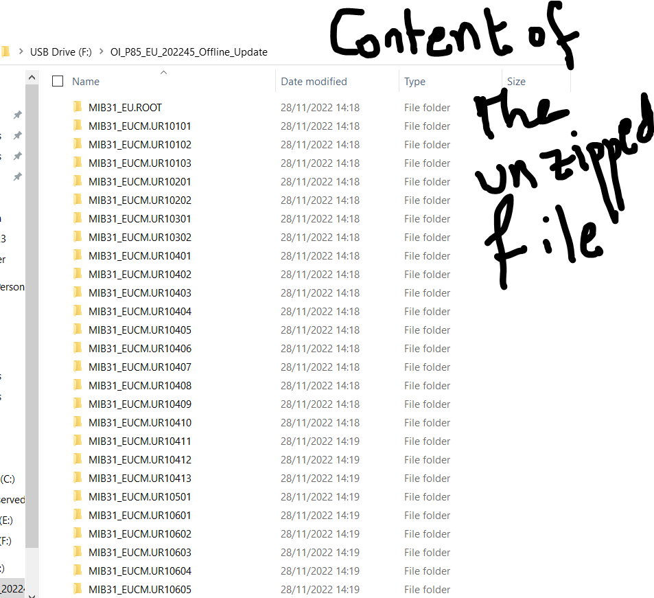

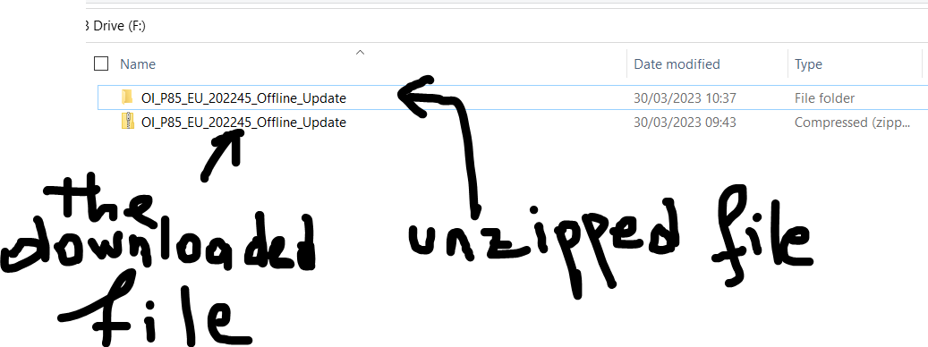

I have downloaded from Skoda portal a large file based on my vin number .
when I unzipped it it contained many other files . do I have to copy all files into the USB and insert in the vehicle  or can i hose a specific file based on my region like UK and ROI maps only
on Skoda`s Website it says do not use the entire file , a bit confused here

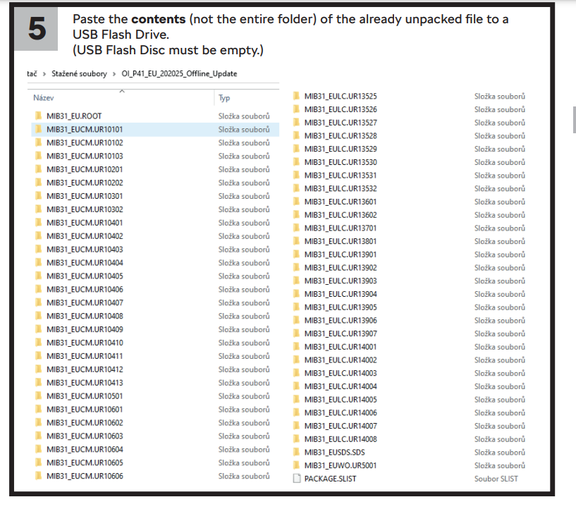

You need to unpack the Zip to Desktop, or any other temporary folder.
Then you need to copy all the folders and files to the root of the USB drive
So for example F:\MIB31_xxxxxxxxx,
not F:\OI_P41_EU_202025_Offline_Update folder name

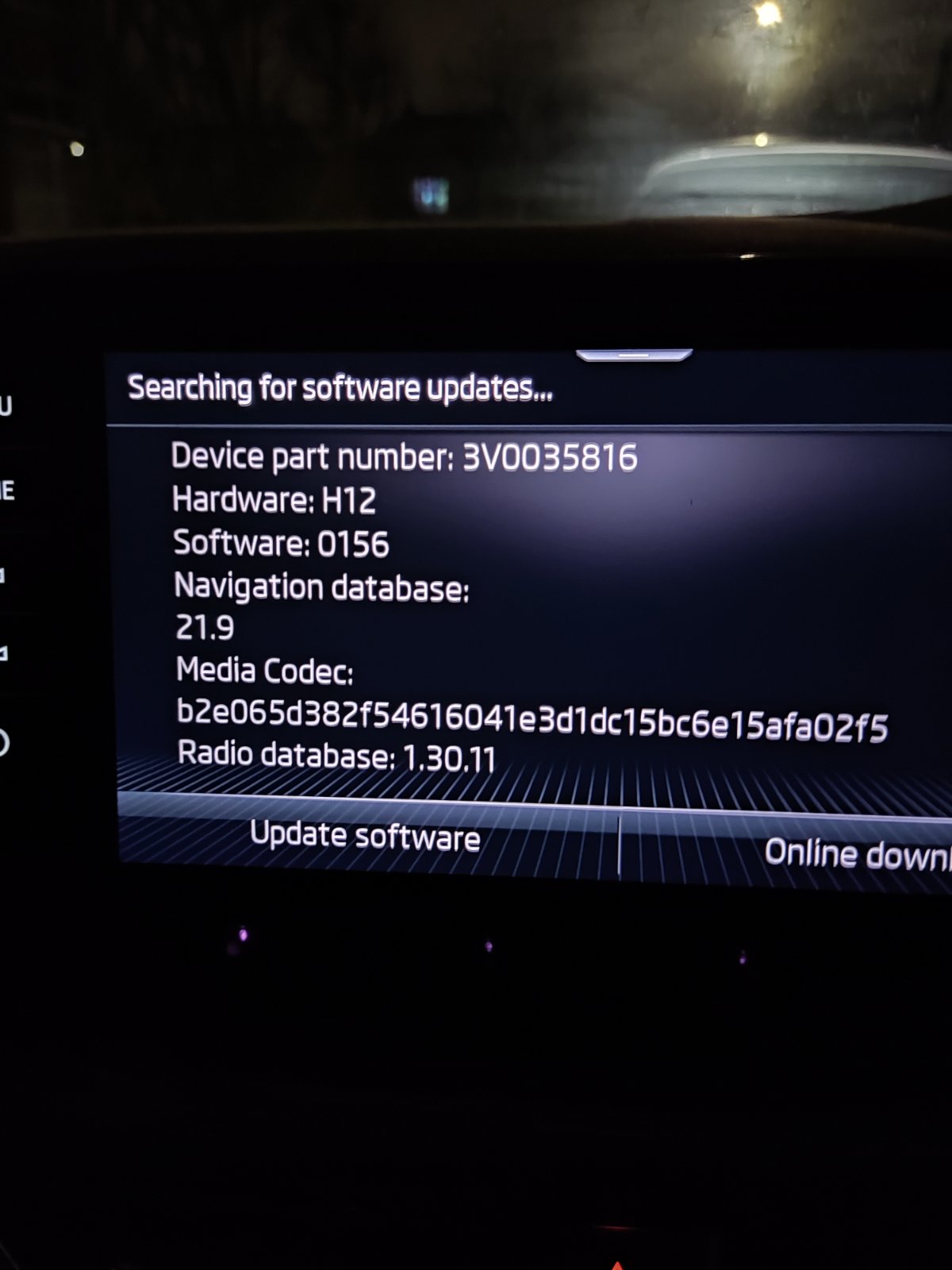

I don`t know what exactly happened , but looks like my maps did update yesterday after posting this .
I have used the usb 3 file method , but also fiddled with online update as well .
I understand the file is very large so it would have taken a all my mobile phone plan ( I used my phone as a hotspot) but it did not use more than a few mb`s.
i also left the usb attached but for like 10 mn max ( that is surely not enough ???)
I have no idea what is going on here 2_19.thumb.jpg.8b9b2f60d75219c0e6d5df9b0427e8f8.jpg1307650299_MIB3SOFTWARE.thumb.jpg.547359fd1826e8fe520f9ea19bdf6e08.jpg
