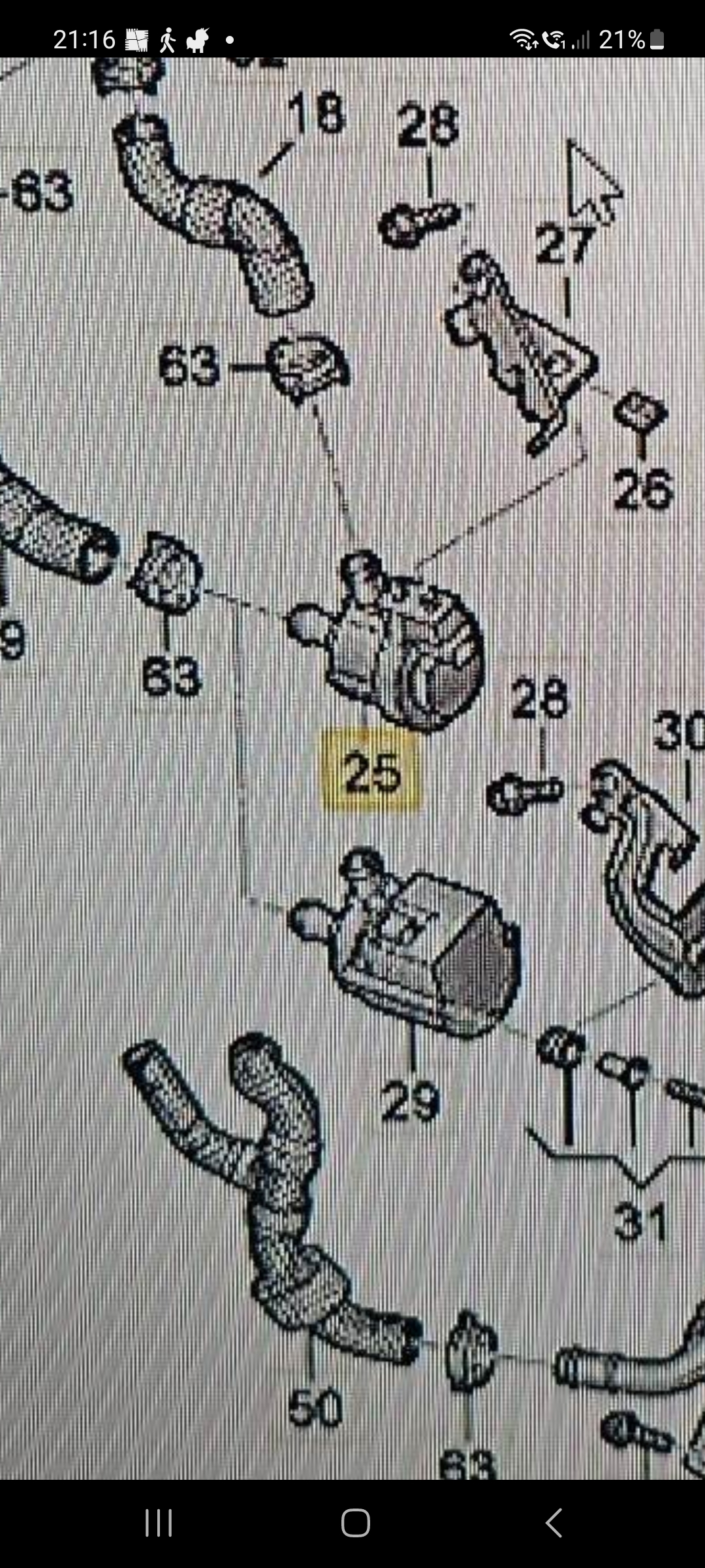

Had a fault code come up on Skoda Superb 2.0tdi 190bhp 2016. Fault code is :- 6E5DH/28253 undocumented code. Looking on net code is Secondary water pump. Problem is which is secondary pump. Got a picture, wondered is it number 25 or 29. What is common to go. Car running fine but displaying engine fault light on dash.

There are multiple, you’ll need a better diagnostic tool which will pull the additional code data to tell you A/B/C etc then you can start unplugging to see which one shows open circuit
