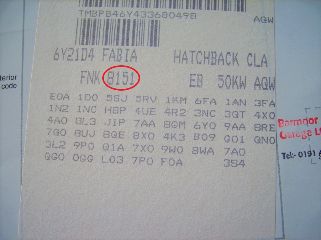

Foud the stuff, but now comes another question. How do I find paint code of Furby. My local paint shop can get me a 90% match, and local Halfrauds can get match on VIN, but its hiding place is a mystery, and I do not really trust Harrys{as on broomstickes) + mates in Halfrauds.
On the production code sticker in the front of your service book & also under the boot carpet. For example, mine is 8151 (Corrida Red).....

In typical "tidy it away as done in over the river format" SWMBO has decided that my "brought into house for safekeeping" service manual was put in a safe place( skill passed down from mother to daughter in the boro as FIL told me) and my mobility scooter has rubbed the label under boot carpet. So only place I have I have to look is on VIN label( Passenger side on front inside wing/on V5). Once upon a time, long time ago e had a post on vehicle labels and I did post mine up. Sadly I can't find it, but if any( possible mod) can resurrect post I'd be grateful.
