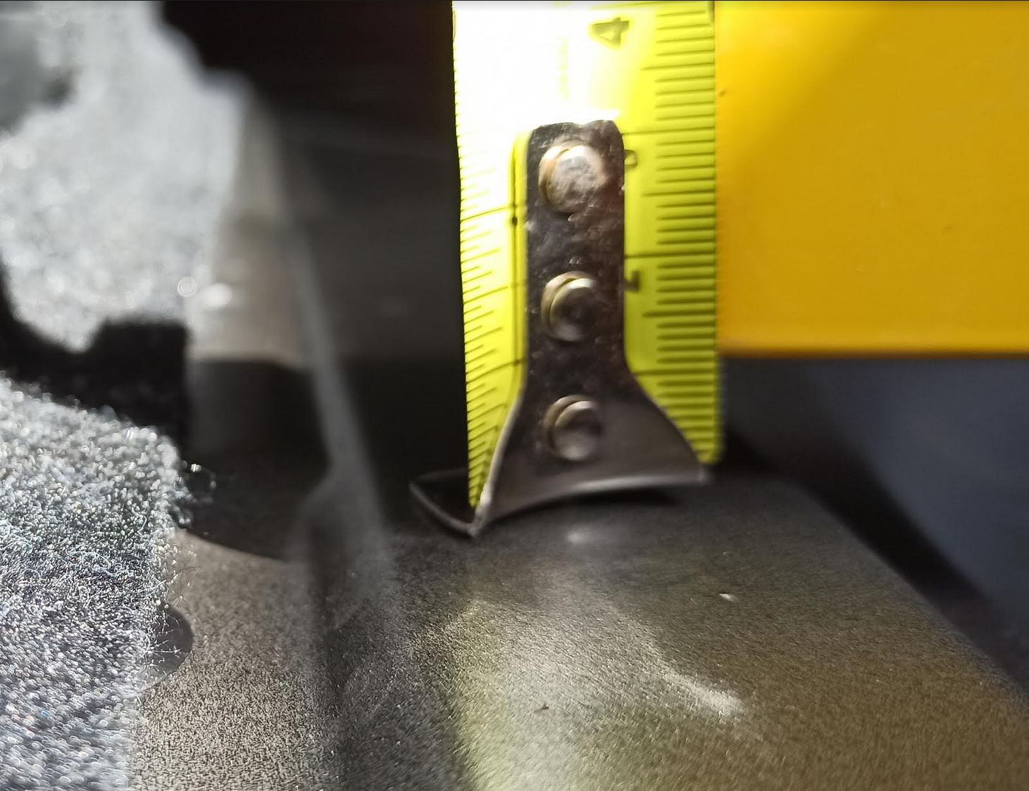

Will have to check it again. I just wonder, if estate has the well a bit deeper by any chance???
So I checked it today, and with 225/40R18 I am about 12mm above the floor level.
So with a bit of a scrap plywood (2x12mm) I should be able to fit 235/45R18. I am very tempted to get it sorted as I hate the idea of space saver (still better than the repair kit).
