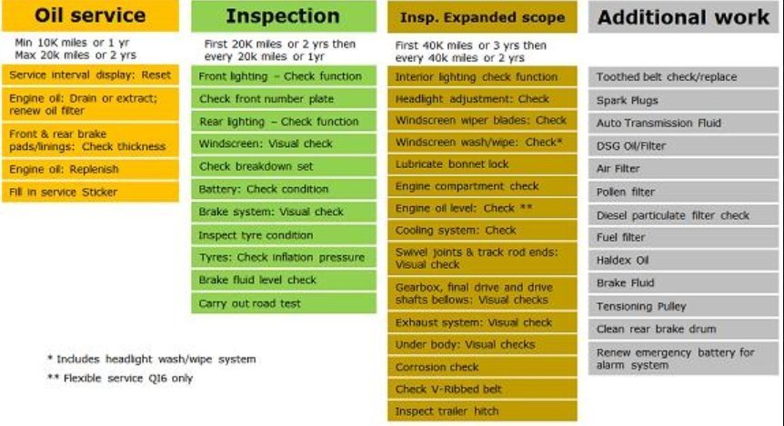

Service & maintenance history documented.
Not just the Oil & filters,
but the DSG serviced at least twice by now, the cam belt and water pump done, brake fluid changed, fuel filter etc etc.
Then condition condition condition of stuff now that will cost you if you have to replace. Tyres, brake discs, wiper blades even, windscreen for chips.
Then is it priced according to it's condition and service history or at the price allowing you to spend on what there is no record of being done.
Be sure of invoices showing the DSG serviced.
1179912860_922218293_Screenshot2022-09-2115_58_57.jpg.3711dc86397a804fc83f268add4ae736(1).jpg.606196879c2532f67305f1ec411800c6.jpg
