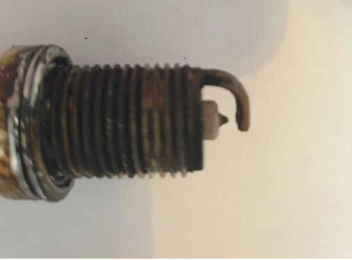

I'd grown to mistrust the garage I had been using and so eventually got a diagnostic thingy and software of dubious origin. When I finally got that to work, it said "misfire on cylinder 4". Figure it had to be plug, coil pack or injector, I bought a set of plugs and a single coil pack. Replaced the plugs (they were far gone - had the garage never changed them?), put in the new coil, cleared the faults, started the car and the misfire is gone.
Driving back from work today in the heat, I realise that I've been going for over half an hour and the aircon is still working. I remembered a story I heard ages back about a guy who fixed his rear wiper by changing the plugs (interference on the CAN Bus). I try my rear wiper which had only been working very occaisionally (not an MOT fail so I left it). It works. Aircon worked all the way home (about 1 hour 20).

My theory (probably wrong) is that the elderly plugs were making the coil packs work so hard to generate a spark that it was generating a load of noise on the electrics, disrupting the CAN Bus. Without messing with an oscilloscope (or other expensive piece of hardware which I do not own and don't know how to use) I have no way of proving it.
Photo of plug:
