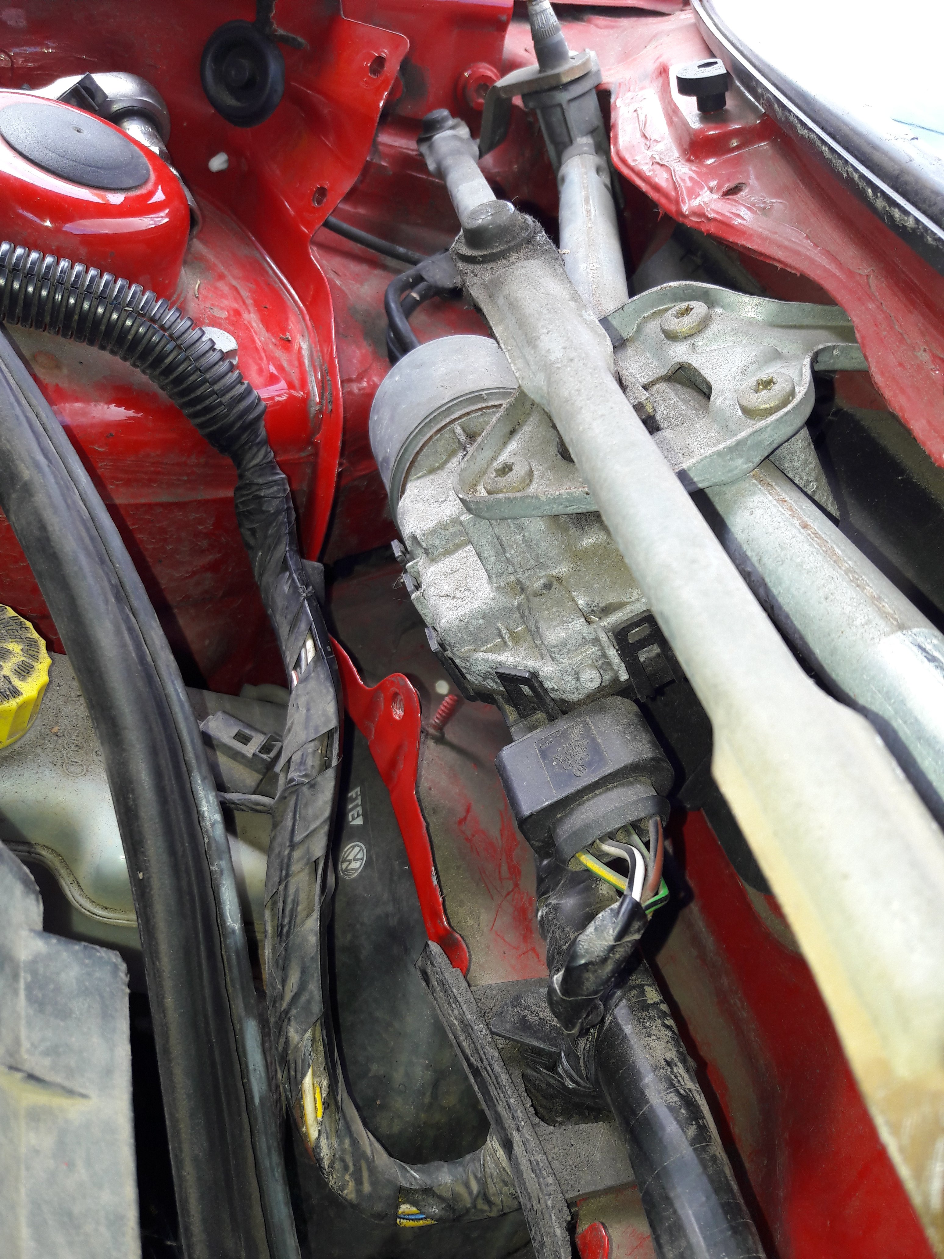

Water pouring pouring down bulkhead
Is it normal for water to pour down the scuttle panel and bulkhead within the engine bay? There's no water ingress to the cabin (so far). I gently tested with a water hose around the wiper spindles (bonnet open). The water isn't lapping over the edge of the seal to the bonnet; it seems just to go straight down past the wiper motor and emerge behind the sound-dampening felt and over the brake and clutch pipes and servo.
Not sure if there's something adrift there or if it's designed that way.

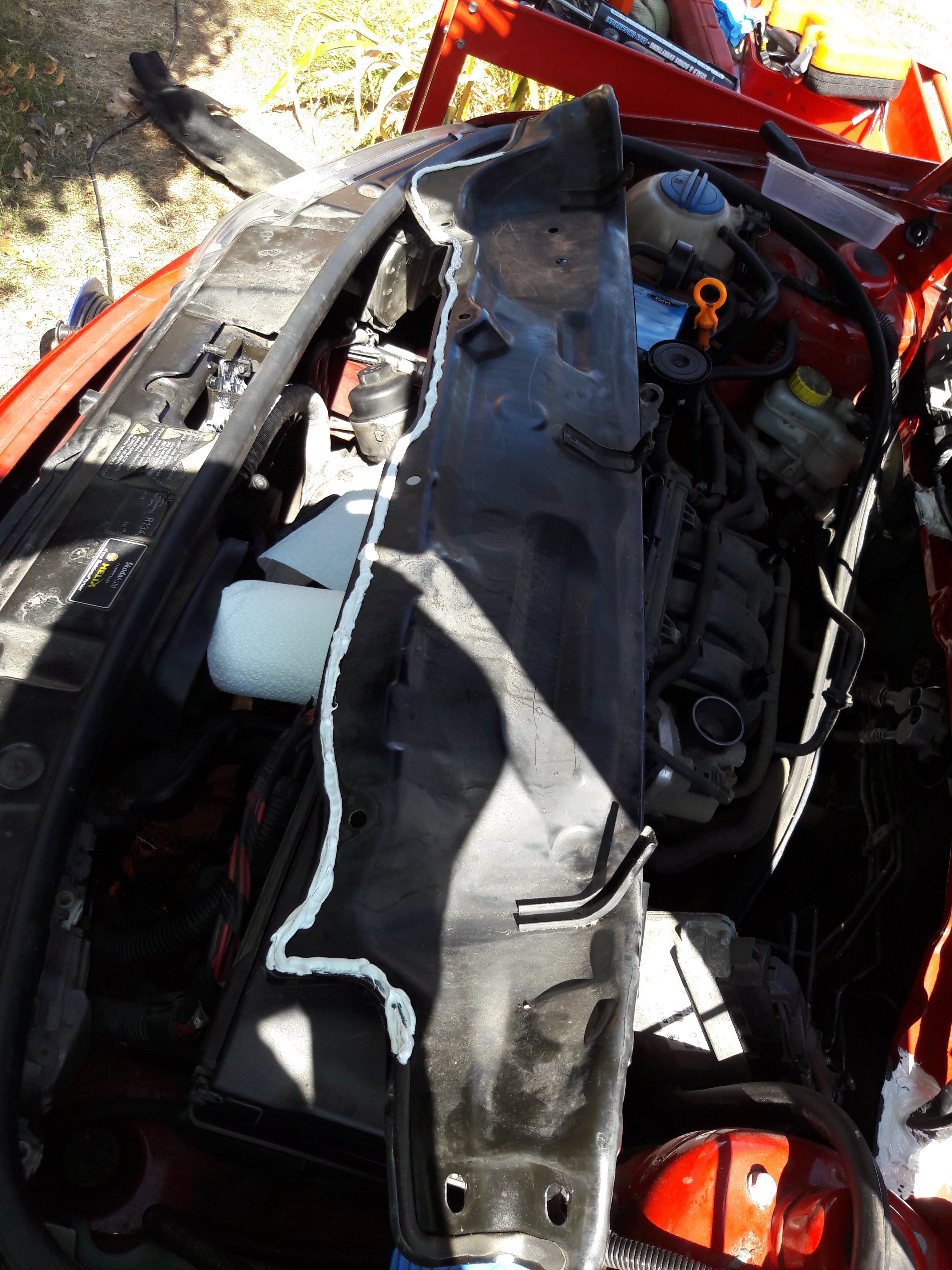

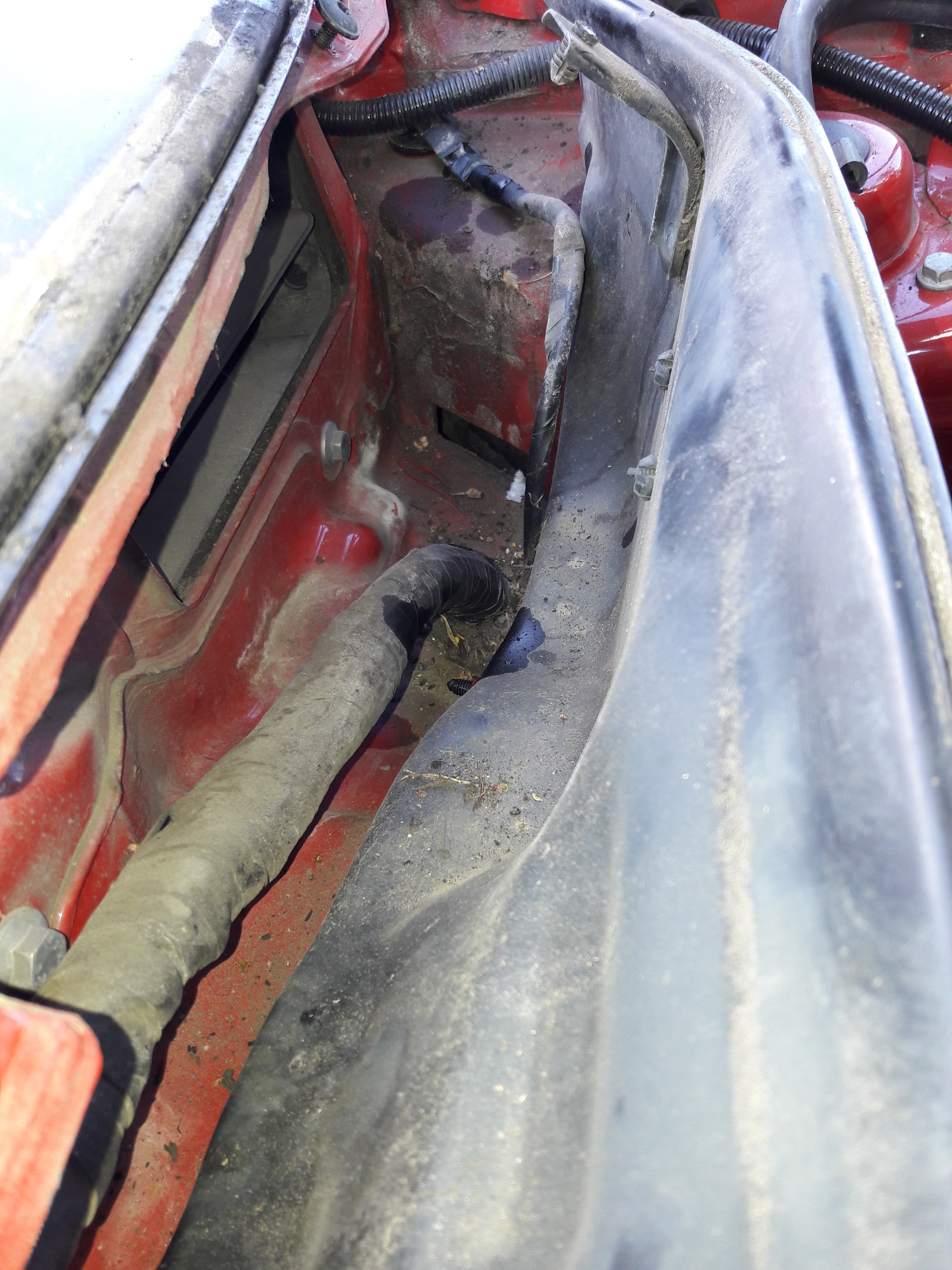

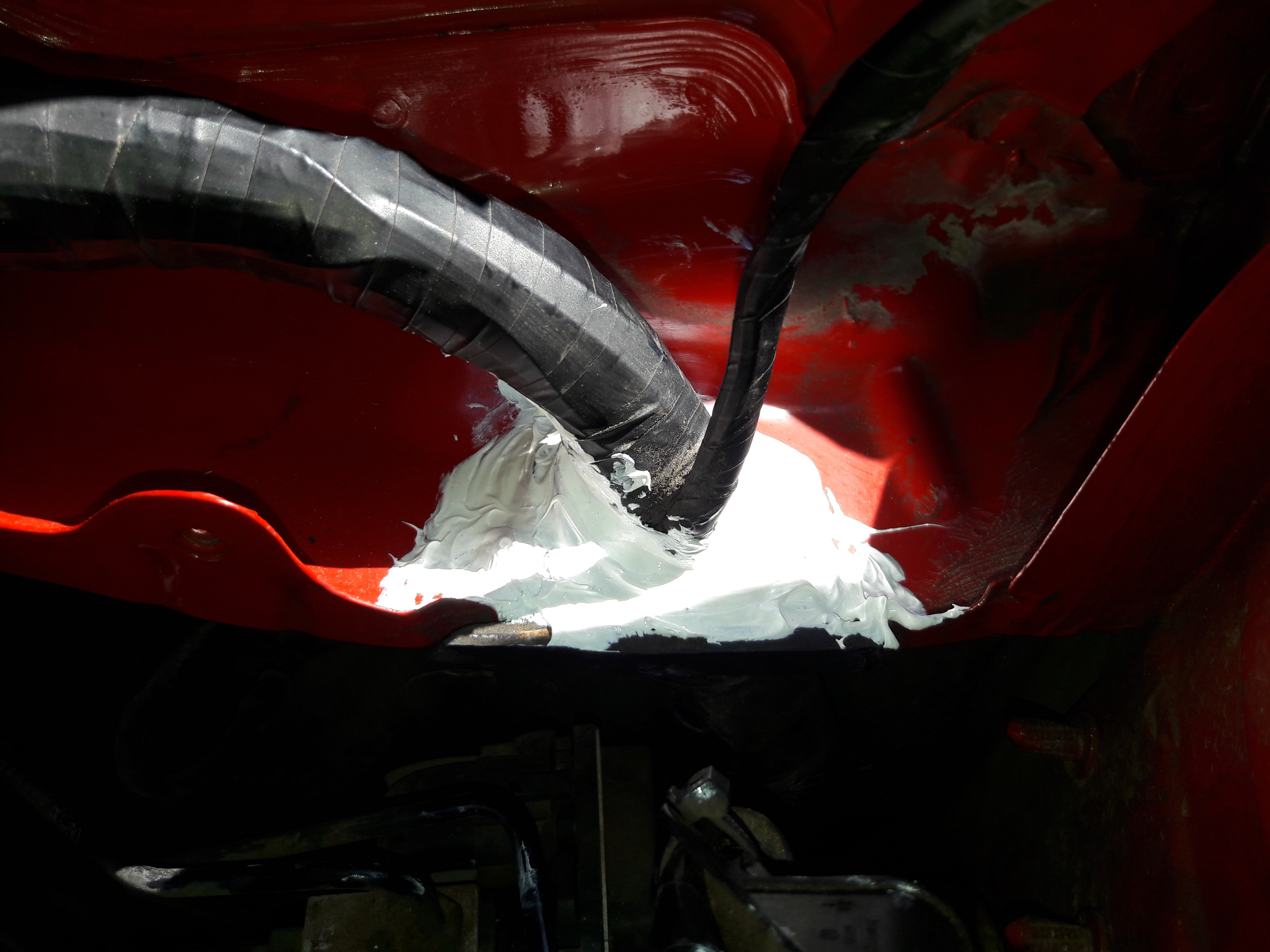

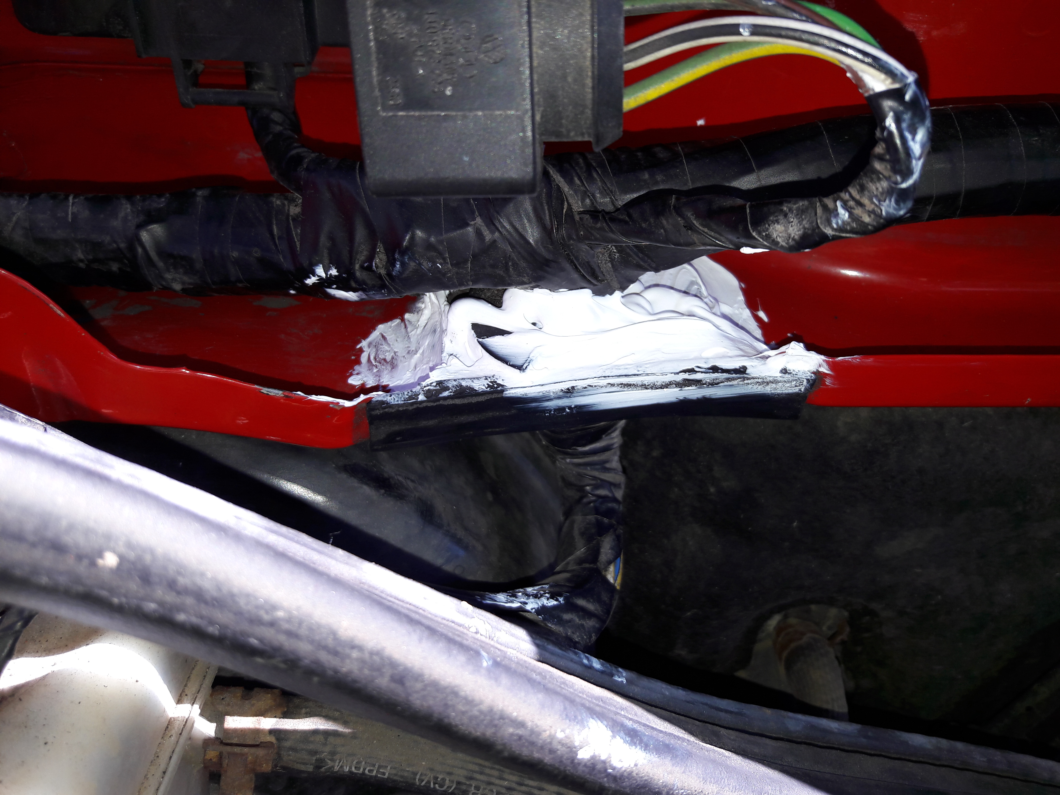

Job done and problem fixed. The seal had perished beyond belief, which explains the Niagara Falls effect over the entire width of the bulkhead. The grommet/seal for the main cable was challenging and required several more attempts after I'd reinstalled the metal panel, as water was going down the middle of it too, which I hadn't anticipated.
I used Wynn's Black Instant Gasket Maker Silicone. Cleaning off the old cruddy seal was a challenge though.
As requested, photos attached of the Mk II ...
  • Sponsor
Looks identical to mk1, at first glance. We'll done and thanks for posting back with pics. :thumbup:
