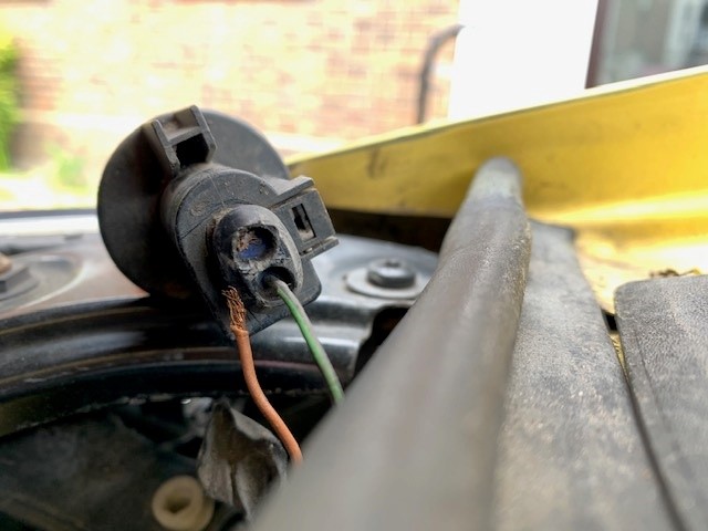

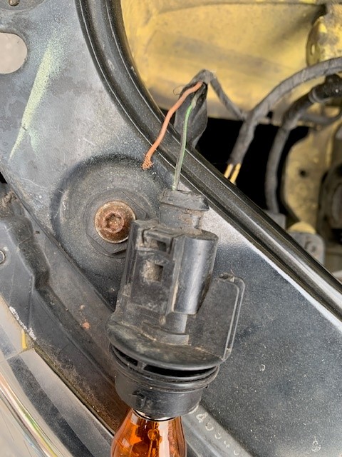

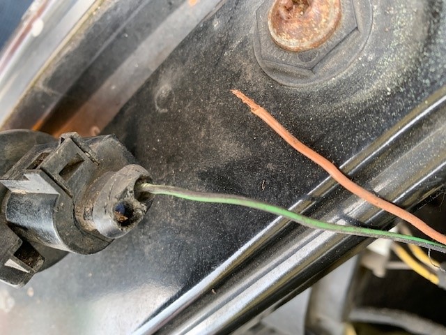

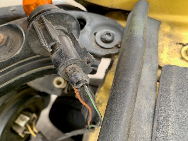

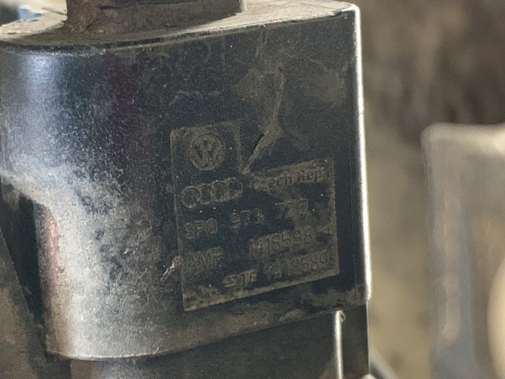

The right off side indicator bulb was not working. Opened the bonnet, there was superglue betweem the wire and the holder!
Now I have cleaned the wire (Exposed contacts) and few bits of wire sticking out of the plastic holder (exposed contacts)
How do I join these two together, (Joining them together, holding with my finger and turning on hazard indicator means the bulb works!
Local garage (Halfords in Uk) is asking £25. I mean I just need to join two wires.
Is there a way to remove the plastic and stick the new one in like house hold wiring or go for a solder? Thinking of getting a gas solder. (Afraid of melting the plastic!)
Uploaded some pictures.
Thanks,

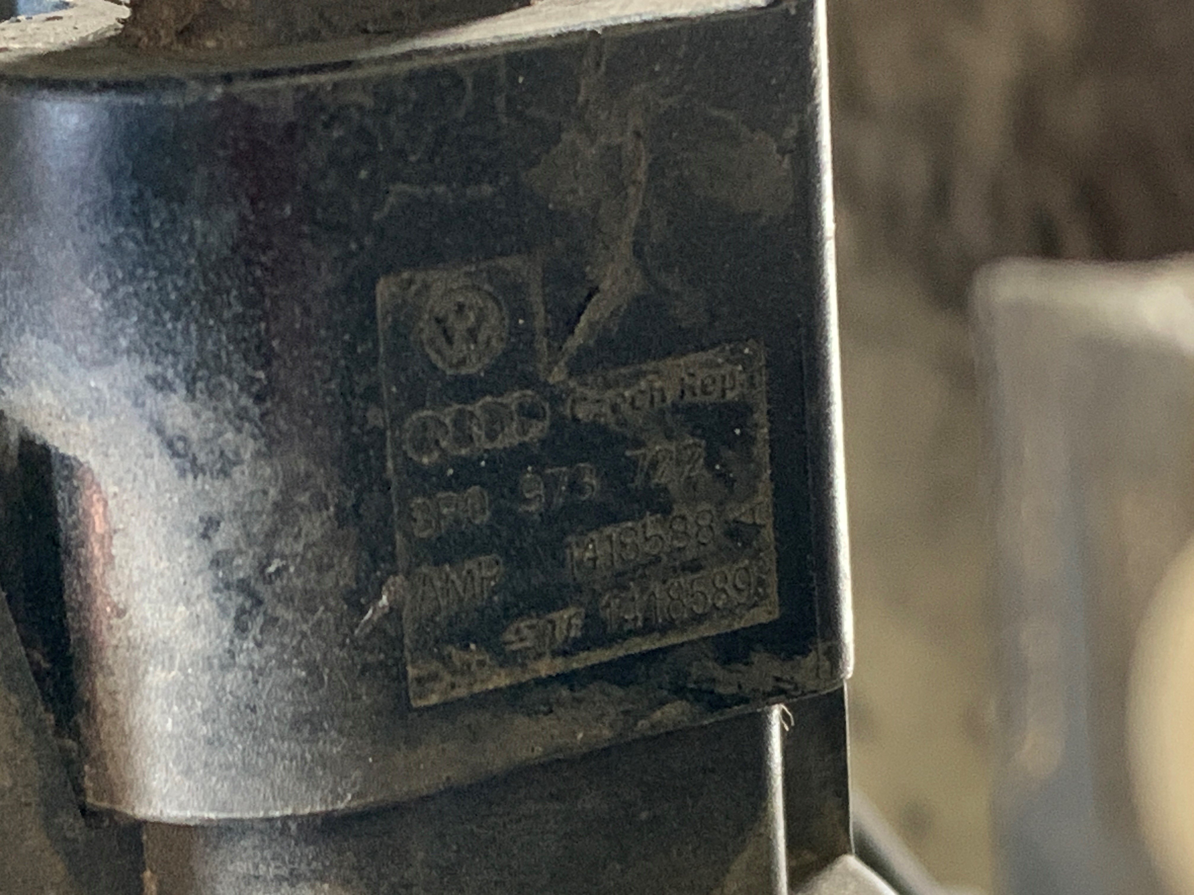

There's very likely to be a part number on that connector. If you put that number into ebay search box, with a little bit of luck you'll get hits that include such a connector with short wire tails hanging out of it.
Then you can join to existing wires well away from connector plastic.
Good idea! I noticed it says VW and some numbers number.
Found a connector. Looks like I have to remove a the plastic bit that goes over the bulb holder (male and female connector) Mine is stuck! Not budging one bit!
Golf Wiring Harness Repair Kit Fits VW T5 Polo OE 1J0 973 722 A S1 Febi 171901 4054224719015 | eBay

Look up 'vw connector removal' on YouTube.
There's a knack involving a push, rather than pull, prior to releasing latch.

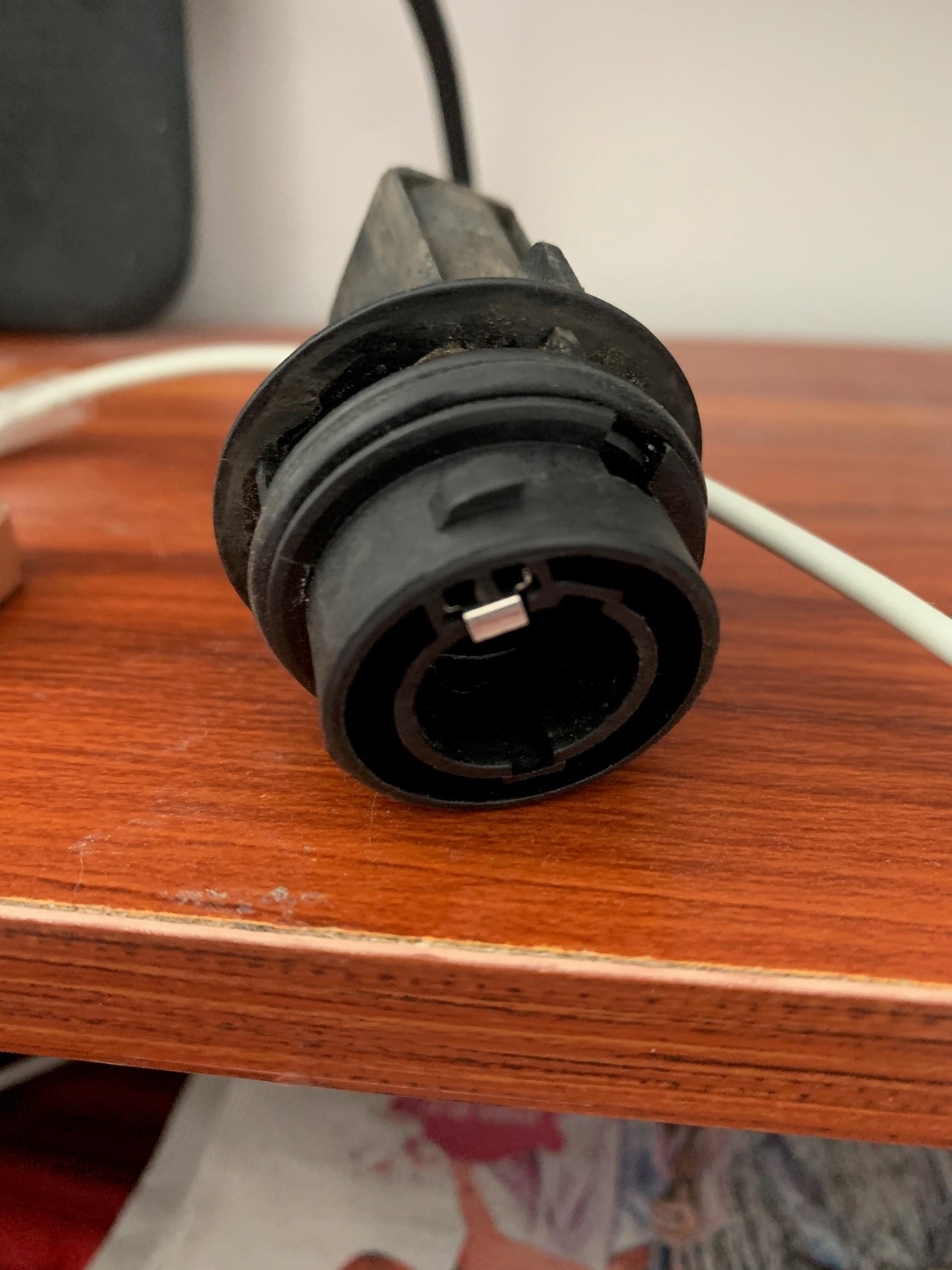

This thing is an work of art! Not a single dust spec was inside the connector and it's a decade old!
Push in, press the plastic bit and pull out. Simple and effective.
Was able to get it out, thanks for your help Pete!
