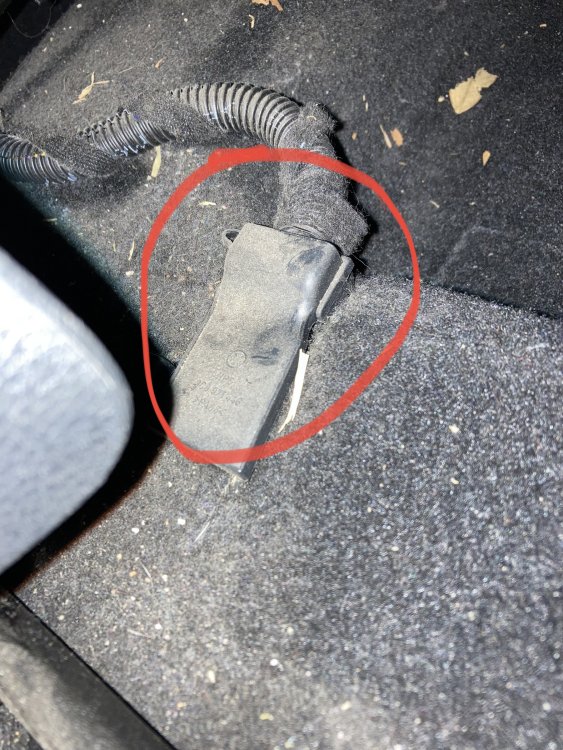

I've attached some photos of what the B-T Audio button looks like and I have shown a photo of what I hope is the bluetooth module. If it isn't please let me know. Many thanks.

If an external Bluetooth module is fitted you will find it beneath a plastic cover under the driver's seat. What head unit is fitted to your car? Does BT work for phonecalls?

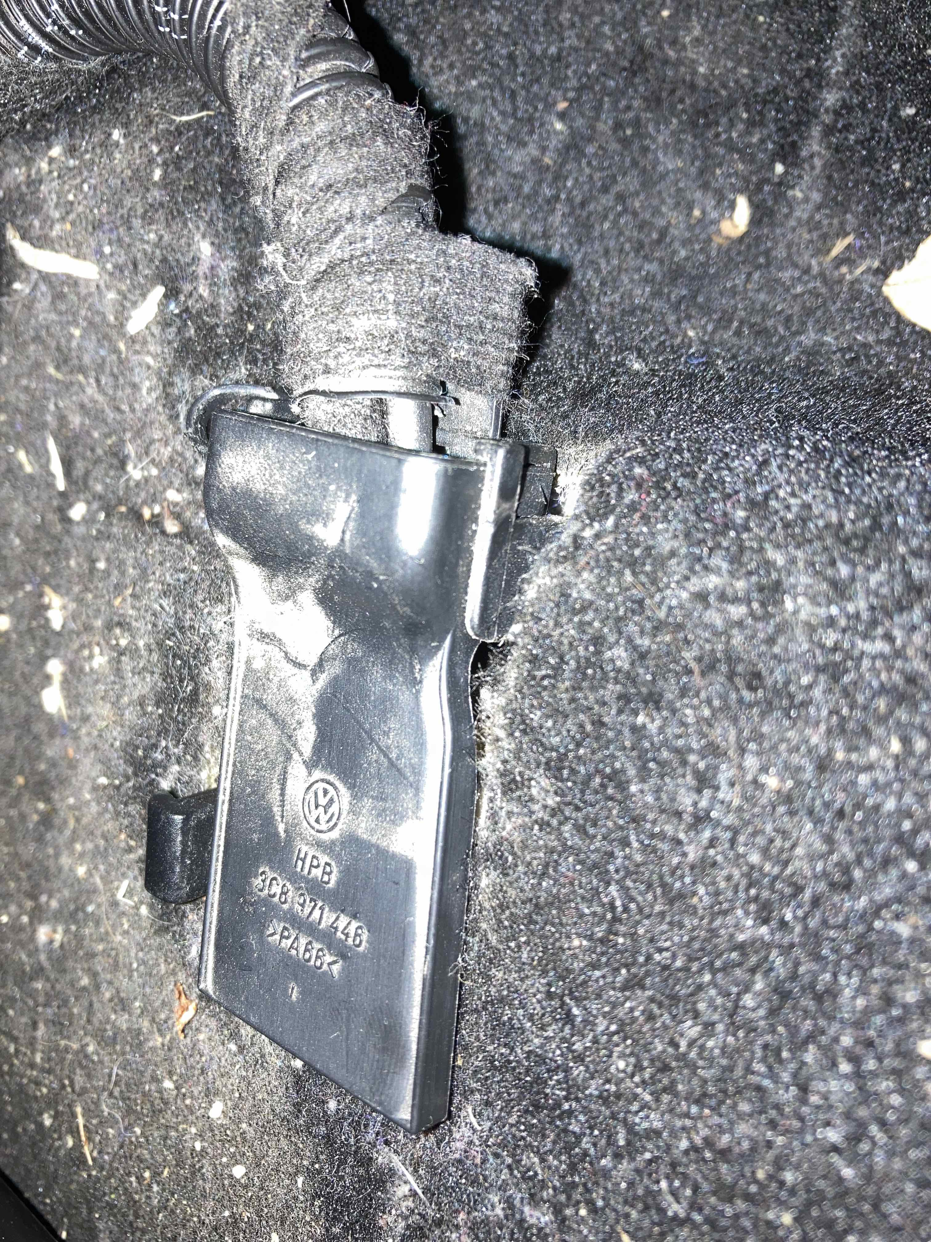

I believe it's a Bolero. I cannot connect to the bluetooth so I'm not sure if it works for calls. I have found the module, but I can't seem to unplug it. Thanks.

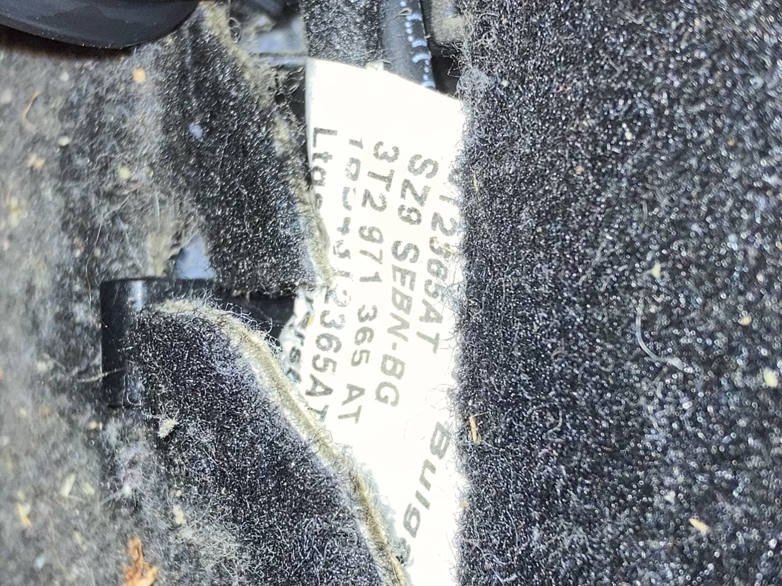

Can you post a picture of the label on the BT module? I've some recollection that certain earlier versions had compatibility issues with some phones, and it would help to know what you have in your car.
Yeah mate. I apologise for the poor quality.
That's not it. This thread shows what you're looking for:
