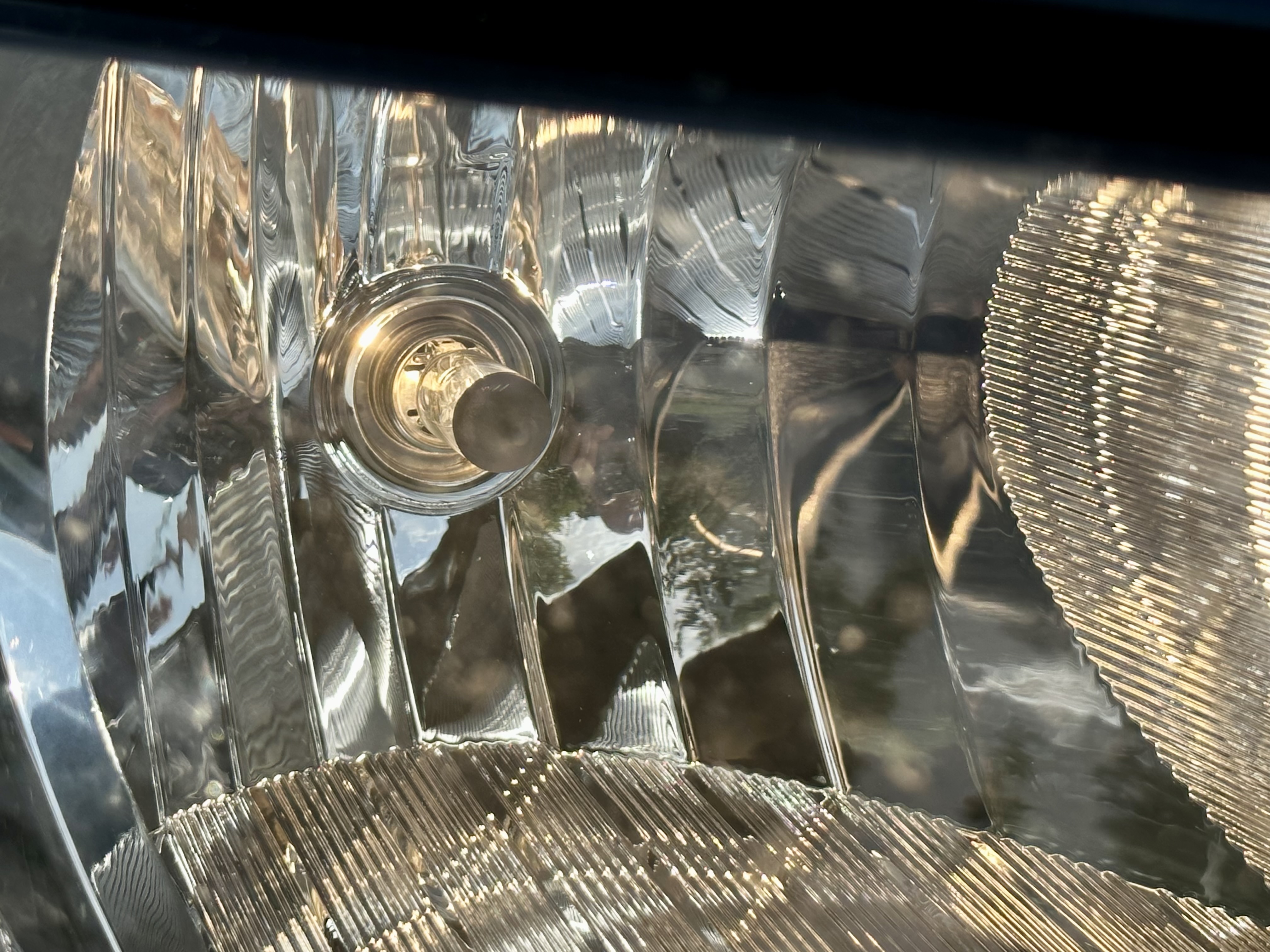

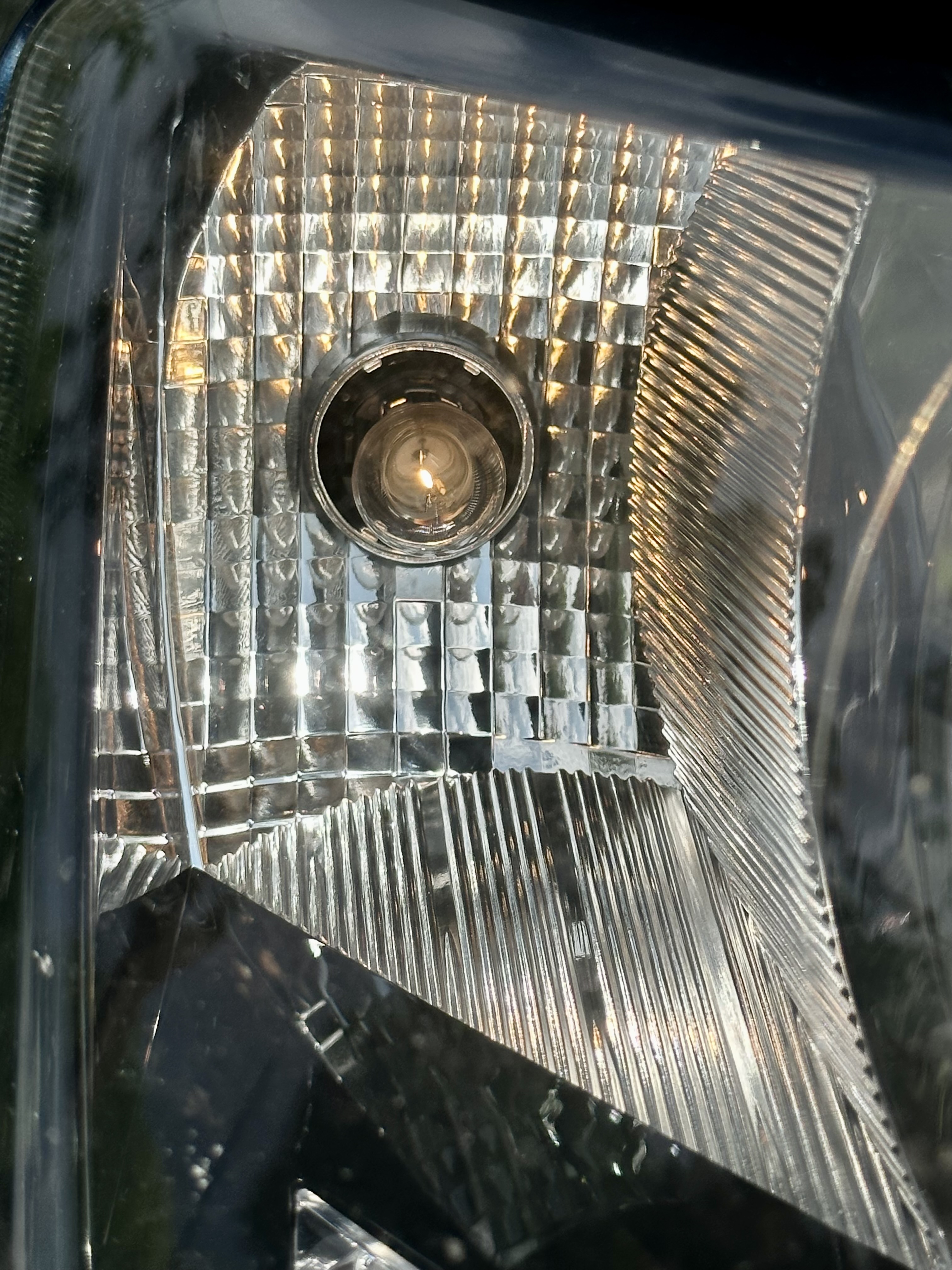

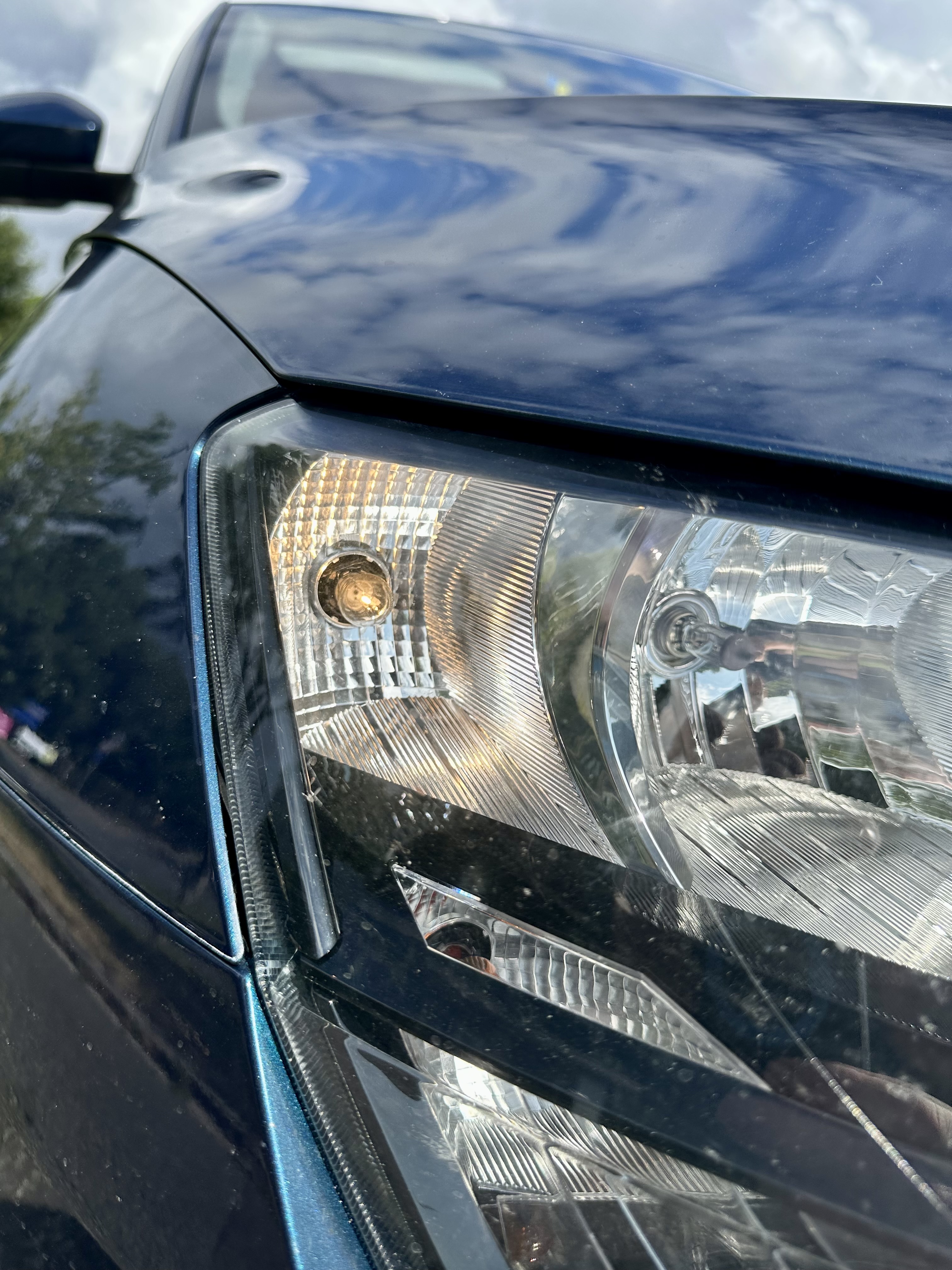

From the photos the sidelight looks like a 382 bulb
the headlight looks like a H7.
Take note that as the side light is used as a dimmable bulb you will struggle to find a suitable LED replacement - most will just flicker constantly.
Also take note that fitting an LED headlight bulb in a non approved housing is illegal and also an instant MOT fail.
