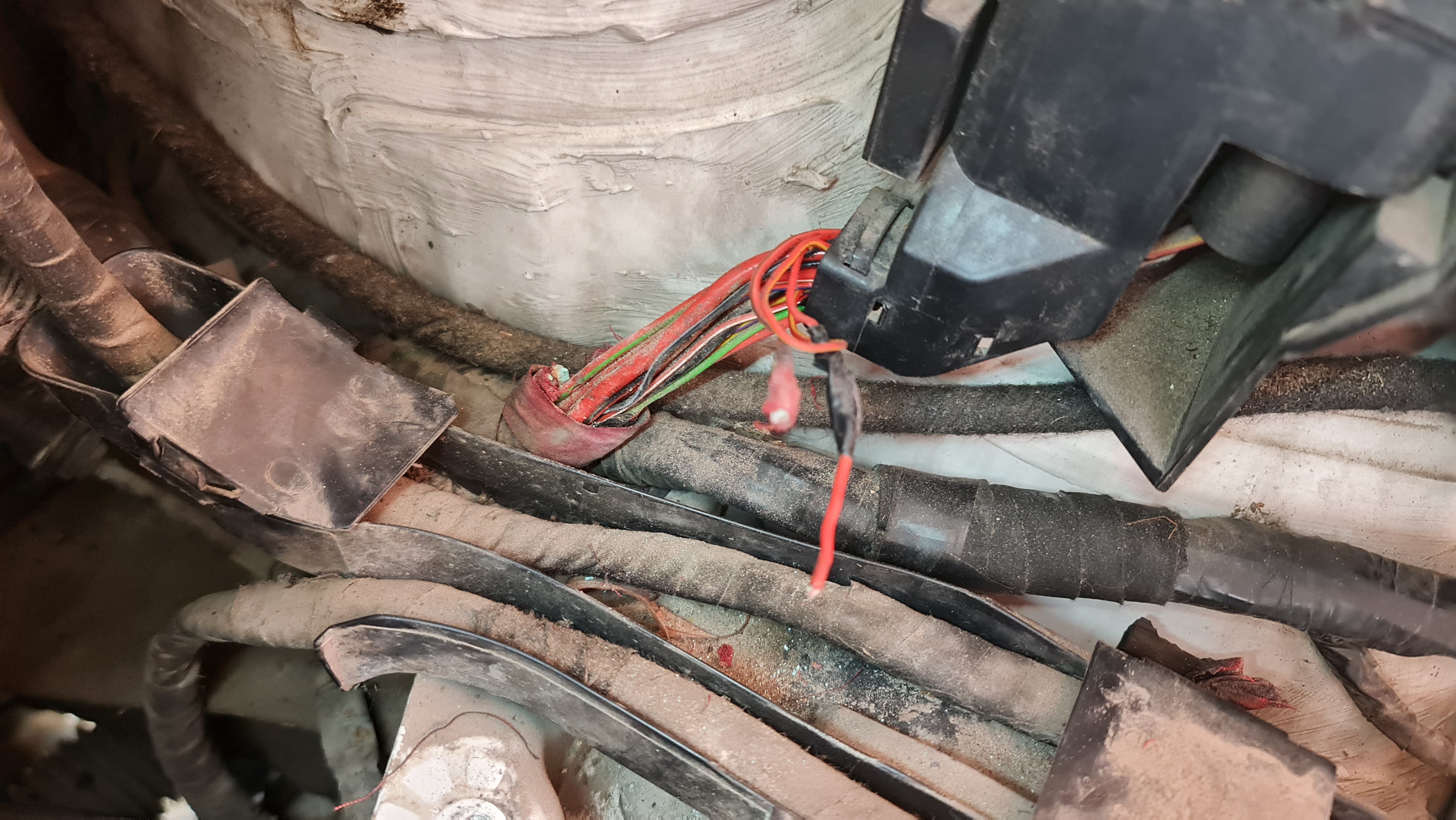

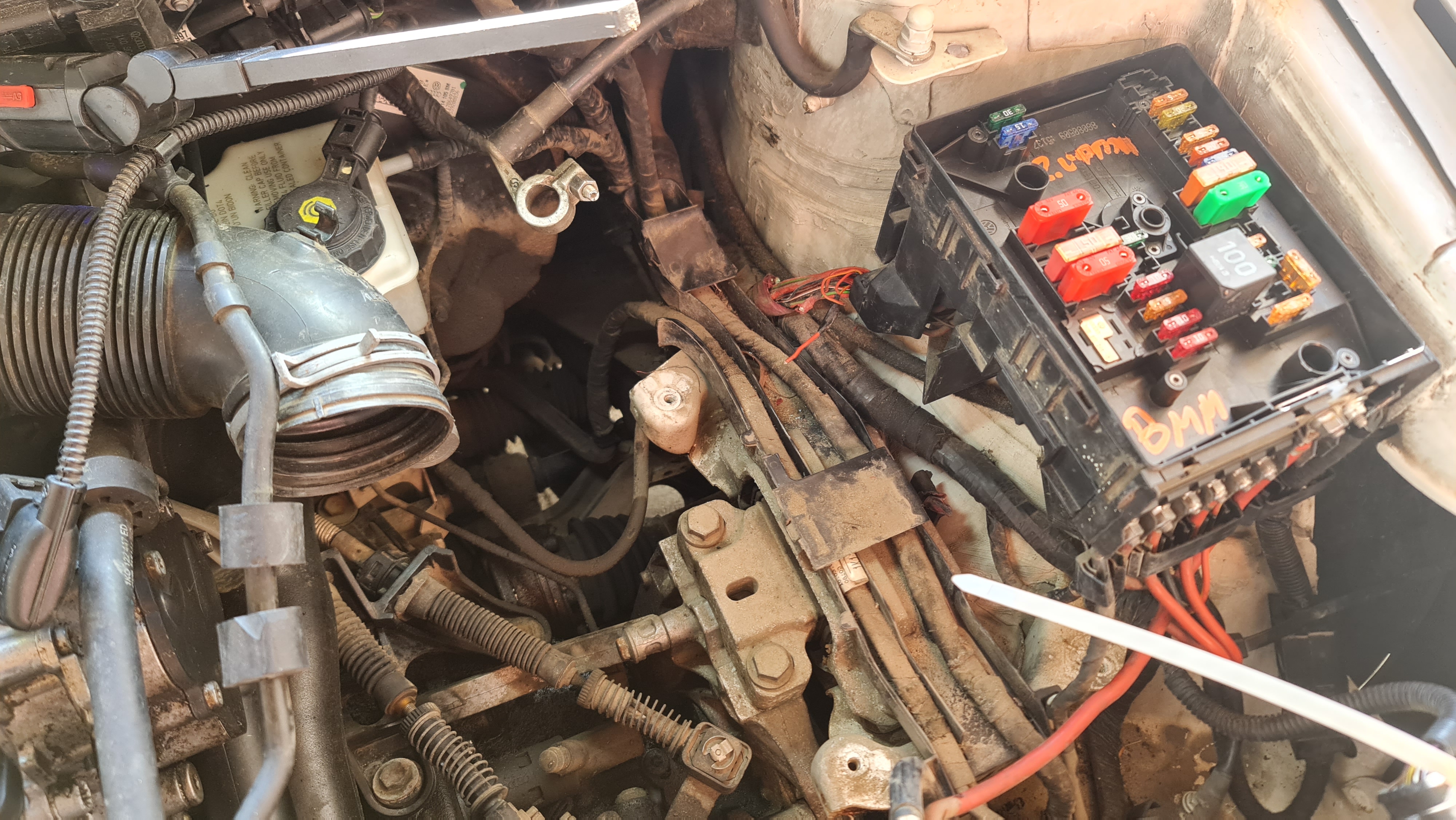

Is that a fractured wire in the second photo amongst the red tape around the loom? A previous bodge come to light?
