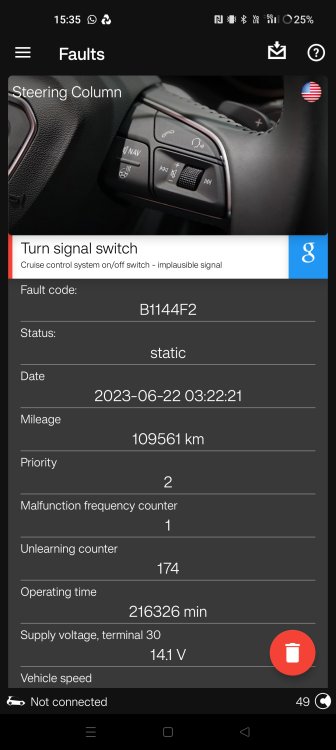

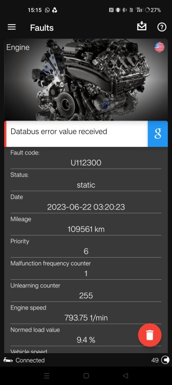

Really hoping someone can help with this. Recently had cruise control fitted by a company in Bristol who used to do this for Blade Skoda so know what they are doing. After struggling to get the car to accept the activation code, he finally got it all in, but I'm getting errors in Obdeleven. Screenshot attached.
As the stalks were from a breakers, he said the stalks are likely faulty and so I was obliged to pay the full fitting price.
I've since fitted a second set of stalks from a different breaker and getting the same errors. I've had help from the guru that is Sasha and am going to check the remote wire soon at her recommendation, but wanted to make this post incase someone had this exact issue and has a fix. I'm £350 in at this point and to have no working CC is a kick in the teeth.
Thanks in advance
This is resolved. The retrofitted ran the remote cable to an ECU pin instead of the TUIL connector. All good now
