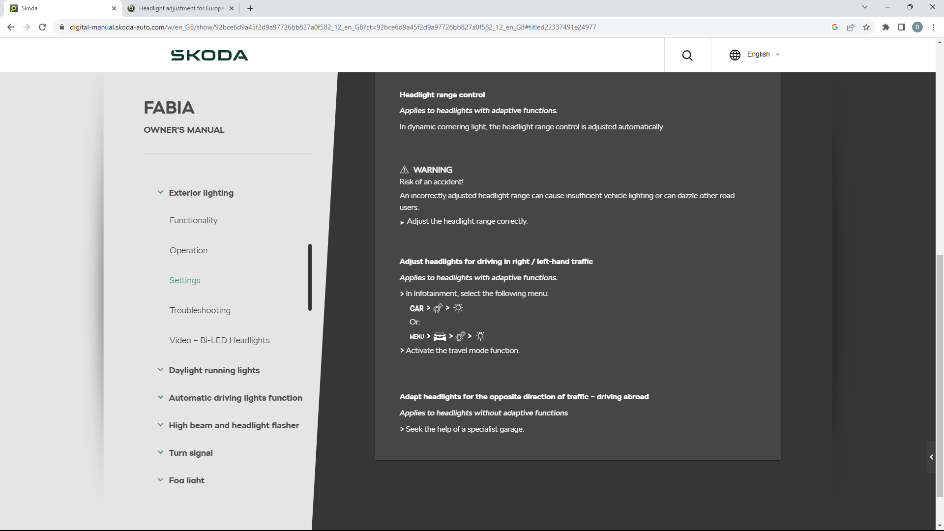

Just had a look in the owners manual and it states this function is only available in cars with headlights with adaptive functions.
Just checked in my two month old Monte Carlo and the setting is not there.
Checked the online configurator and it does not appear to be an option!
