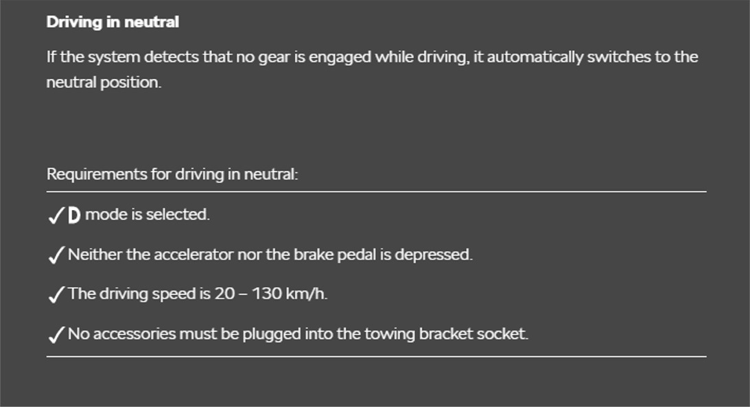

It shows D because you have 'Coasting' enabled and you are indeed 'coasting'.
The gears are disengaged until you touch the accelerator or brake pedal or the road is steep enough.
There must surely be a bit in the Owners Manual telling you.

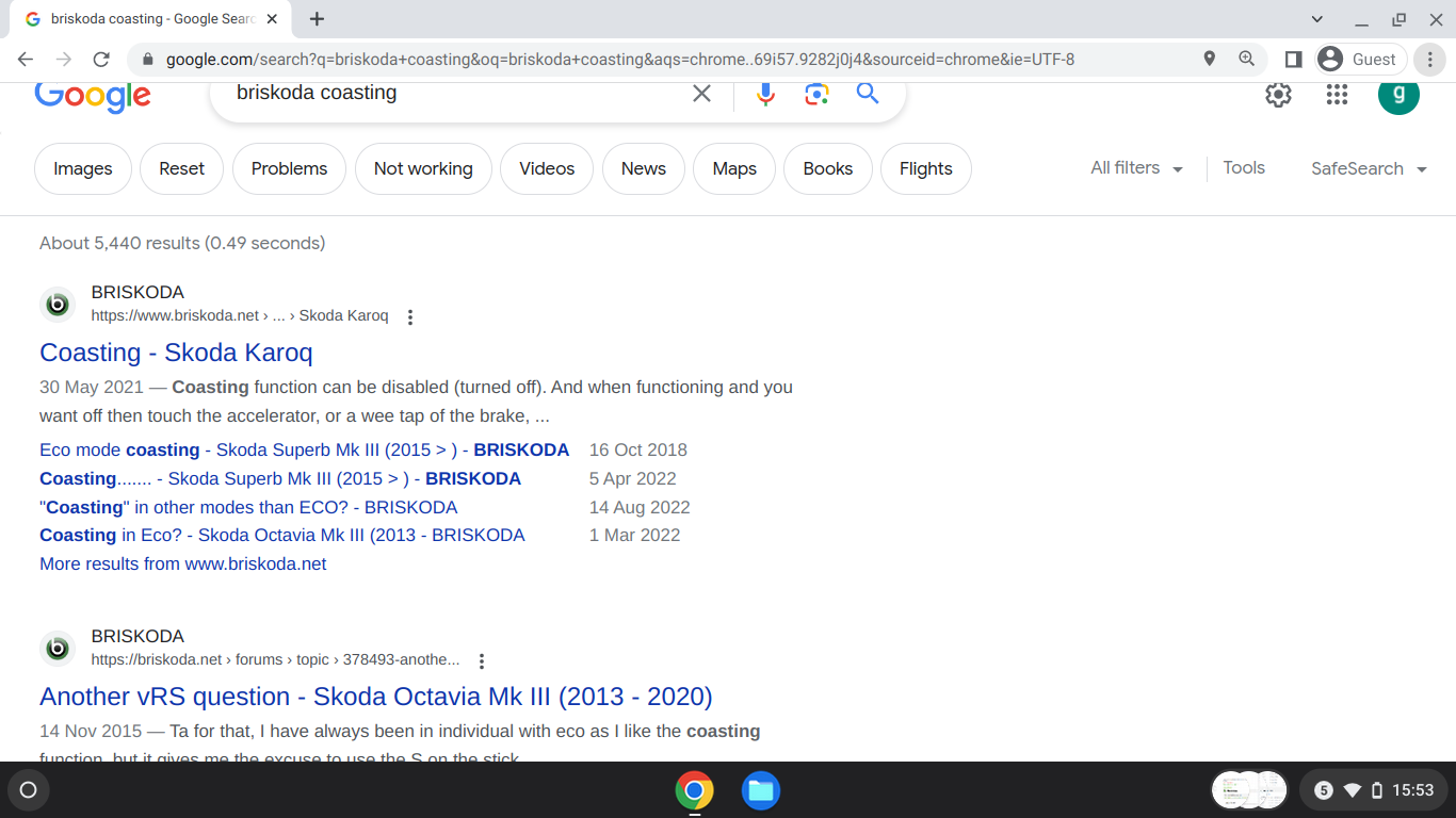

The driver is not selecting 'neutral'.     Plenty thread on 'Coasting' in Briskoda if you just search.  Cars used to not need to be in ECO, and some only did it in ECO.
Some used to have to have 'Coasting' ticked in the Maxidot.
Stuff evolved.
Does seem rather strange terminology!
To me, to drive effectively with "neither the accelerator nor the brake depressed" would only be possible with Cruise Control (which my trim level doesn't have).
So, in essence this "neutral" driving could only ever happen for extremely short distances.

Maybe look at the 'Coasting' threads in Briskoda in the other sections.
