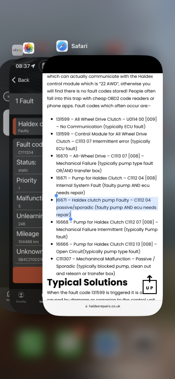

Had a skim through some of their documentation, didn’t come up when I googled the code because they spaced it C1112 04. Looks like I’m on the hook for a new pump and a repaired control unit!

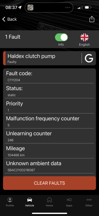

Hi! I'm new here, having just bought a 170hp 2014 4WD Yeti that currently has no rear wheel drive. I have bought Carista EVO, and this throws up a constant  C111204 (C1112 04, C111 204) fault code.  Mh96, did you find that your needed both ECU and pump? Does this fault code definitely mean this is the case? Wondering about ordering and fitting a new pump and hoping that cures it. Or might that create problems?
