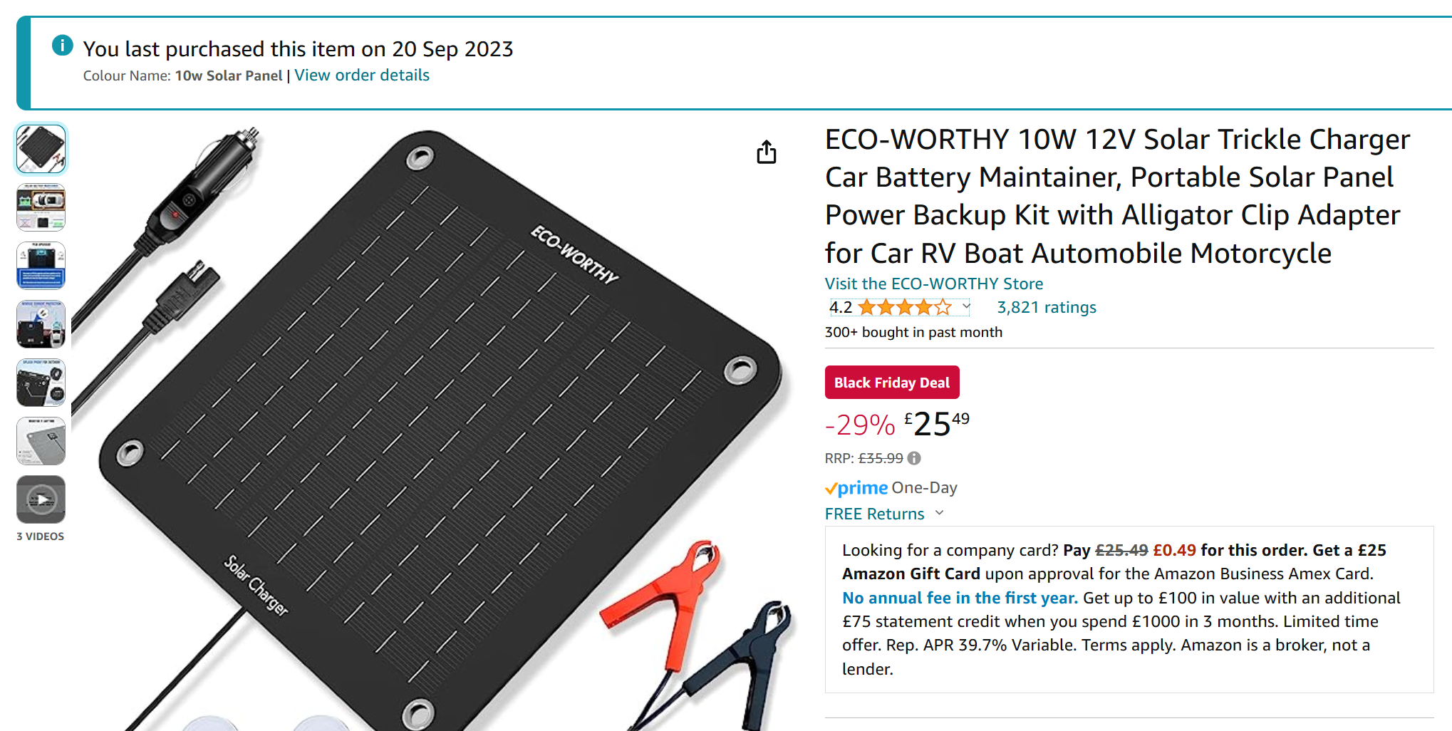

Yes, I have one.
It seems to have done very little to help the battery so far.
It knocks out about 17.5v unloaded even in quite cloudy weather, but volts don't mean much, current is what counts.
At night, it causes a slight current drain as the car powers the little red LED on the plug, which is illuminated by the 12v power from the car.
It's not really a fair test as I've only had it since September, but that's my experience of it.
I'll have to see what it can actually power in summer sunshine, as the panel itself seems reasonably well-made.
