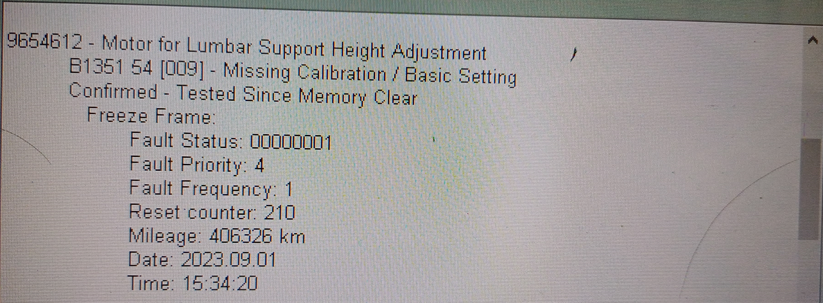

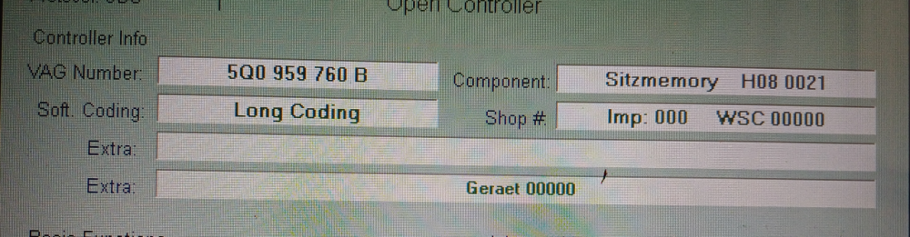

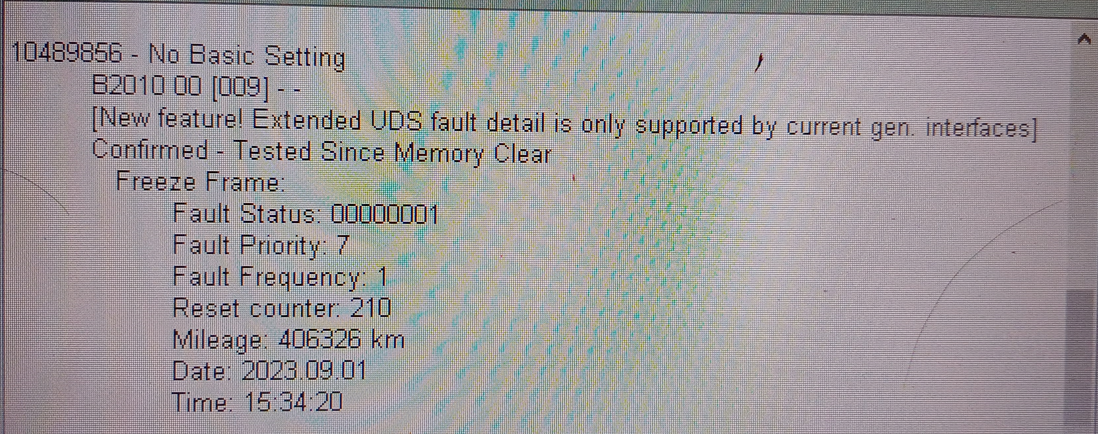

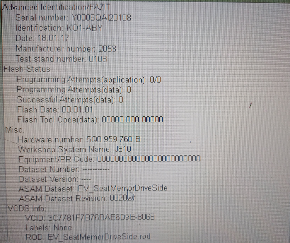

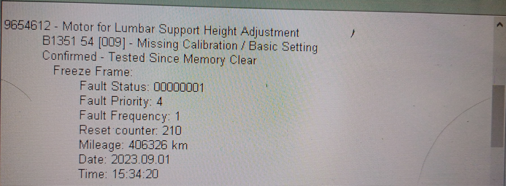

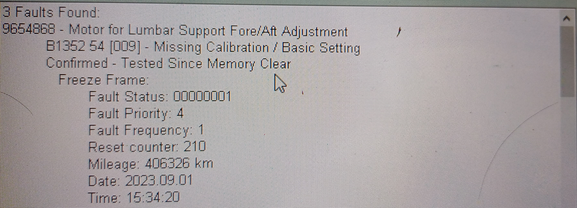

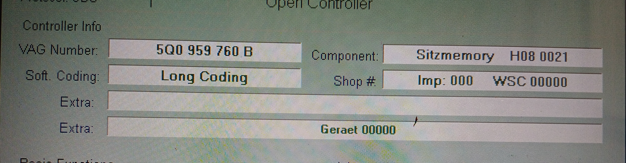

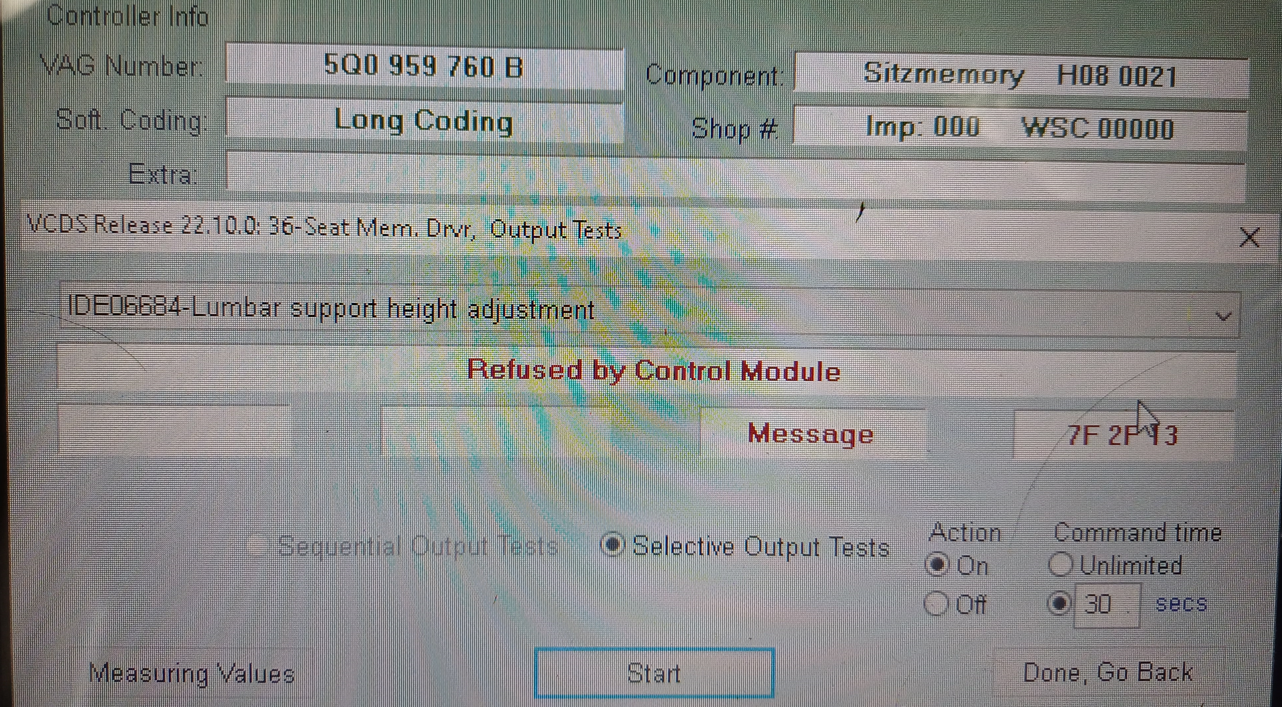

@langers2kWondering if you can help here.  When I got my car a couple of years ago the memory buttons for the seat worked fine.  One time when moving the seat all the way back to hover underneath they stopped working,  I followed the move forward, back, etc. and it reset.  Then a e while later the same thing happened and no matter the combination of forward, back, up, down, etc. nothing would reset it.  Using VCDS I ran the basic settings a number of times but nothing seems to get rid of the error codes.  I've taken some photos of VCDS to show what I get.
Error Code 1:
Error Code 2:
Error Code 3:
Module Info:
Advanced Info:
Thanks.
@MunsterScot - as per TPI 2049942/3 you likely need a firmware update for the seat controller to SW:0022 :)

My seat controller module was replaced under warranty, about 4-5 yrs ago.
They tried a software update, but that didn't fix it.  So the module was replaced with this:-
Software number: 5Q0959760C
Software version: 0024
Hardware number: 5Q0959760C
Hardware version: H09
Before replacement, it was this:-
Software number: 5Q0959760B
Software version: 0021
Hardware number: 5Q0959760B
Hardware version: H08
