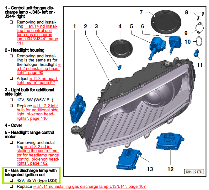

Headlights (drivers light??)

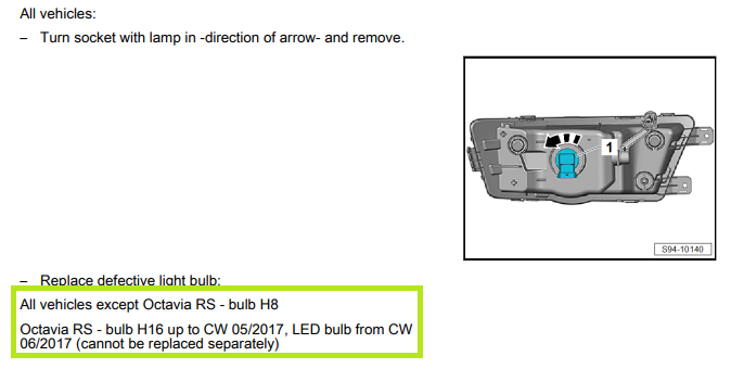

Fogs:

As above, they are H16 bulbs.

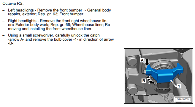

The official method is to remove the front bumper or wheel liner:
However, I think they are relatively accessible if you drop the undertray.
Some folk also remove the grill from under the fog for access:

Do I read this right you have to remove front bumper or wheel arch liner to replace fog light bulb, bit excessive isn't it
