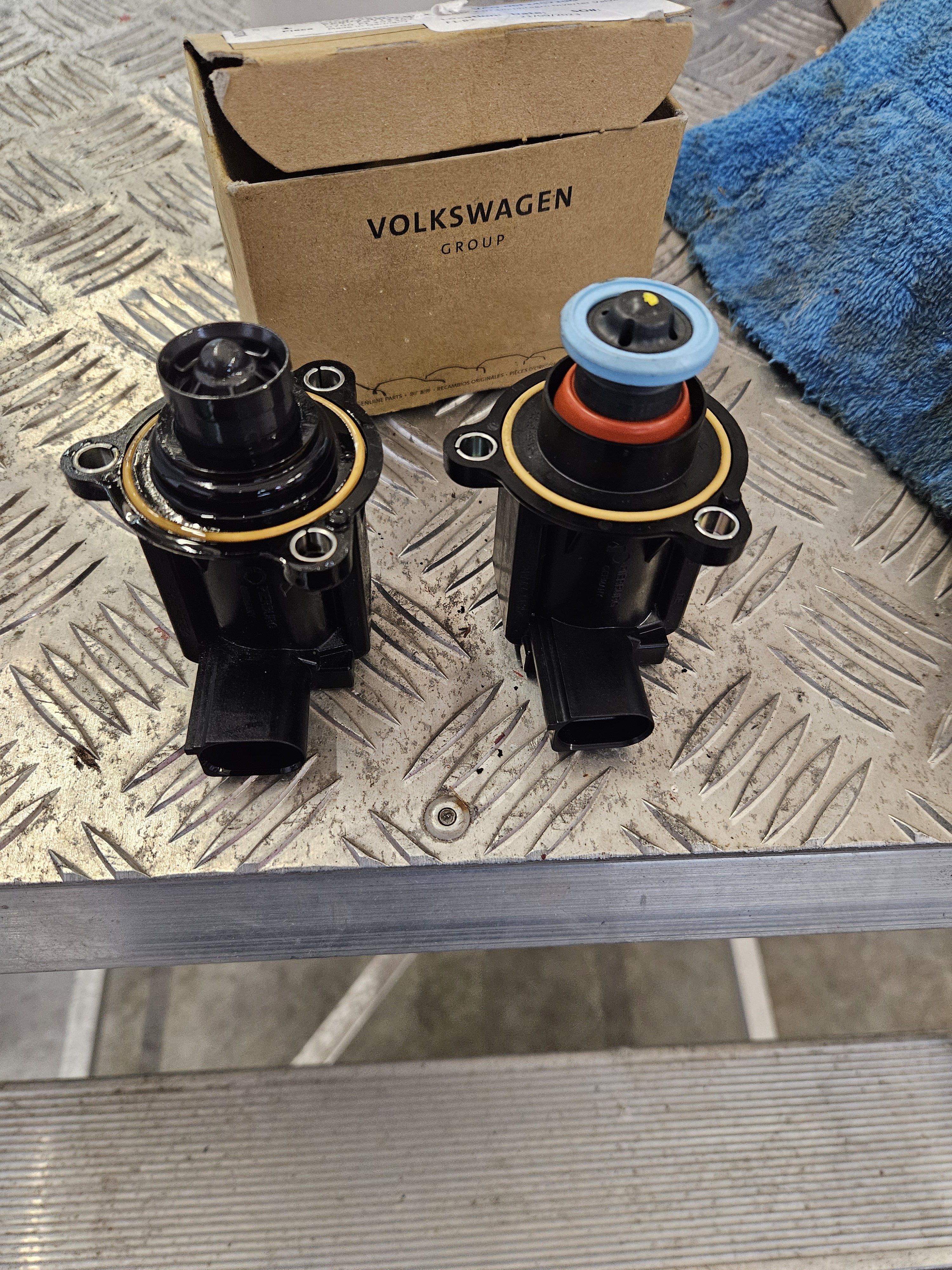

20231021_092623.thumb.jpg.bc7410f457bc60a9f05007914b7ceda4.jpgGood morning.
I have just spent far too long under the car changing the DV, the old one was a 'C', new one is a 'G' revision, old piston, new is the diaphragm one.
I bought it from the good folks at Awesome GTI and was advised that the piston type was liable to leak with my engine and the G will hold boost better.
I will take her out later for a blast and see if it feels better at high revs, will report back if anyone is interested.
I got to the DV from under the car, the third bolt was a pain but patience, tea, and perseverance paid off.
Was nice to check the boost pipes whilst down there also.

Hi, standard DV, no noise from this one at all. You can read about them on the Go Faster Bits website. I think I had a slight leak before.
Was the one you took out the piston or diaphragm type?
Will see if they do a 2.0 tsi one, I always like a plan b!
My revision G one holds boost better than the old one, also think I had a leak.
