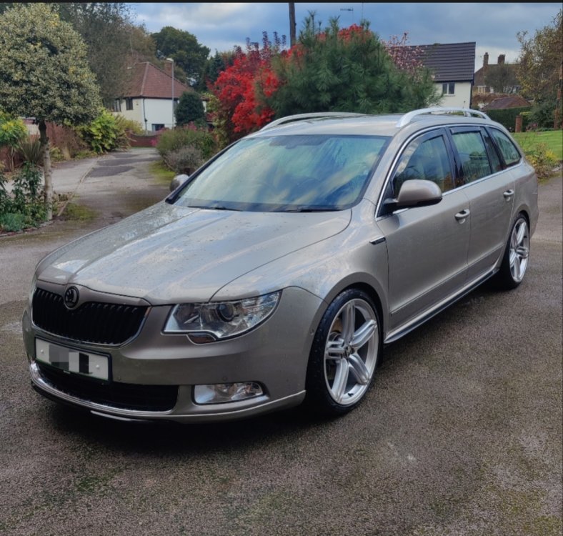

  11. I've seen these in 18,19 and 20" now, I think the Audi Q5 had some version of them, I've put 235/35/19 tyres, speedo is pretty much the same as before.
  12. Yes,I didn't realise you were so far North, or you could have borrowed my spare set of Thermistos. I've put RS6 alloys on mine as they are 19" so not too hard. Needed 10mm hub centric spacers all round though for clearance. They look like they were designed for the 3T as the width of each "spoke" is the same as the chrome door strip and lower tailgate strip and they line up almost perfectly too.
