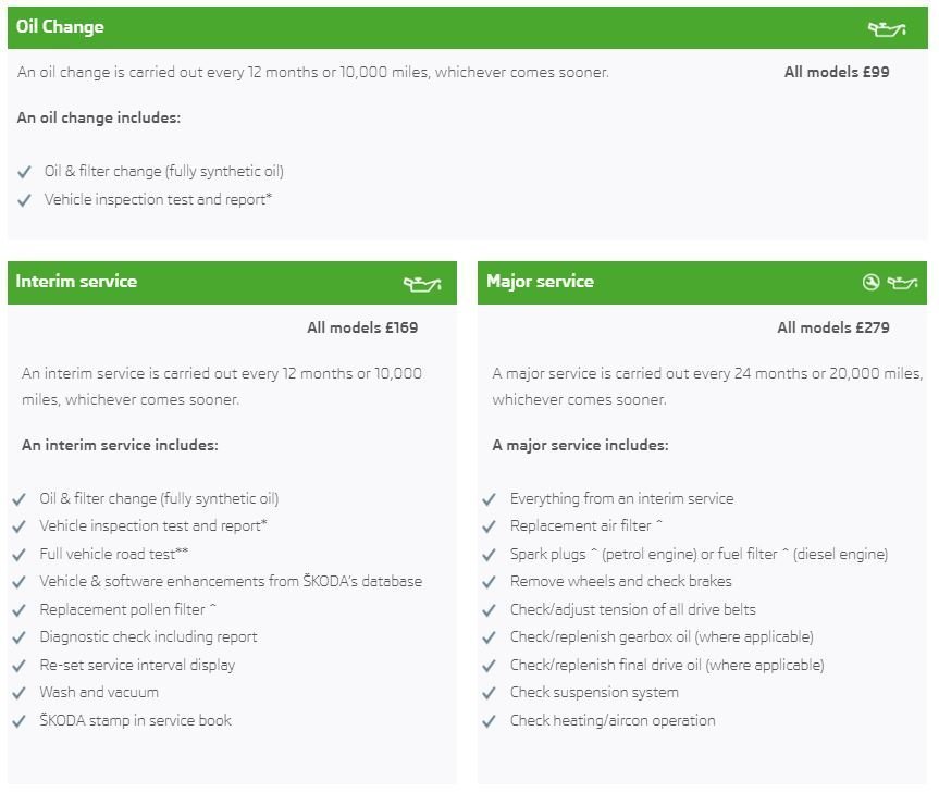

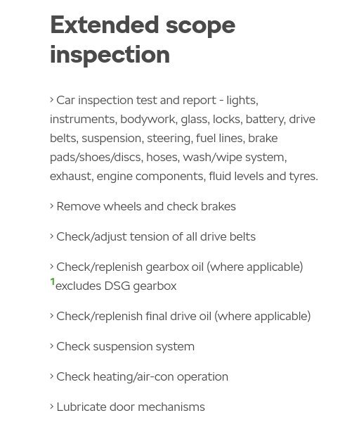

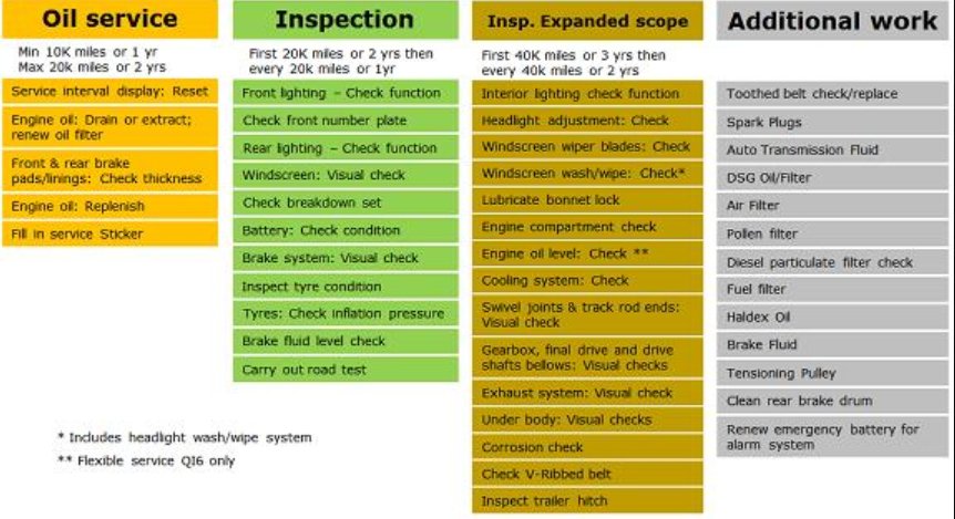

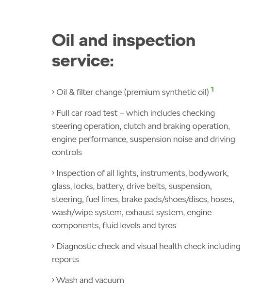

What service history have you and when was stuff done last?

Was you car ever part of the Recall Action to have the coolant replaced?
Pinned thread at the top of the Fabia Mk3 section.
1039190636_Screenshot2021-09-29at07_53_36.jpg.994d2b104123865330d493df0f73629e.jpg.469b173dd8ff2b7c1980f902f406fe61.jpg
1025295341_Screenshot2021-09-29at07_53_17.jpg.f3e4a6dc63cb89105f9b1ac440bb1614.jpg.1a83aff70ed152245067b78901bec0e3.jpg
827614452_SkodaFixedPriceServicing.JPG.3dbea7606c029076ed94e2f0216199b6.jpeg.689c25a185d90e4e44889f342770023b.jpeg
