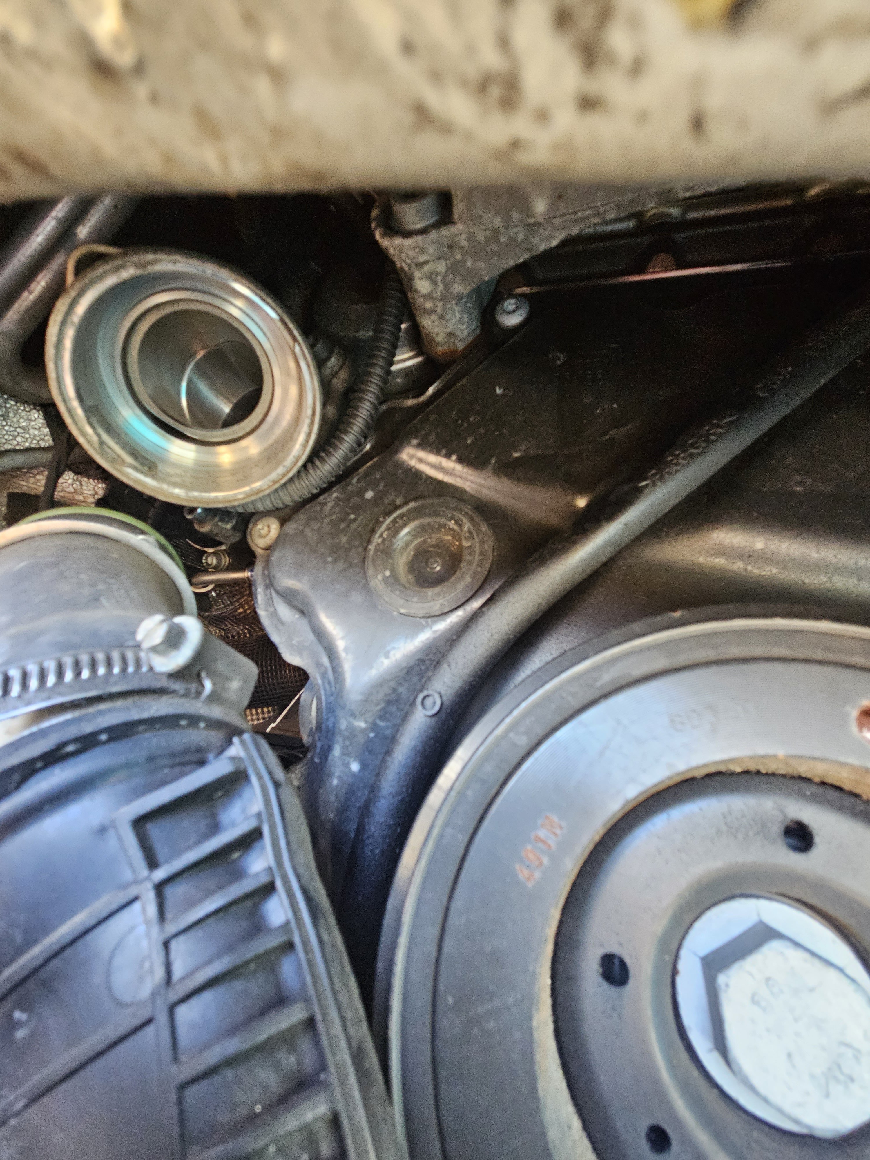

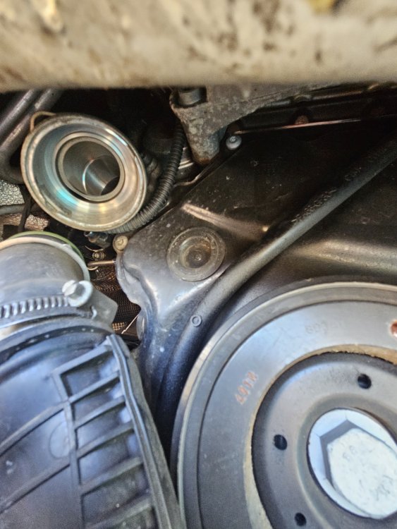

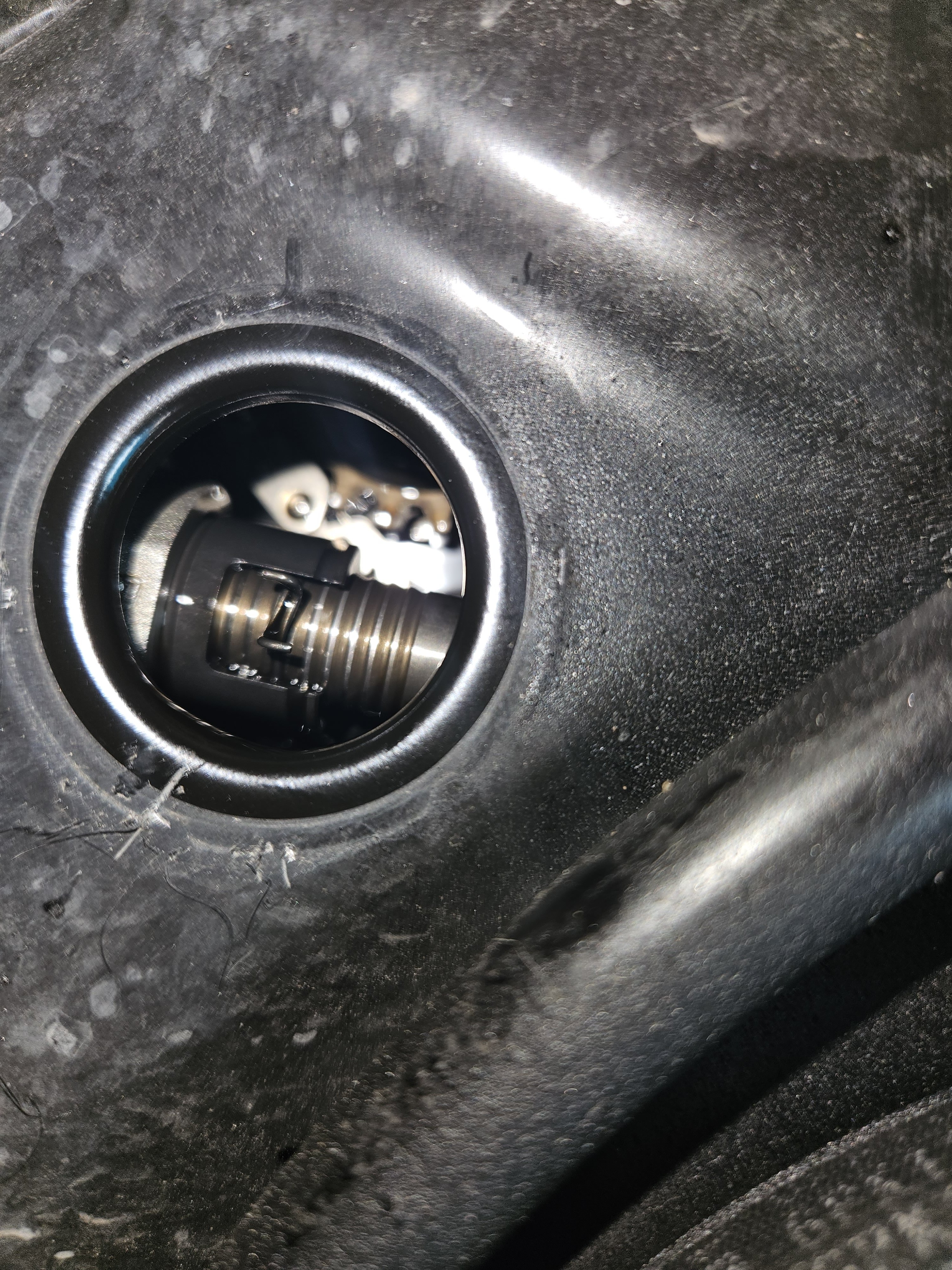

As a 2012 2.0 tsi I thought I would have a check on what revision I am running, the scaremongering has got the better of me.
Quite an easy Job to have a look, please see pics.
If anybody else is going to do it, give me a shout if you need any tips.
I have a spare bung now if anyone wants it. The old one popped back in nae bother. Very hard plastic.
Looks like I am not running the original one with the issue thank goodness. 20231111_123808.thumb.jpg.07f3ba4f6ba8f7925ff2d0466801d09b.jpg

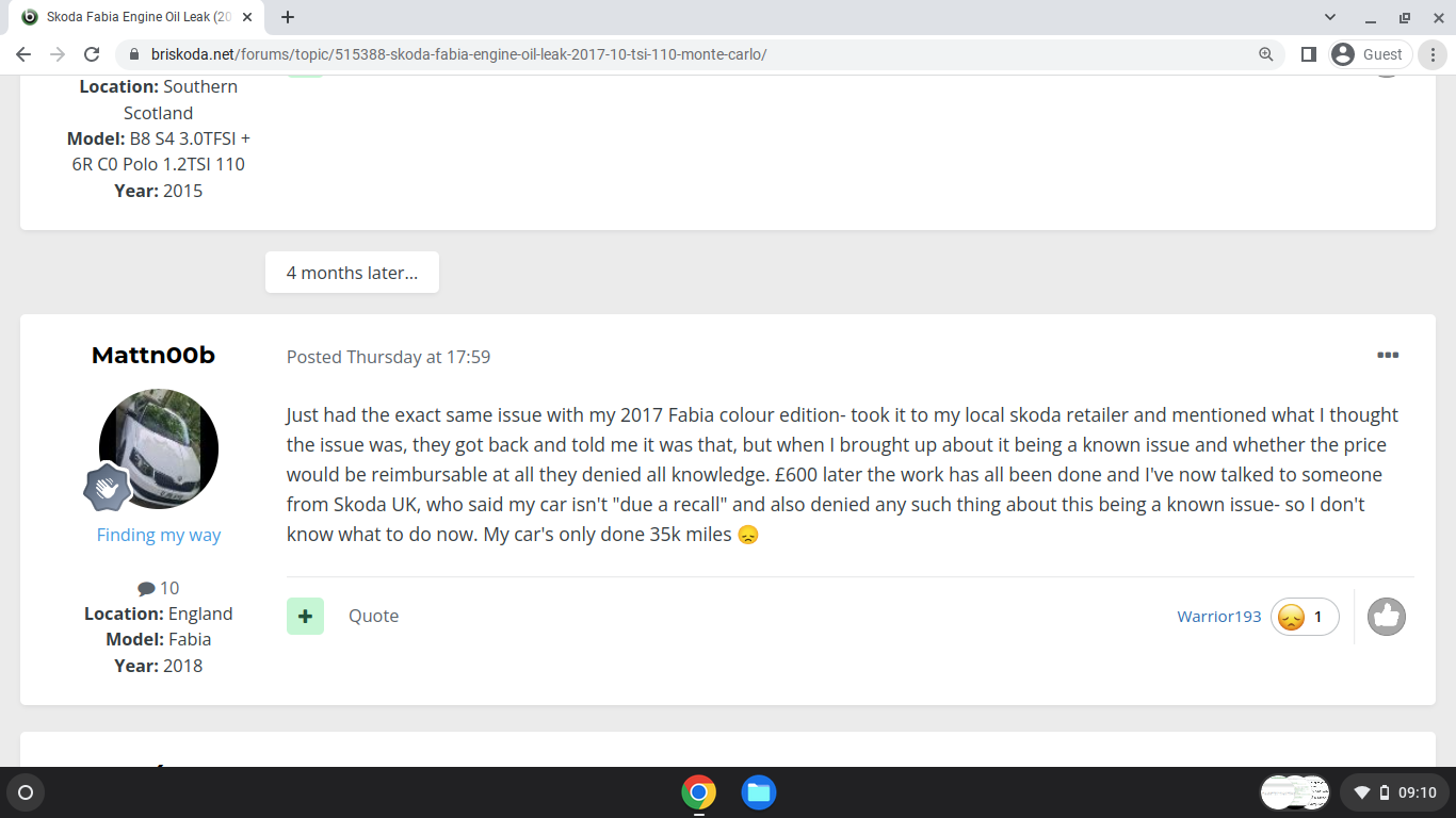

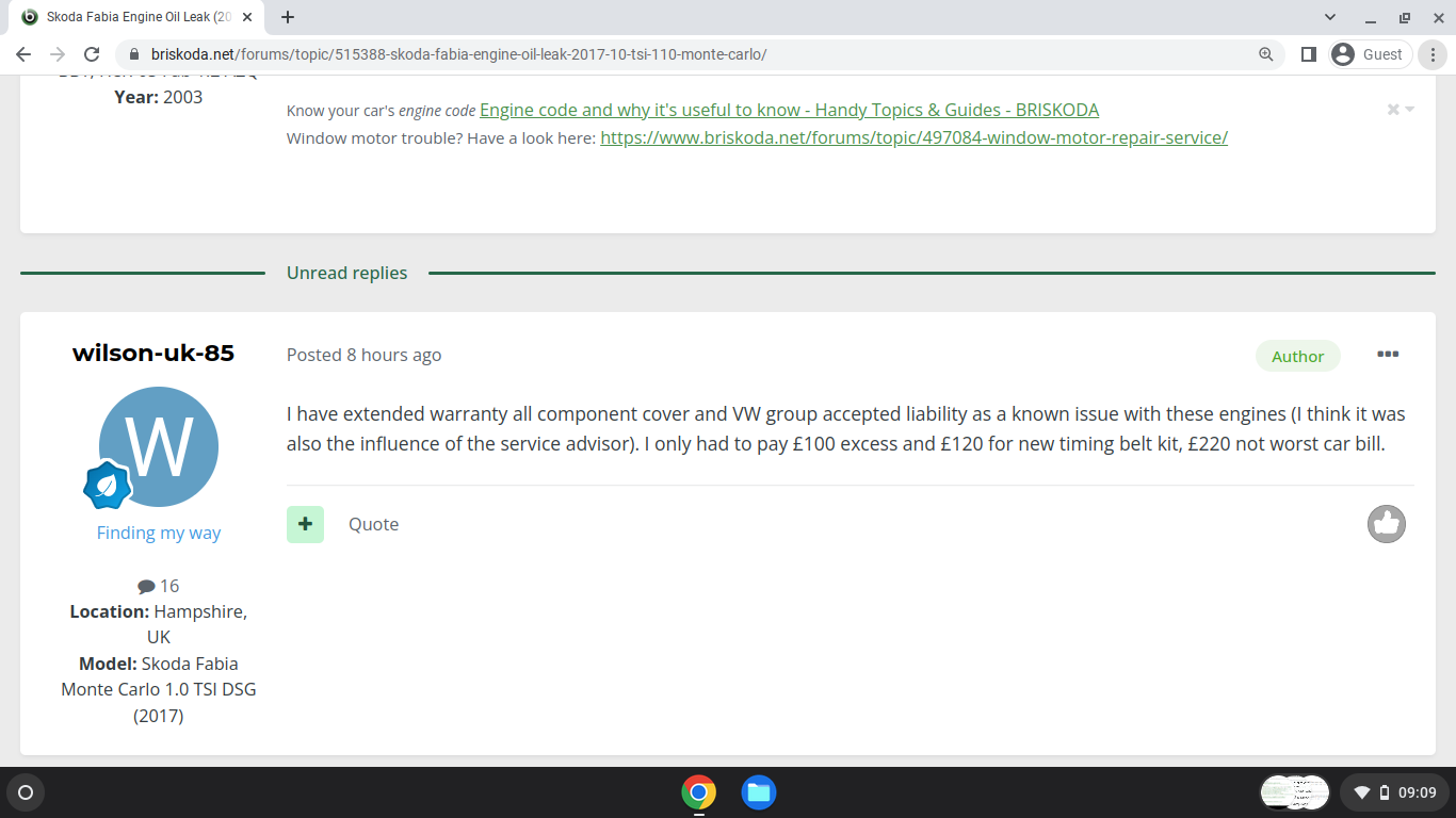

@andrehjThat was a good price then 9 years ago.
This is the sort of costs more recently with 1.0 TSI,s.
