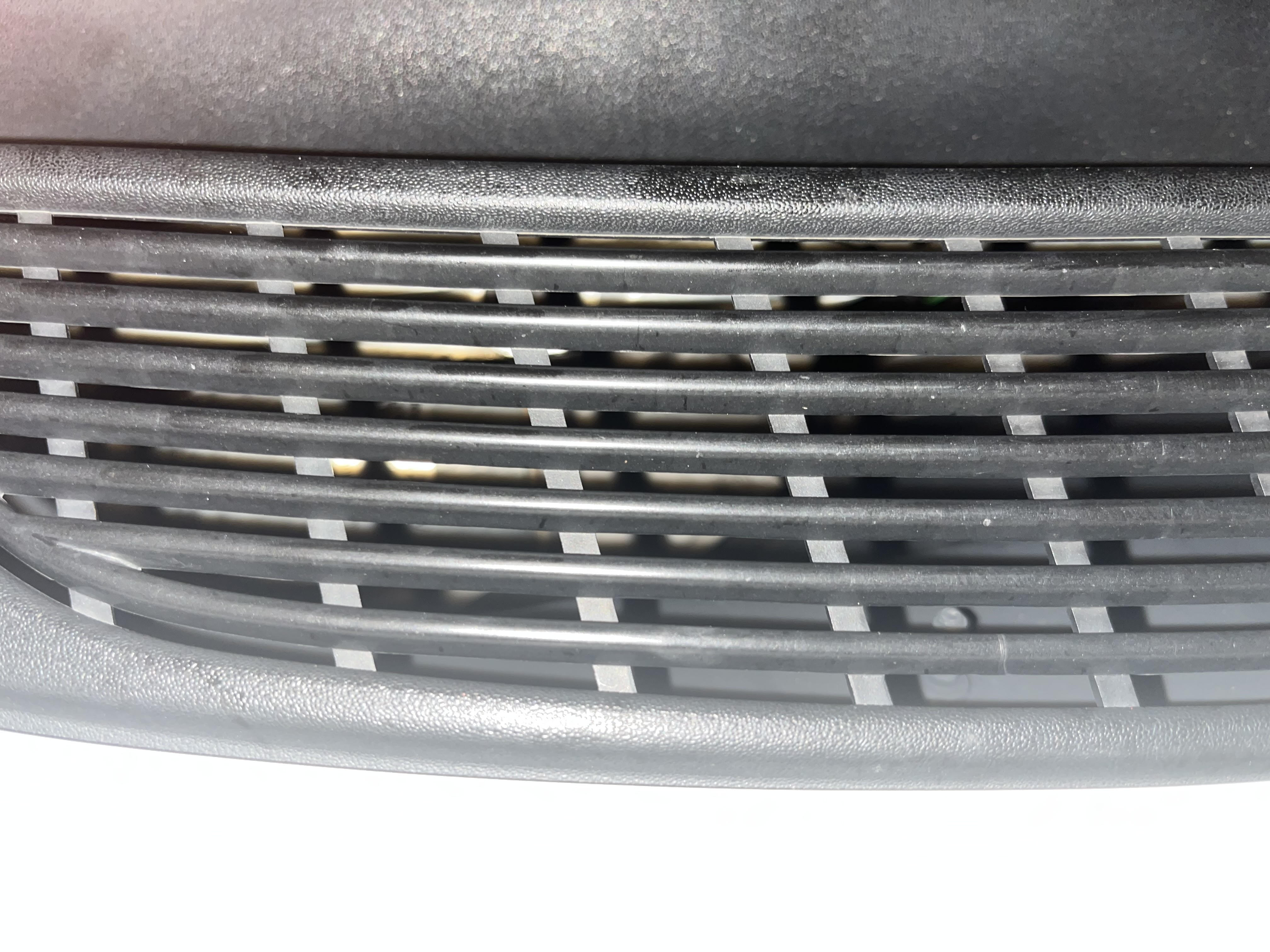

The DRIVERS side on a RHD car has NO cover, you can see the wiper motor / linkage
Above is Drivers side (RHD), apologies photo was taken in pitch dark at  23:00 hrs......motor clearly visible

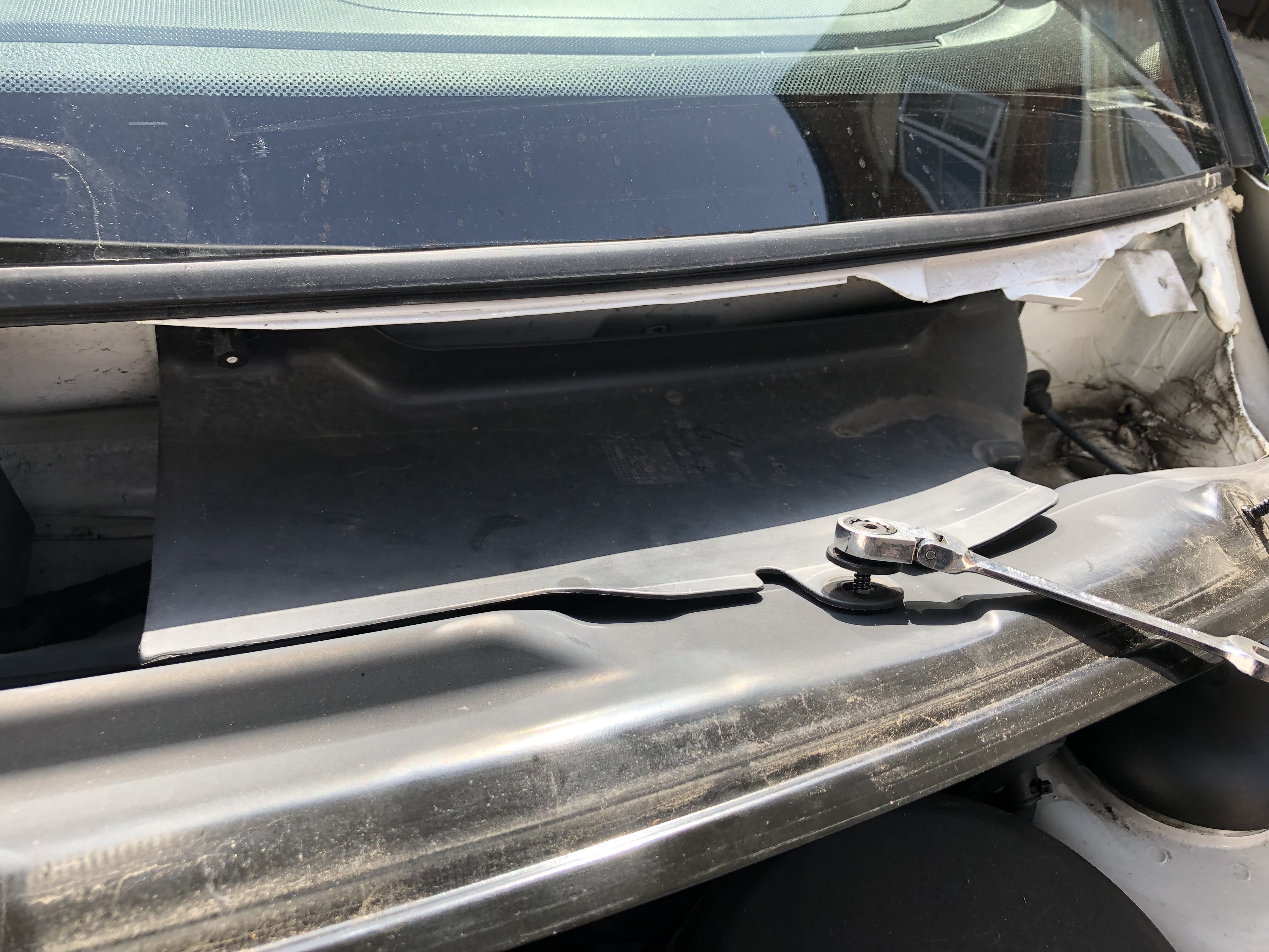

On the PASSENGER side of a UK car, thats where your intake valve is for your heater, so that has an additional cover under the grille to stop water directly going into the heater assy.
Image below showing cover which you see through the grille.......this is on the LH side of a RHD car, this cover would be on RH side of a LHD car.

It is the same for LHD cars: the drivers side has no cover and on the passenger side the cover is present.
Everything is clear now, the car is not missing any parts.
