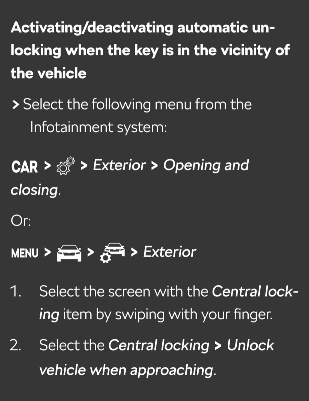

Yep, I've had this problem recently, although it has also occurred on warmer days too, seems very hit and miss. Although I have my car unlock with proximity unlocking.

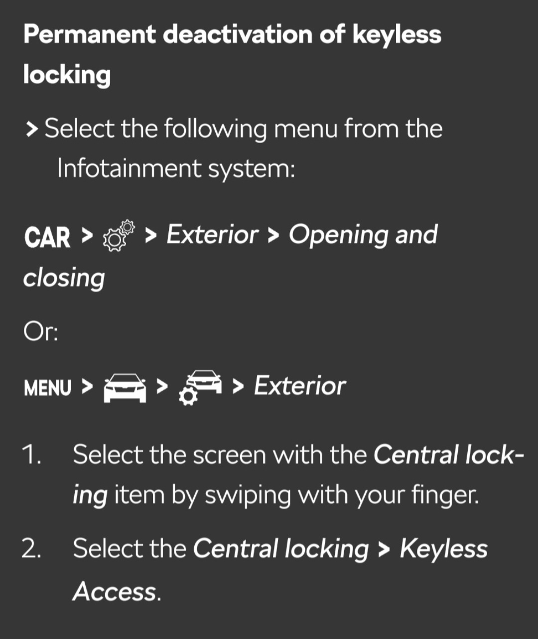

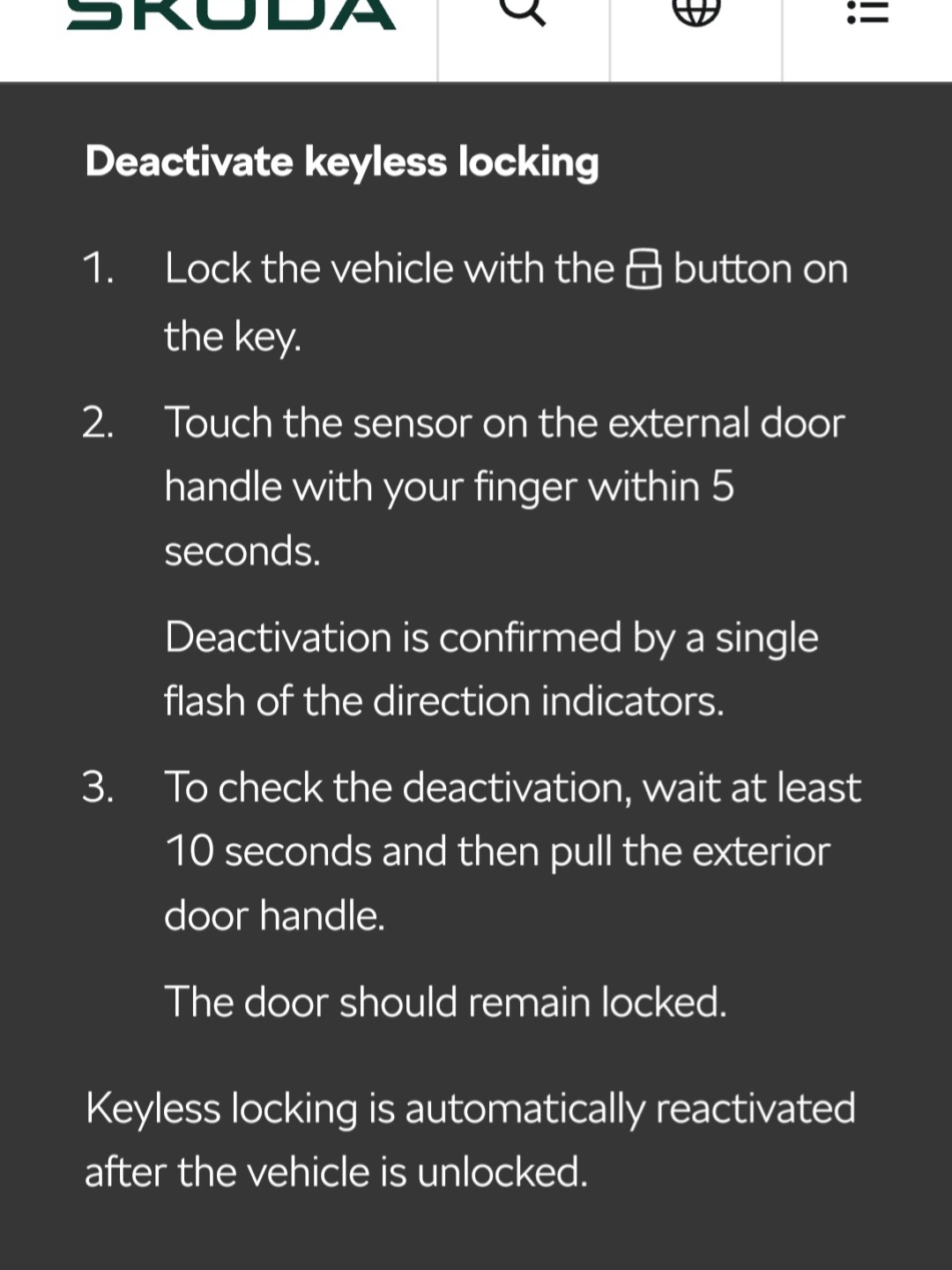

Something I've been trying to turn off, but can't find the option!
Hope this helps. I believe it's the last instruction
Thanks very much 😊
