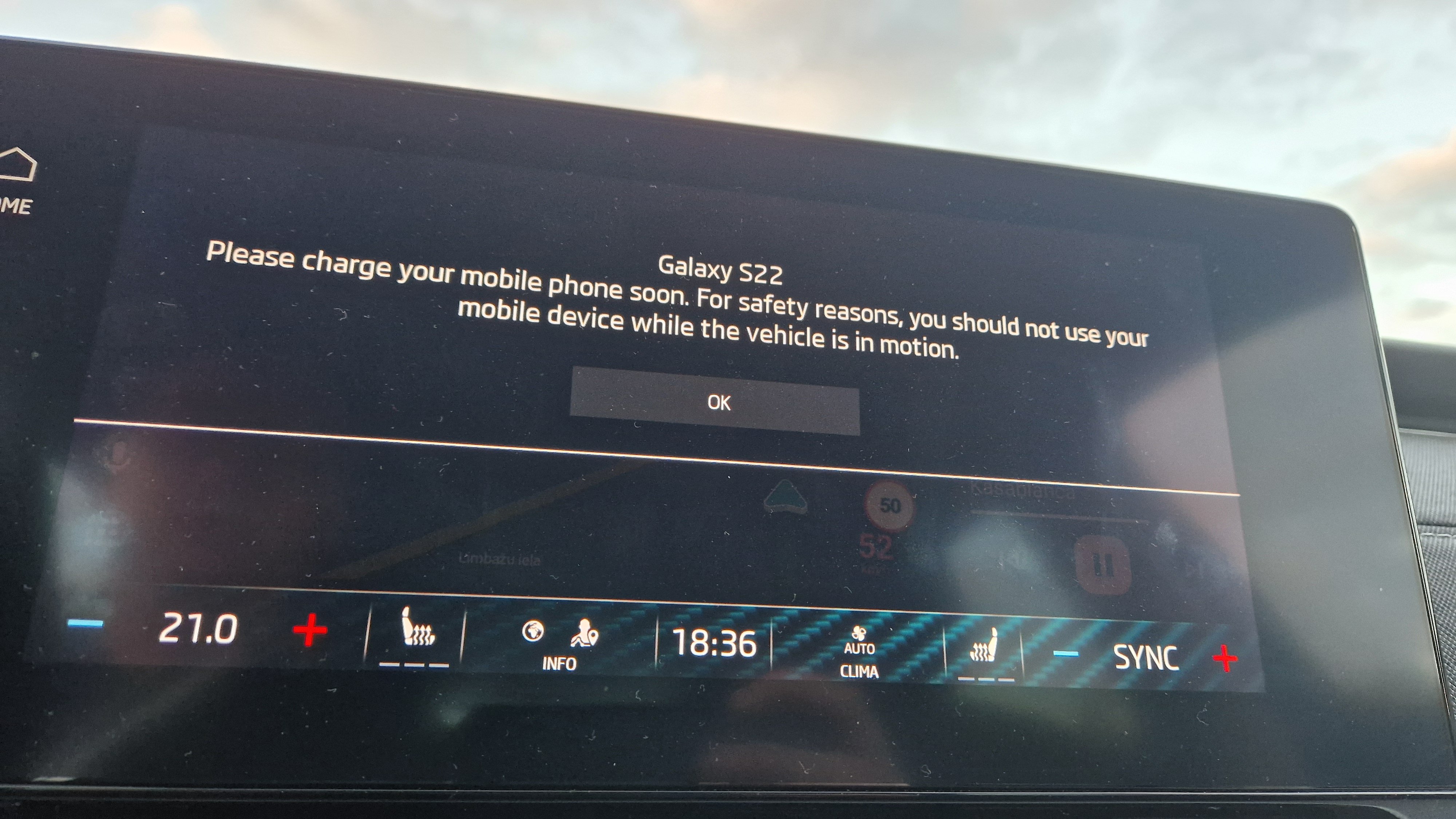

  4. yes I tested it today, turned off the battery saver, and the unnecessary statement doesn't appear. AA 15.2.653614
  5. Yes, this notification is really annoying, it appears after every cold START. I tried not to press ok, thinking that it would disappear by itself, no it didn't disappear for at least 15 minutes, until I got tired of it. Who should I report this software problem to, it's very annoying to have to poke at the screen every time!
