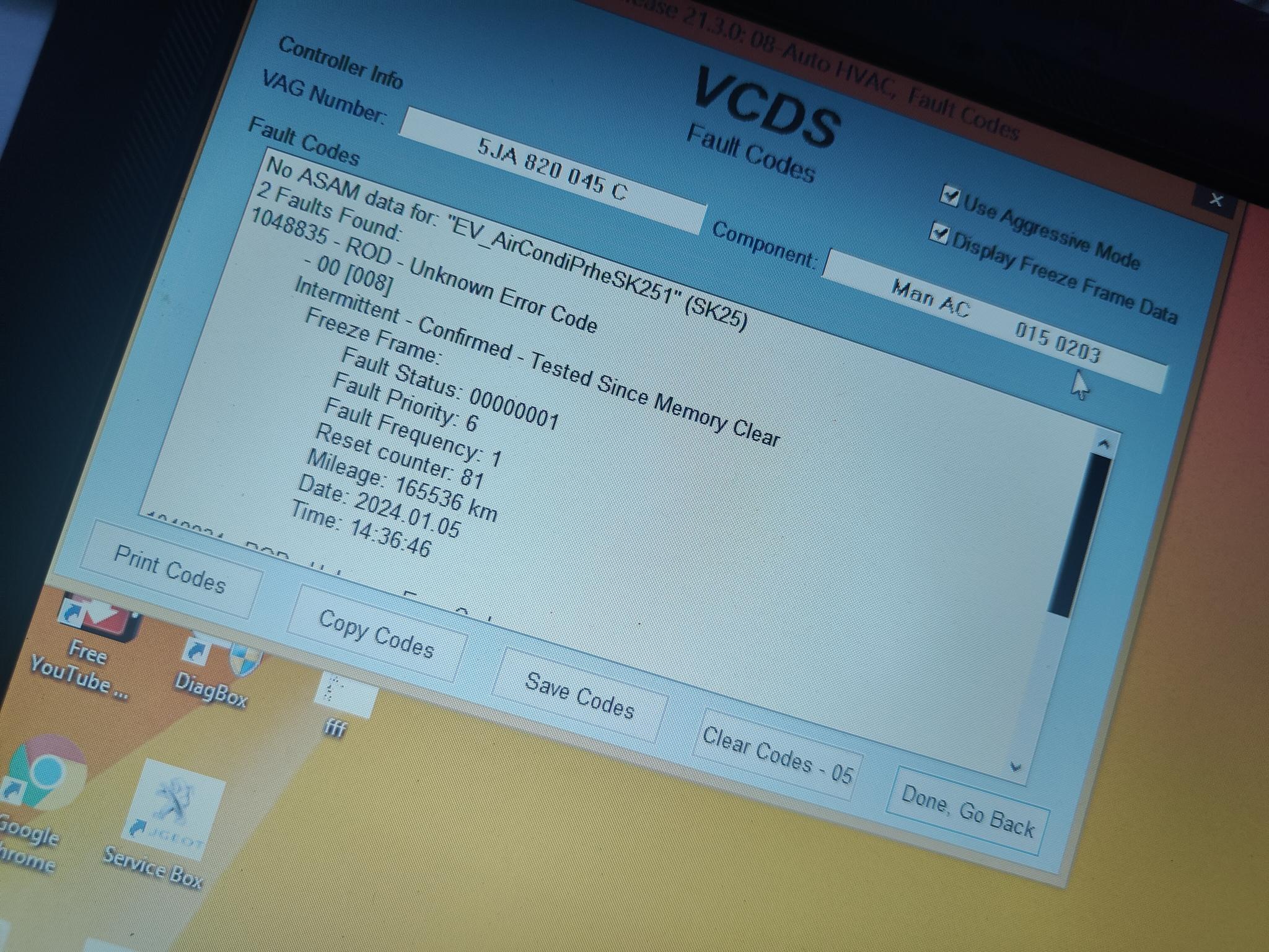

No engine is not overheating, its stable on 90 deg as dashboard says. I did scan and got this error.
Actually did not checked hose.

Do you use the aircon also whilst the heater is on?
