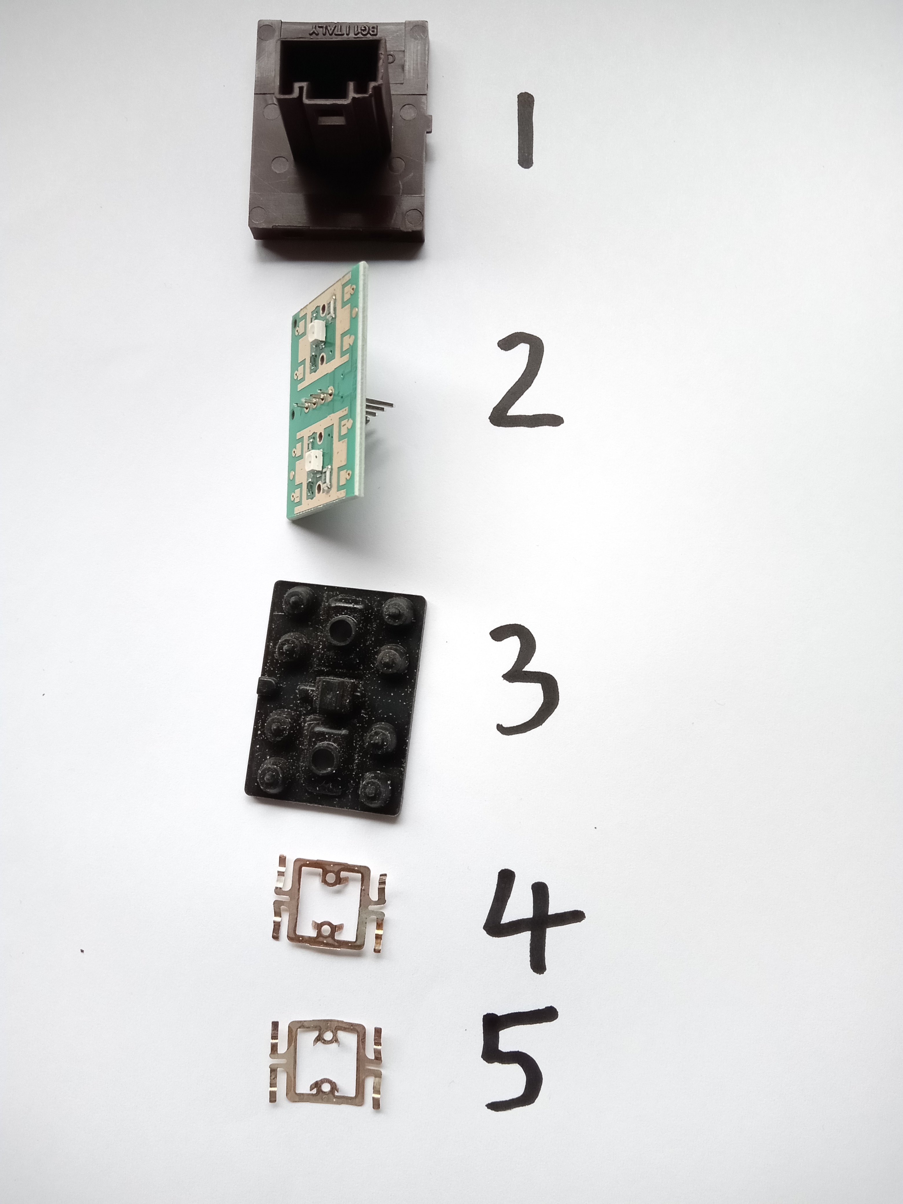

The driver's window on my Fabia Mark 1 dropped to the bottom of the door and I have managed to raise the window to the top of the door and temporarily secure it.
Unfortunately, when I unplugged the window electrical cable from the regulator (orange plug) I didn't unplug it properly and the 5 parts shown below came away from the regulator.
Does anyone have any idea how these 5 parts fit together?
I'd be very grateful for any help.
Thanks

The look like they should be parts of the front/rear window controls, from under the switch, the square brass things sitting on the greenish circuit board and the rubber pad on top. But then it needs to go into the switch assembly.
This might help: https://www.youtube.com/watch?v=mpAiCz8Ftgw
Edited by LesCM19
Les
Thanks very much for your help. I'd almost given up finding an answer to my problem!
The video is very detailed and I'll be having another go at putting the switch back together.
Thanks again.
Mine did the same. The small screws that held the switch together had failed. I glued it back together but bought a replacement off amazon which wasn't expensive. Think it was around a tenner.
