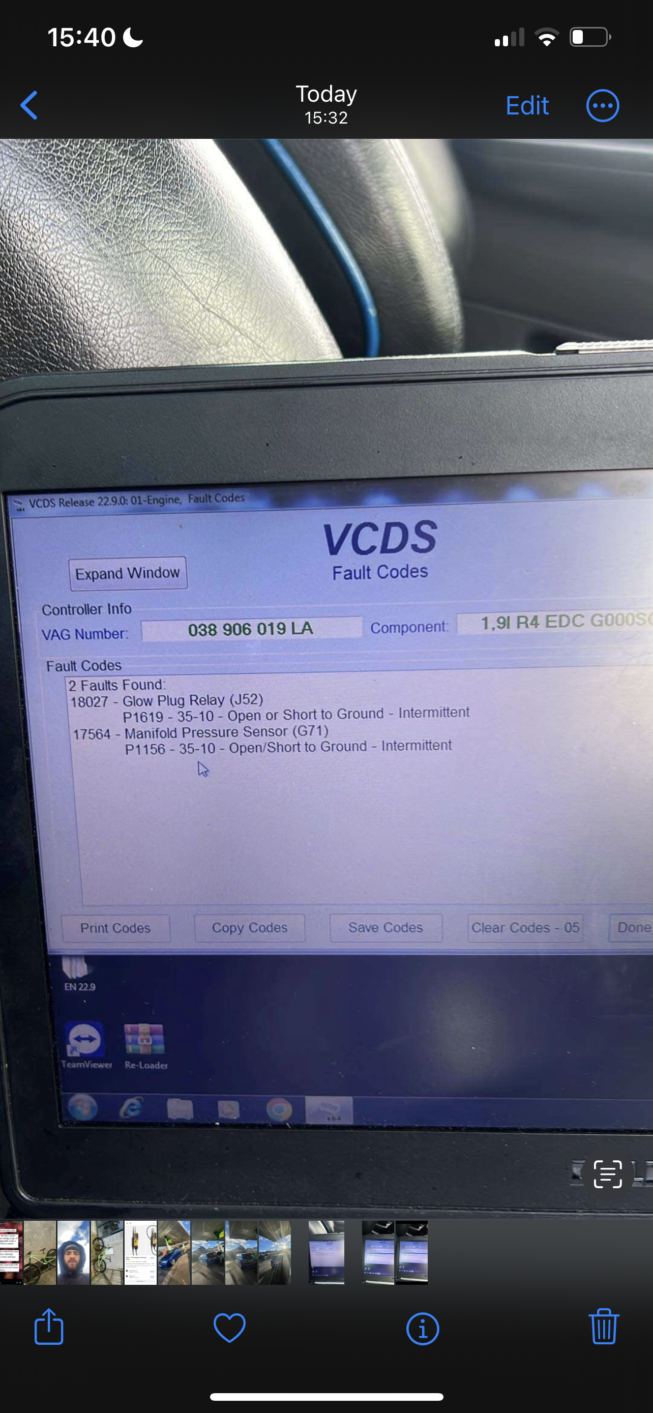

I have an issue the car isn’t boosting well and the revs seem to jam at 4k when I put toe down then I have to let the revs come down to around 2.5k for the throttle to be responsive again. If I feather the throttle it will go all the way round.
When I had 1756 the car was fine however I took gearbox off and it split two wires ( shown in image ) and currently connector blocked them could this be causing the open circuit? Car also dies quite quickly when left say a couple days. Check map sensor also I have swapped with a working one the wires look okay.
