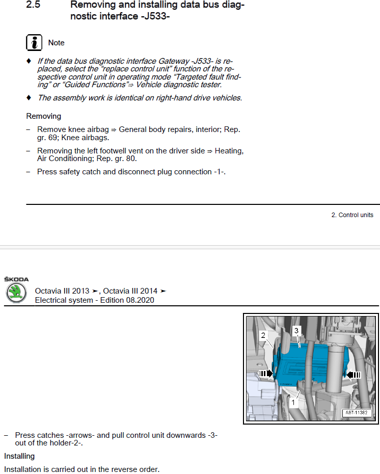

I need some help to remove my existing gateway to high gateway compatible with virtual cockpit. I was able to locate the part which is just behind steering column. However its placed at very awkward location that I wonder how do i remove it 😞! Any advice would be deeply appreciated.
Might be worth grabbing a workshop manual for your Superb.
Example page for removing the CAN-gateway on a similar Octavia:
