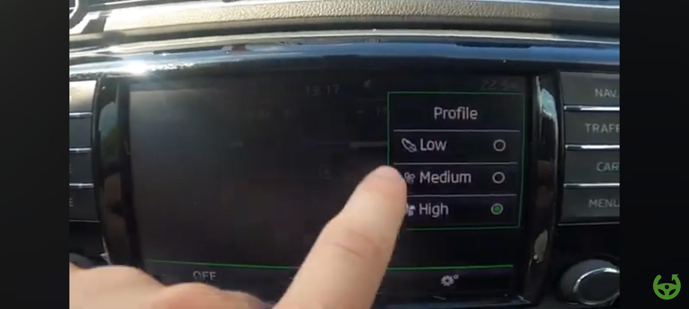

  6. Any way to fix the AC PROFILE settings lost after MIB 2.5 upgrade with 9.2 screen and VC. AC PROFILE MENU under climate control menu had 3 settings low medium high. This option is gone after this retrofit.

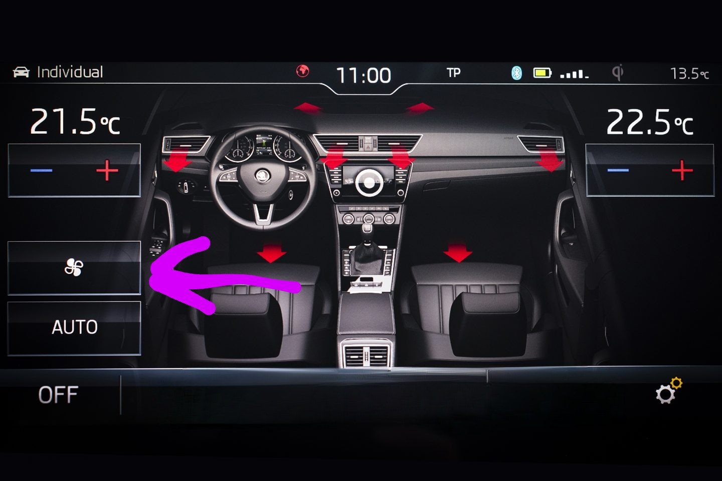

  7. Hi did you check if the AC profile option to adjust the intensity of air flow, low mid high still present after mib and VC retrofit. When we press the menu button on the climate control module there is a fan button that appears on the mib, which has sub menus low mid high!

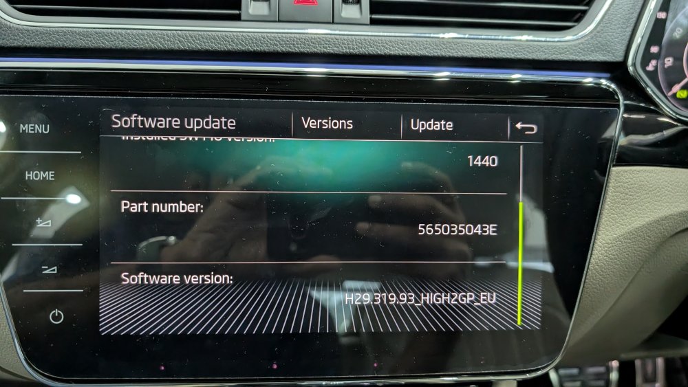

  10. After upgrading to MIB 2.5 and virtual cockpit, I lost the AC profile option ( Low , medium,high). When pressing AC menu, that option is missing. Also reverse camera multiple views. Also ambient light and VC color change according to drive mode change doesn't work. BCM and gateway was upgraded to the below. BCM:- 5Q0 937 084 DD GATEWAY:- 3Q0 907 530 L Please anyone help me to fix it.

  12. I have columbus mib 2.5 upgrade from Bolero.
