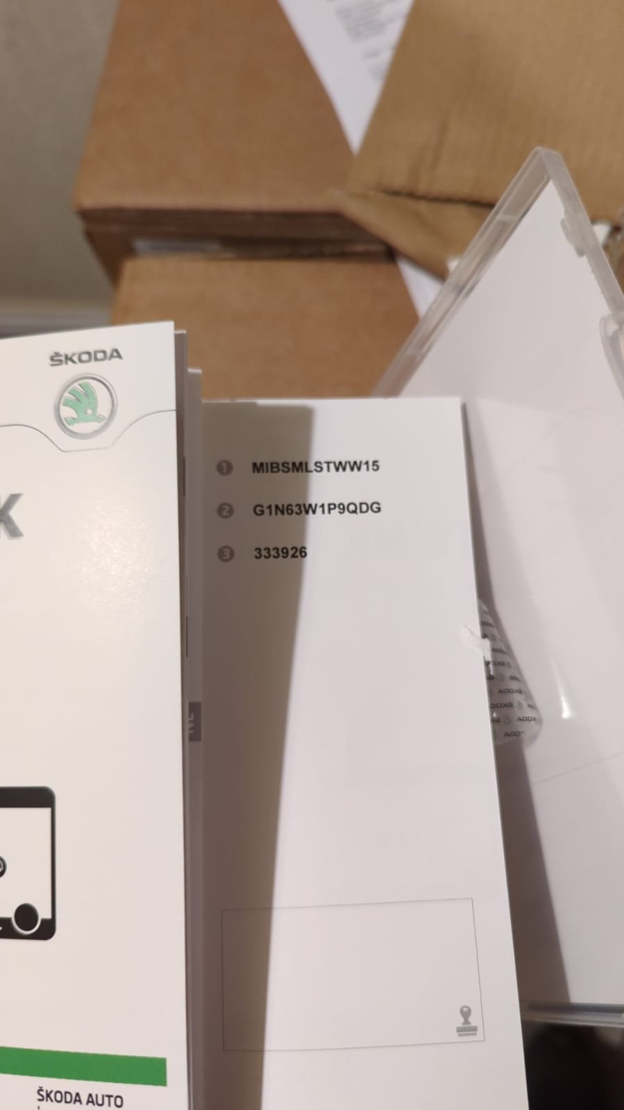

The dealer buys an activation kit from Skoda, which I believe is 000054830A. That will contain an activation code and instructions how to use ODIS with an online connection to enable Smartlink against that vehicles VIN.
This means that if in future the headunit is replaced, Smartlink will remain activated on the new unit as the VIN has the right entitlement :)

Sure mate, was planning to. I've ordered so hoping it will arrive tomorrow and I can let you know how it goes.
