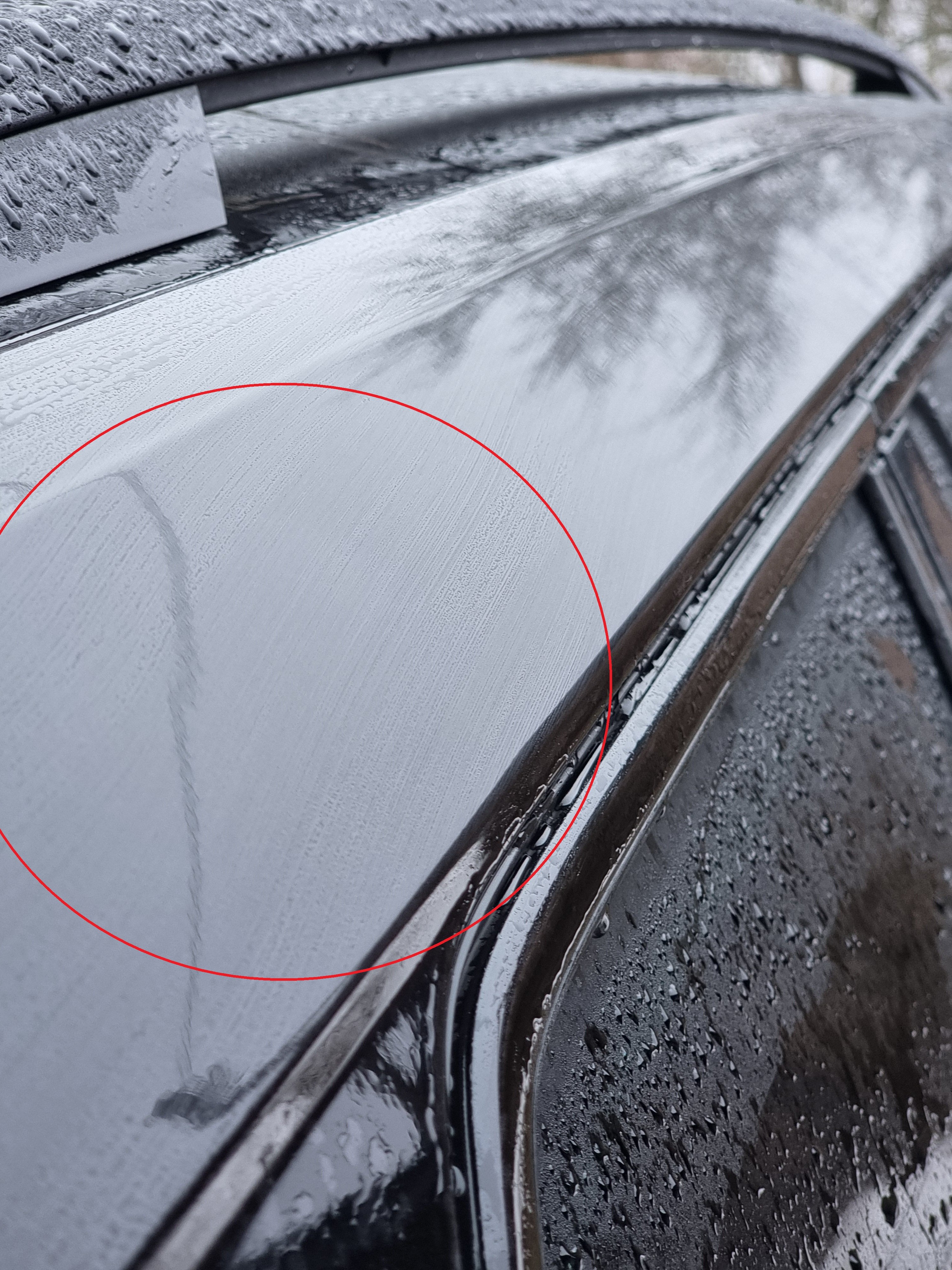

Some years ago loaded floor tiles into trunk, maybe 600 kg or something. New car. Drove to country house. At some point heard strange crack from the back.
When arrived, discovered dents on both sides of the roof. The boot has moved and bent the body.

I loaded all the stuff to boot, behind the rear axle.

Not all of it, the back seats were folded as the tiles were 1200 cm long, but most of the weight was obviously in the boot. Didn`t expect it, as my previous Mondeo wagon took such a load without issues.
