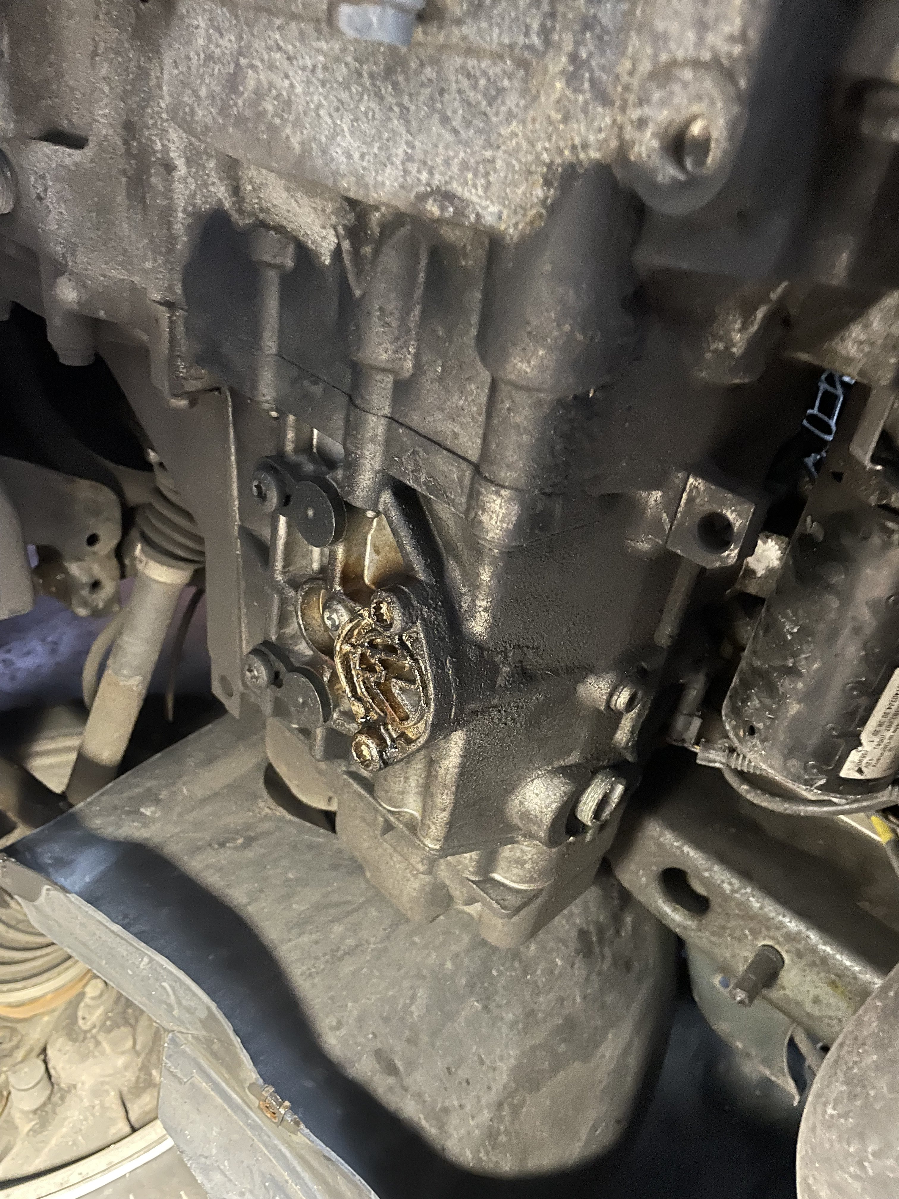

I noticed when under the car at the weekend there’s a small oil leak from the gearbox (manual 6 speed).
It coming from a small plate on the very bottom of the box held by a couple of bolts and the plate seems to have ‘VW’ shaped into it. I can’t find anything online referring to this plate as I thought it might be a drain plug but unsure.
Anyone any ideas what it’s called or its purpose? I’ll get a photo at weekend if people are unsure. Thanks.

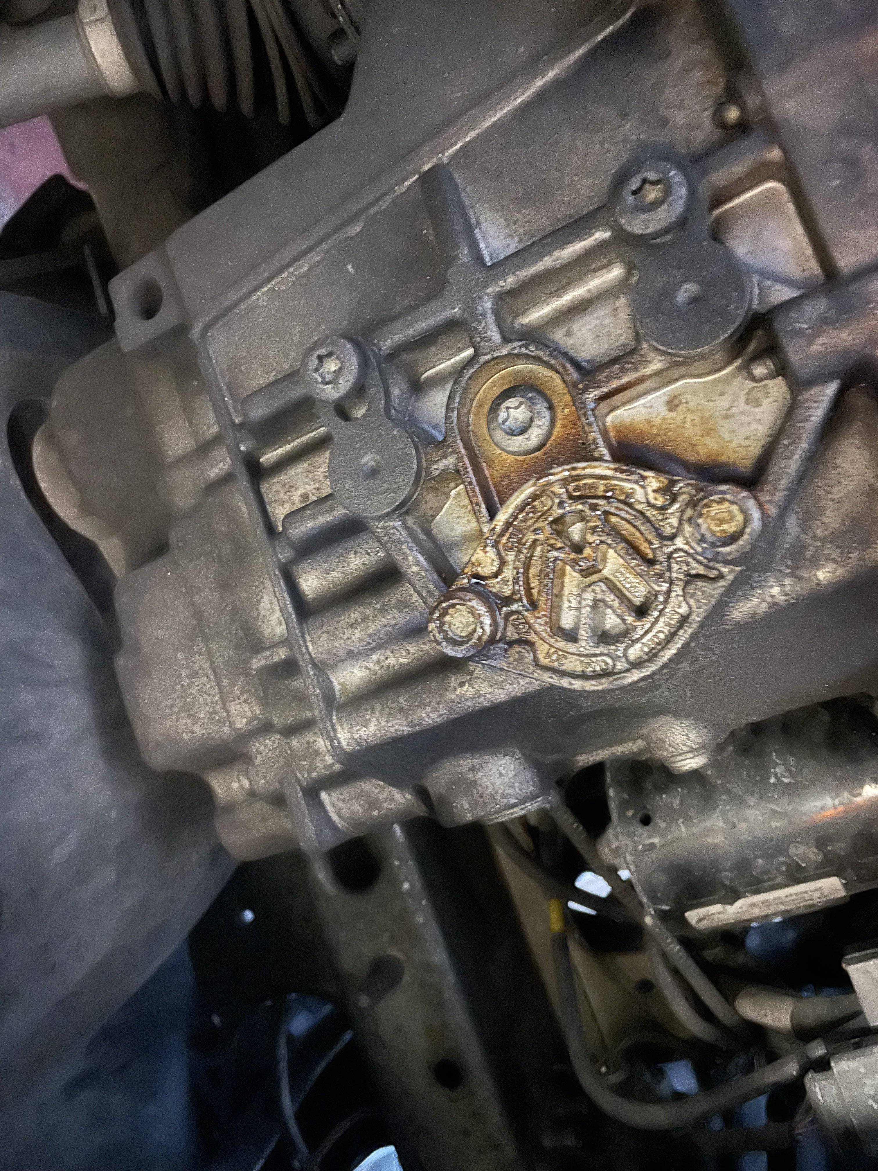

This little plate held on by two splines. Anyone know what it for and can I get a gasket for it?
Don't take my word as gospel but when I checked https://www.lllparts.co.uk/catalogs/skoda/CZ/SUP/768/3/311/311091
It looks suspiciously like a MQ250 gearbox items 6-8 see below.

👍🏻thanks very much. Looks like the part
I would consult the workshop manual before removing anything in case a special procedure is required to stop something dropping out.
There is more than one item 8 fitted, looks it may be leaking from one of them.

Look at the corroded clean alloy areas of the casing then look at the black oily ones and ask yourself has the oil really leaked out of the plate at the very bottom of the gearbox.
