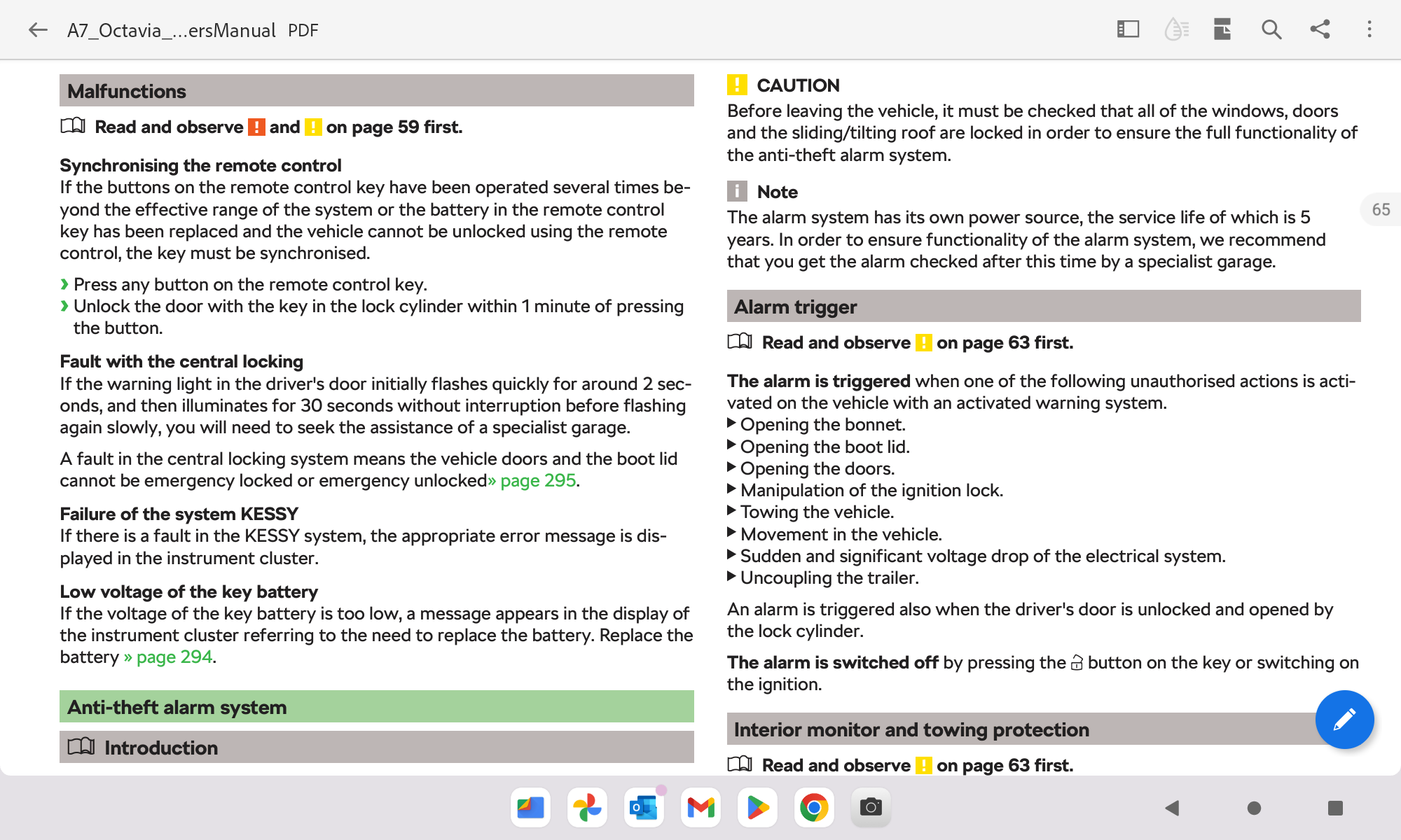

Thank you for that. It sounds like other posters did not know either. I accessed the lock by watching
However, with the new battery none of the 3 buttons show a red light on the remote. Unlocking within 1 minute does not do a sync 😞 At least I can lock the car now with the key. I'll have to go to another garage for another battery in case the last one sold me a dud.
