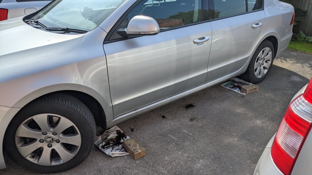

The Dinitrol kit I've used is linked below and contains an extension wand that reaches well down the sill so you can rust proof from drain points. On my Superb they were either end behind the wheel arch liners -- not sure re the Octavia III (I'll check my son's mkIII next time I see it). Look out for any drain holes / and or bungs - good access points for Dinitrol extension.  I've done all the door/boot/bunnet bottoms on our fleet as well as sills, some chassis etc.
Re Owatrol - simply clean and hand wire brush any mud / debris. You don't have to remove light surface rust, Then cover either with the aerosol (great for quick cover of suspension etc) or paint on with a brush (great for blathering spring cups etc).
As an example my wife got a a garden ornament that you hung up a few years ago and within a day or so it was quickly looking awful with rust and she was rather upset - I dried and blathered with Owatrol and it's still looking ok many years later. Also  in addition we painted her 1.2 Panda's rusty sump with Owatrol and it's still looking ok.
All of the above makes a mess - worth an old ground sheet below if you have one. Leave a while for it to settle after treatment so you don't leave a trail of  rustproofing stuff!

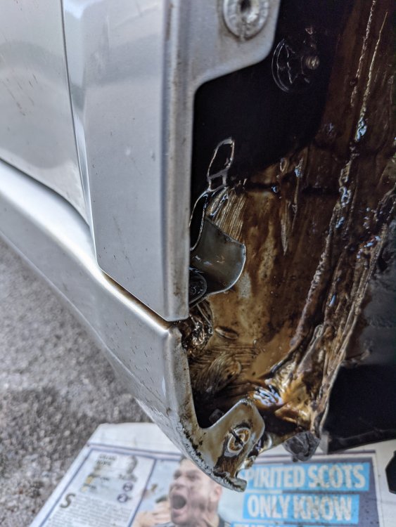

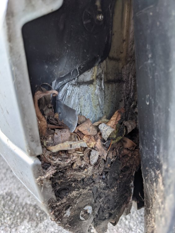

I had some trapped debris behind my wheelarch liners and a sill drain was blocked - used a thin knitting needle to clear. Offending garden ornament at the bottom:-
Edited by bigjohn

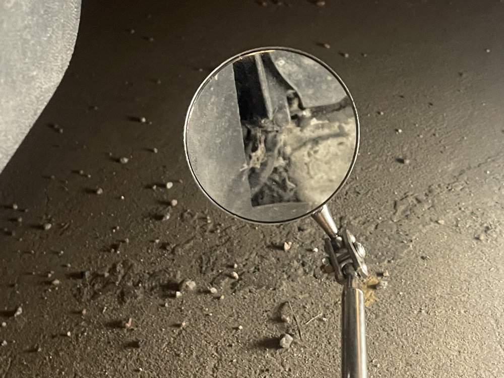

I checked my car this morning and you were right about everything. There is a lot of gunk behind the front mudflaps, same for rear panel, where body and bumper meets in the wheelhouse. It already started to rust
i will lift up the car and get the closer look with the wheels removed and uptade here with the images.

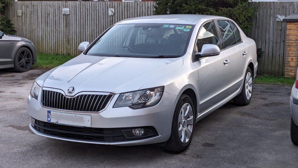

Infact it reminds me - I'll have another look see and quick top up of rustproofing of the fleet as it warms up in the spring. One good thing on my Superb II is I don't have the inner wing large sound proofing foam pads(might be because mine is a petrol) - if you encounter those I'd be tempted to remove as they trap moisture & condensation against the bodywork. That's why you see rusty front wings on some ageing VWs and Audis - especially Passats.
The old timer is now 10 years old and I've had it for 9 of those years. Looking a lot better than the previous 2003 Superb at the same age which wasn't lavished with the same treatment - I now have more time on my hands as I retired three years ago. Still looking reasonable:-
Edited by bigjohn
Looks great!

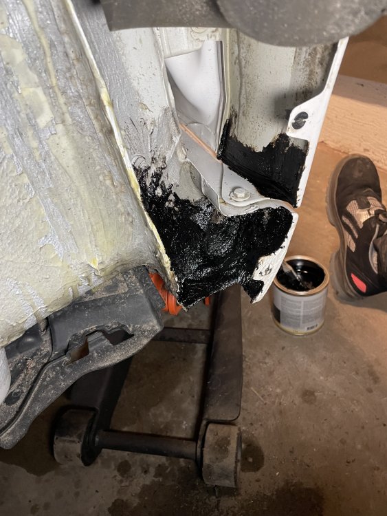

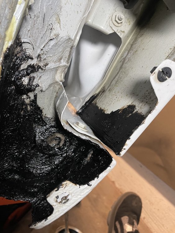

What do you think about bitumen based rust coating?

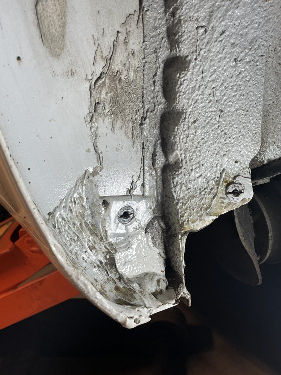

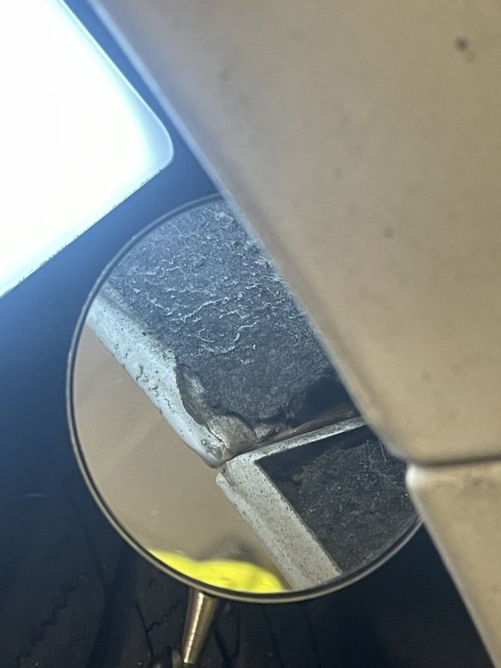

Update:
It looked pretty good after I removed all the dirt that was sitting there. But still I brushed with a dremel and cleaned afterwards with a rubbing alcohol and layered bitumen based rust protection with a brush
