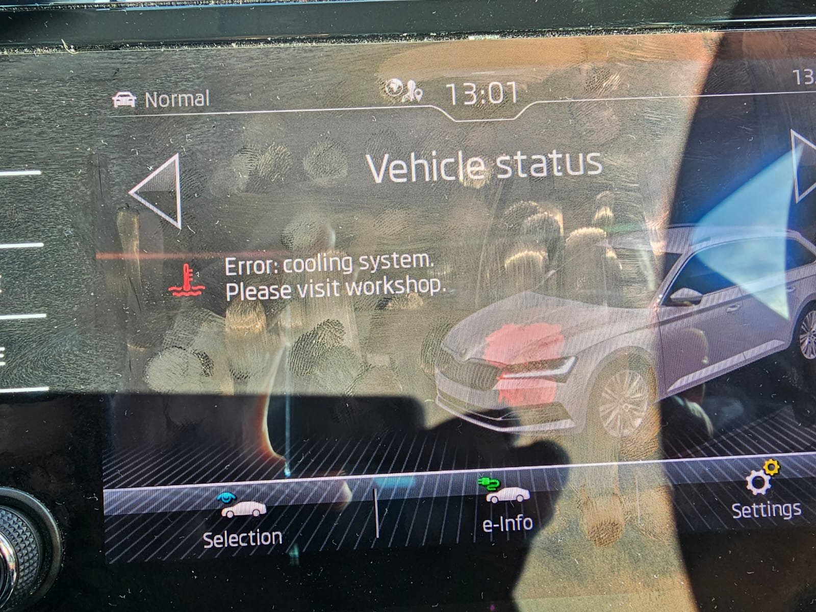

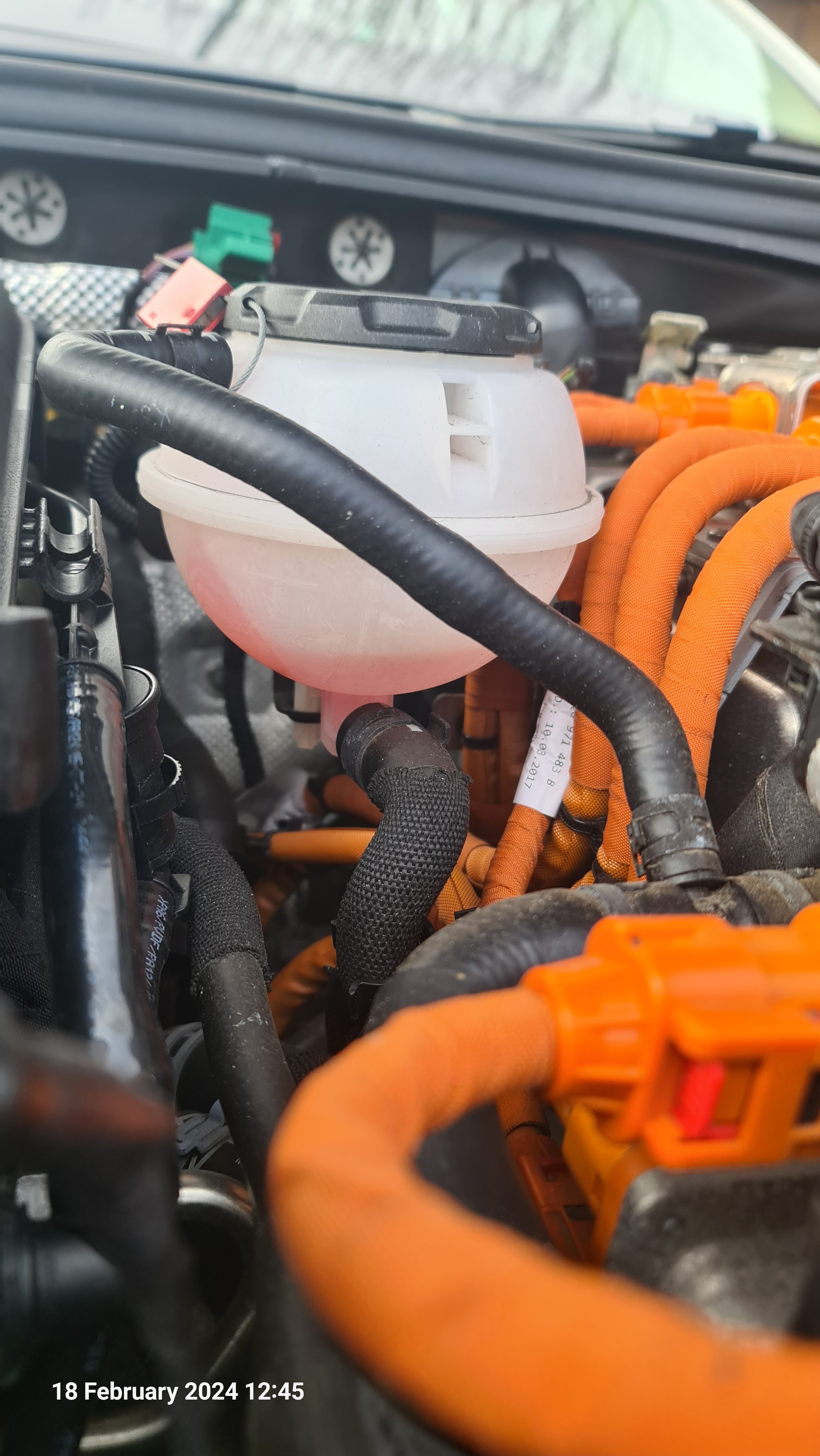

Thanks for accept me.Just bought a Skoda Superb Estate iV Hybrid from 2020 and after few days I receive this error mesage "cooling system" ,and when I take a look, the right side tank was empty (tank for cooling electronics).After I get out the pipe slowly, I flush a lot of air and the coolant was back on the normal level !!! Its happend all the time after I drive more on electric, I must to stop, flush again and all good for a while.Pls help me with some ideea.Thank you.
Please describe what you mean by flush the system and flush air?
I take out the rubber hose slowly and I let the air to go out.
Because the cap was sealed.

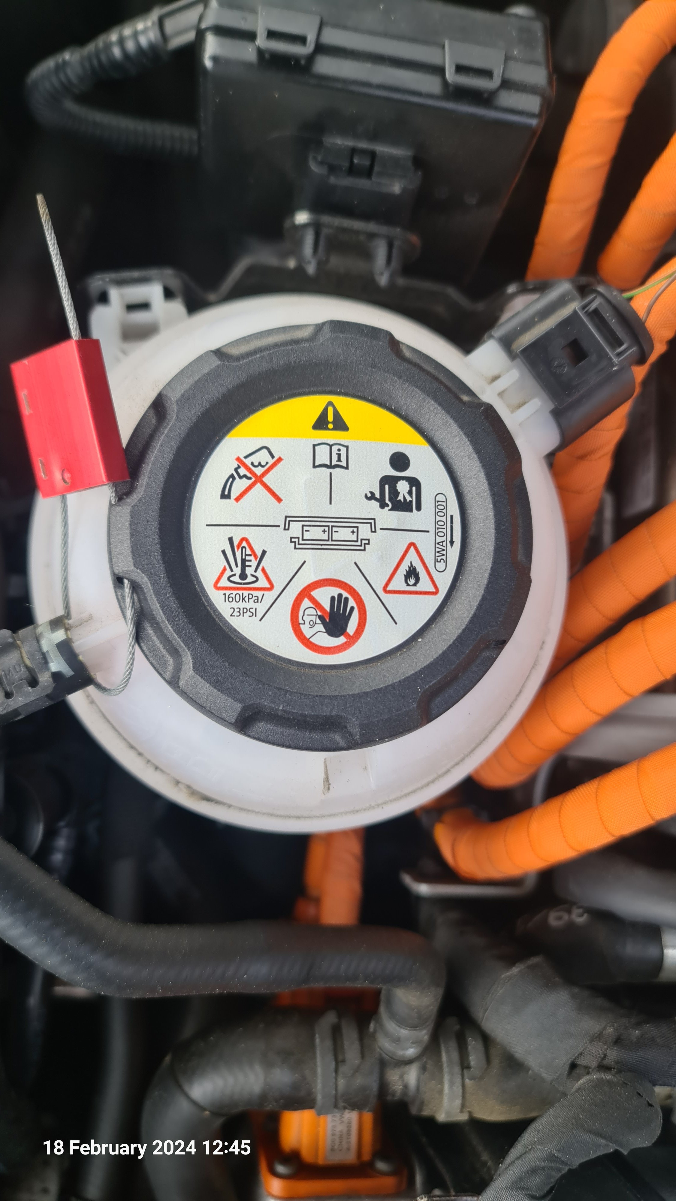

You need to visit a Skoda or even VW/Audi dealer for specialist help. I doubt anyone here can help. As the coolant reservoir is sealed, I don't think its wise to start removing pipes. Especially as its a cooling system for the electronics and battery and the warning label makes it clear you shouldn't mess about with it only qualified technicians.

To the OP, you should only release the cap or the pipe when the system is stone cold, you have a low fluid level which the system has detected, doing what you did just releases the compressed air allowing the heated coolant to expand into the space, if done cold you could top up.
I would not take it to a garage but thats me and I'm not advising others what to do, I would cut through the tamper seal as the garage would and remove the cap not the hose to top up.

There is a clear warning not to top it up. I don't understand why, but as this is a safety related system, cooling the main Li Ion battery, I wouldn't mess with it until I had detailed knowledge about this particular system and its servicing requirement. You would certainly need to know exactly what coolant, concentration, level and whether the sytem is permanently pressurised.
There is likely a leak somewhere, which might be a safety issue.
See the dealer and ask them for advice.
The reason this coolant system is sealed is like you said - it cools the HV battery and HV components - if this level drops then there is a good chance of there being a leak - this means external and risks frying HV components or internal and risk starting a lithium fire or HV charging the vehicle chassis (Although extremely unlikely considering the safety involved in a HV battery). Its sealed for this very reason and if the level drops and your average joe just keeps topping it up, then problems are to be expected.
That and from a warranty point of view there is a clear indicator the cap hasnt been opened so no incorrect fluids have been added.
