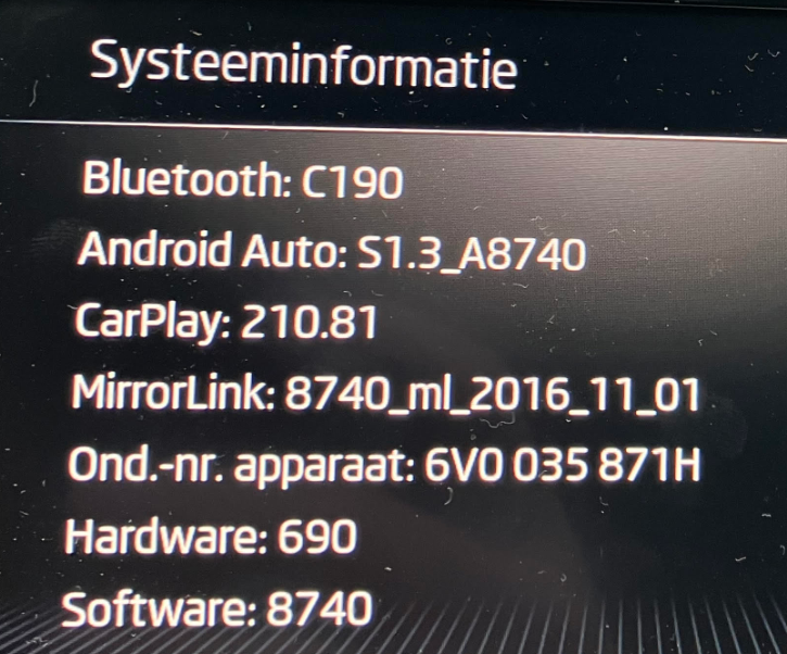

Hi!
i have problems getting Apple CarPlay to work on my 2019 ŠKODA Fabia Combi Monte Carlo. I have tried updating the software, but it still gives me an error message when connecting to AirPlay, asking me to check if my iPhone supports AirPlay. I’ve tried different phones, different cables and made sure CarPlay is allowed in Screen Time.
Anyone know why I can’t connect?
Thanks!
- Peter

I’ve tried resetting to factory settings twice, and used an original Apple Lightning cable, but still no luck. I take it from your replies that from the looks of it, there’s nothing to indicate that CarPlay somehow isn’t activated or supported by my car’s software or hardware. Faulty USB-port doesn’t quite make sense either. Unless there’s any other possible solutions I guess I might need to see a certified ŠKODA repair shop?
