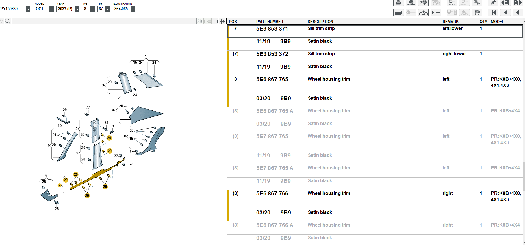

does anyone know the part number for the interior plastic trim panel at the bottom of the front passenger door?
colleague in work has a mkiv and one of the kids managed to crack the piece, so hes looki g to try and get a replacement.
Is it No7 ?
@Giannis20
looks like it yeah, and it all one piece through both doors?
17 hours ago, mac11irl said:
@Giannis20
No there are two different codes. Please see No7 and No(7). One is for the left and the other is for the right side

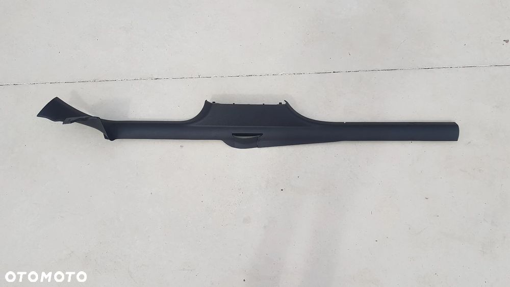

yeah, sorry, i meant it runs from the front door through to the back door on each side ;)
it's one piece.
