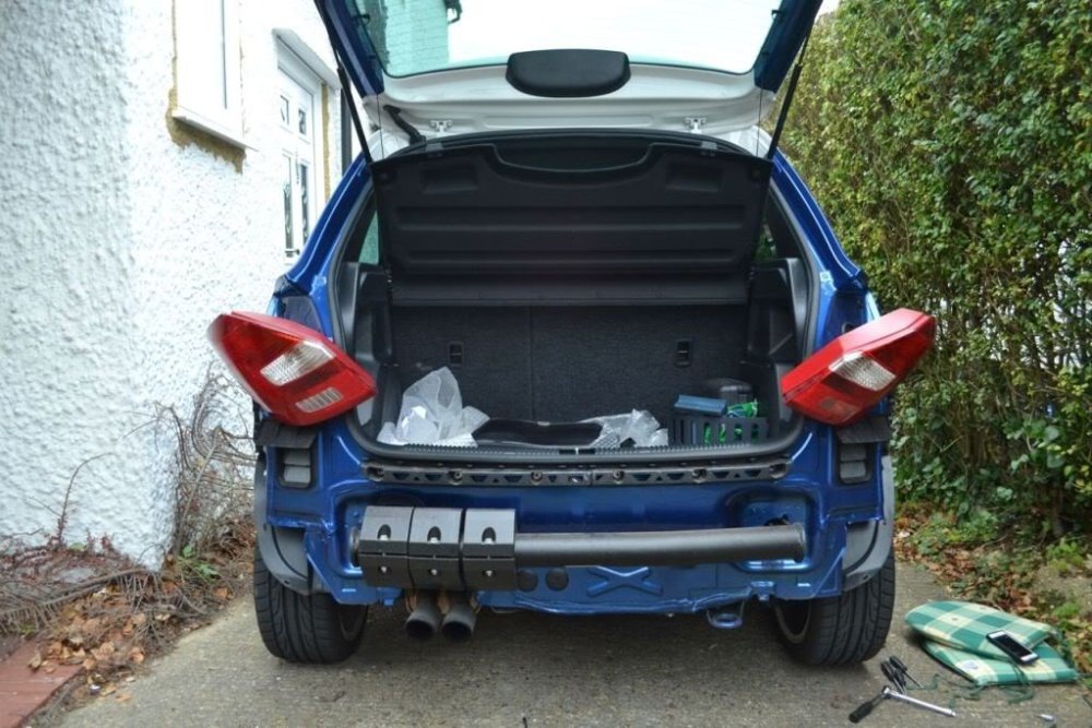

If the cheapest Skoda is lighter than the estate, and the Polo, Seat (and the Audi A1 5 door sister car even though it is 136 kW & not only 132 kW) which cost quite a bit more and would be a lower or the same VED class than add 'Success Ballast'.    Design, Manufacture & Test adding extra weights and stick them only on the Skoda.
Others are making cars lighter,  VW tell Skoda, MAKE IT HEAVIER AND GO LIGHT UNDER ACCELERATION.  Do not just fit the correct rear springs.
Vorsprung Durch Technik.
58e68bea62c88_SkodaFabiarearweights(1).jpg.8a3ed183a486ac72406750281a1e222a.jpg.35c70b79cd6cb913326c422ff102ab1c.jpg

1 hour ago, Diljit said:
response
Holy moly I didn't even notice that what the f*** is all that about. They actually put white on one side of the car. What the f*** is this all about?
