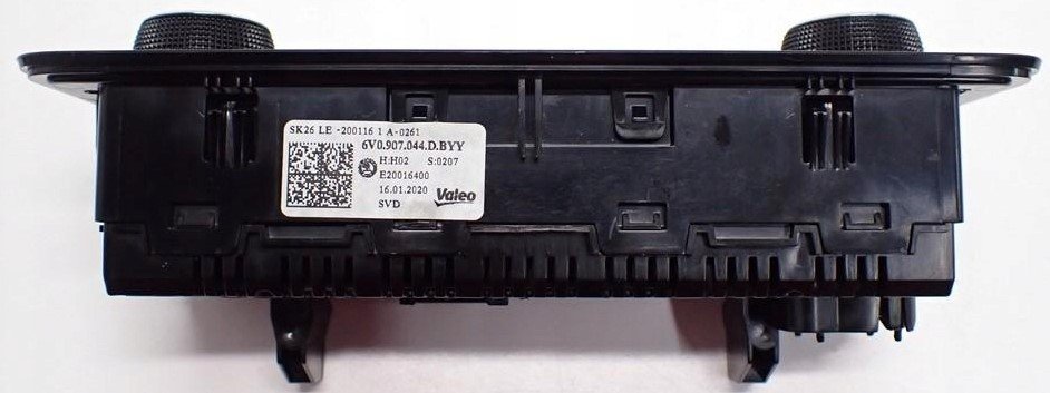

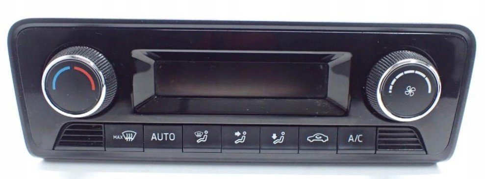

I read somewhere on the internet that it may also be the fault of the air conditioning panel.
Not thinking much about spending blind money at the service center, I ordered an air conditioning panel.
I only ordered a newer 2020 Fabia 1.0 TSI car model.
After installing this new panel, everything seems to be working, but in fact whether the AC is "on" or "off" makes no difference. The air conditioning generally does not work, everything else works, but the air conditioning does not work even on a colder day.

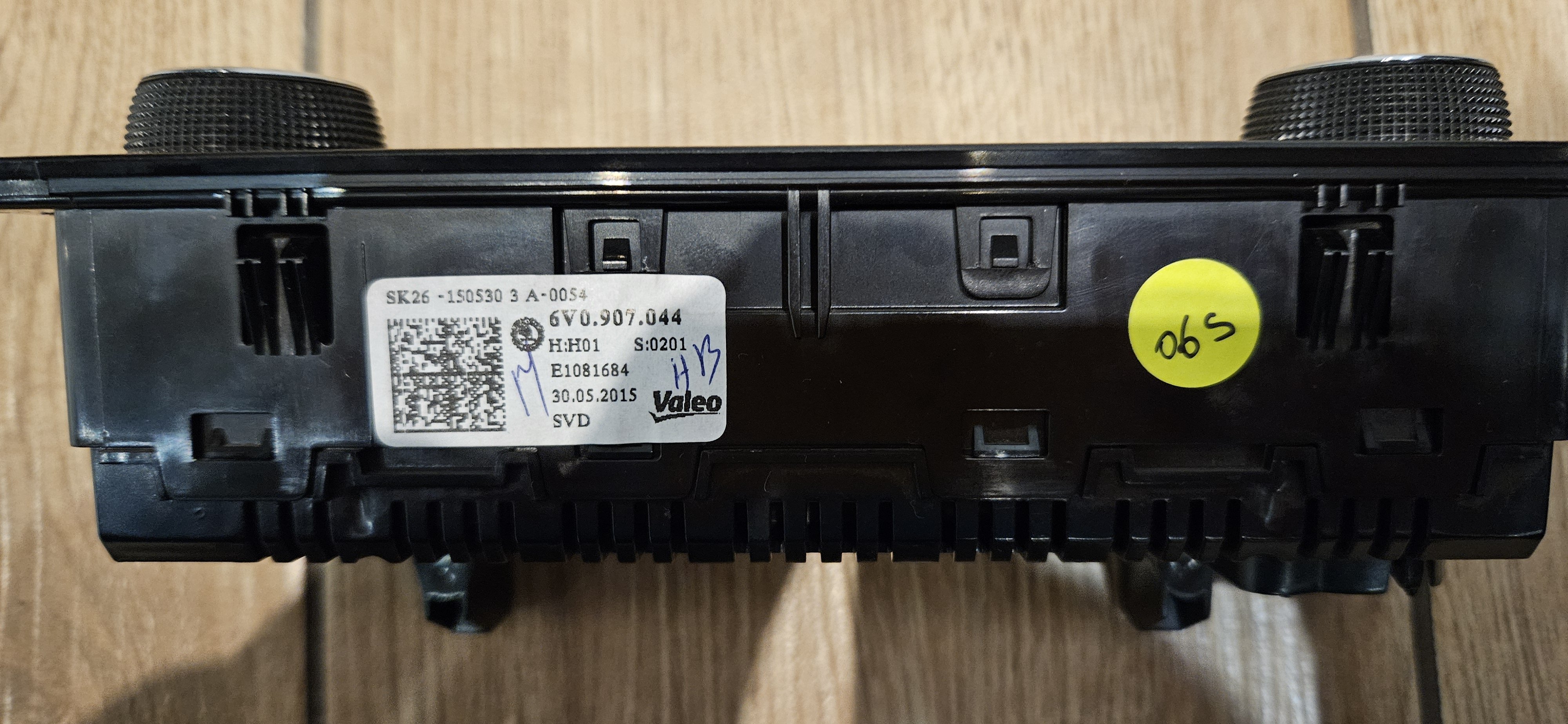

With the old panel, at least it works on cold days, but with the new one it doesn't even work on cold days.
Is it possible that the new panel has different parameters and is simply trying to start a different compressor than the one in the car? Maybe someone has an idea how to solve it or has already had such a problem with air conditioning.

Edit:- for the time being, I'd be inclined to refit the original control panel just in case its S/W is different and so not suitable for use with your age of car - at least you know that the original controller allowed the system to operate at lower outside temperatures.
