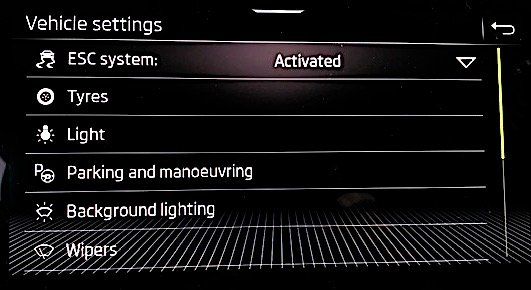

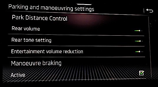

On my Fabia Mk4 the feature is accessed through the infotainment screen through the VEHICLE settings, then choosing "Parking and manoeuvring", followed by "Manoeuvre braking" and selecting "Active" or not. (Images below)
