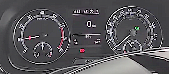

Fortunately, the Fabia's speedometer is properly illuminated and - as offthewall has advised - speed can also be displayed as a digital value centrally between the rev-counter and speedometer dials using the controls on the right-hand spoke of the steering-wheel. (This is just an example, not a current-model Fabia Mk 4's speedometer.)
