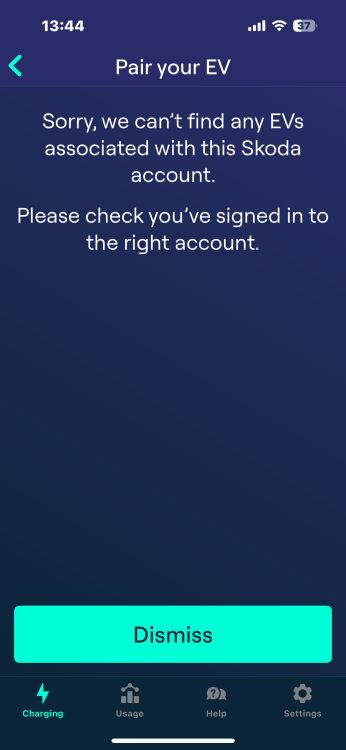

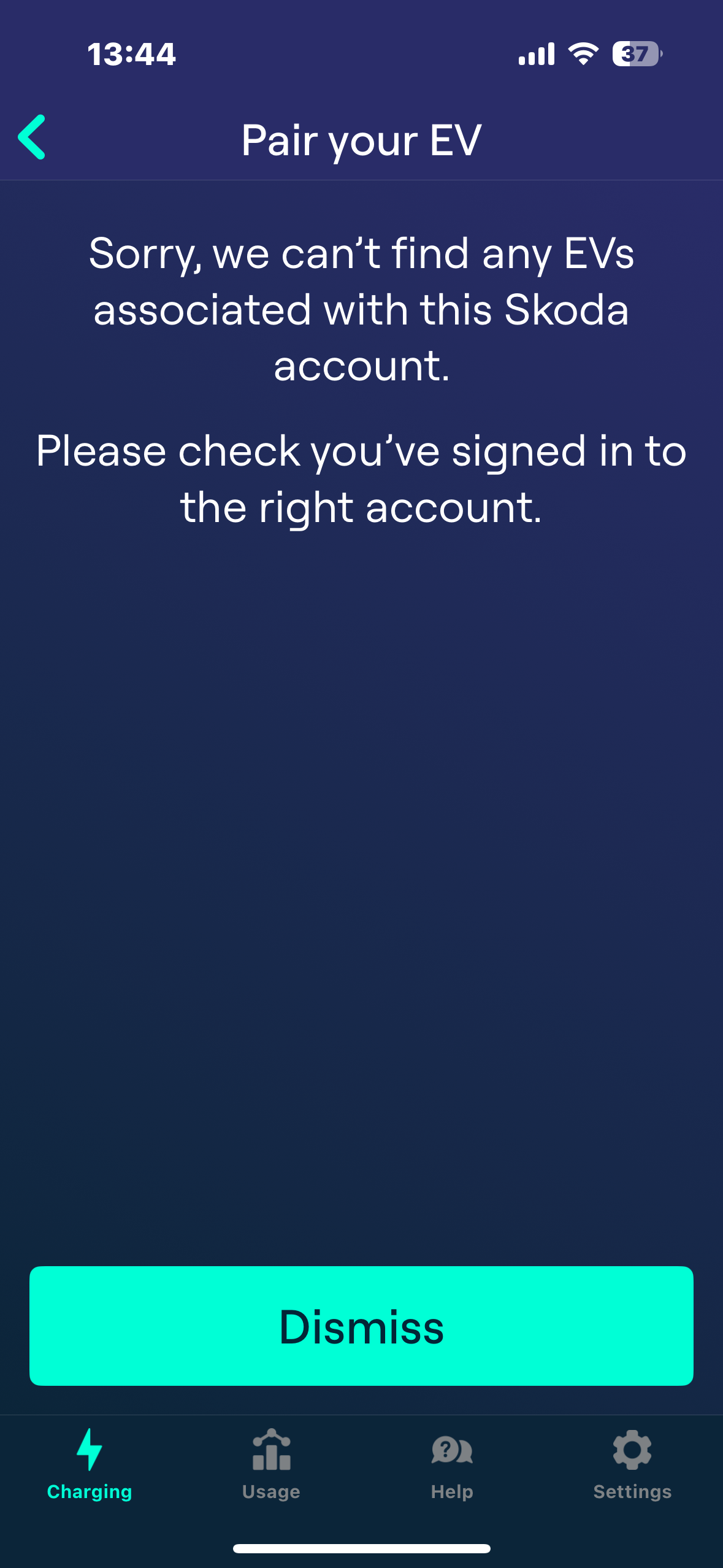

This is what I get when trying to pair my Ohme to my car via My Skoda account.

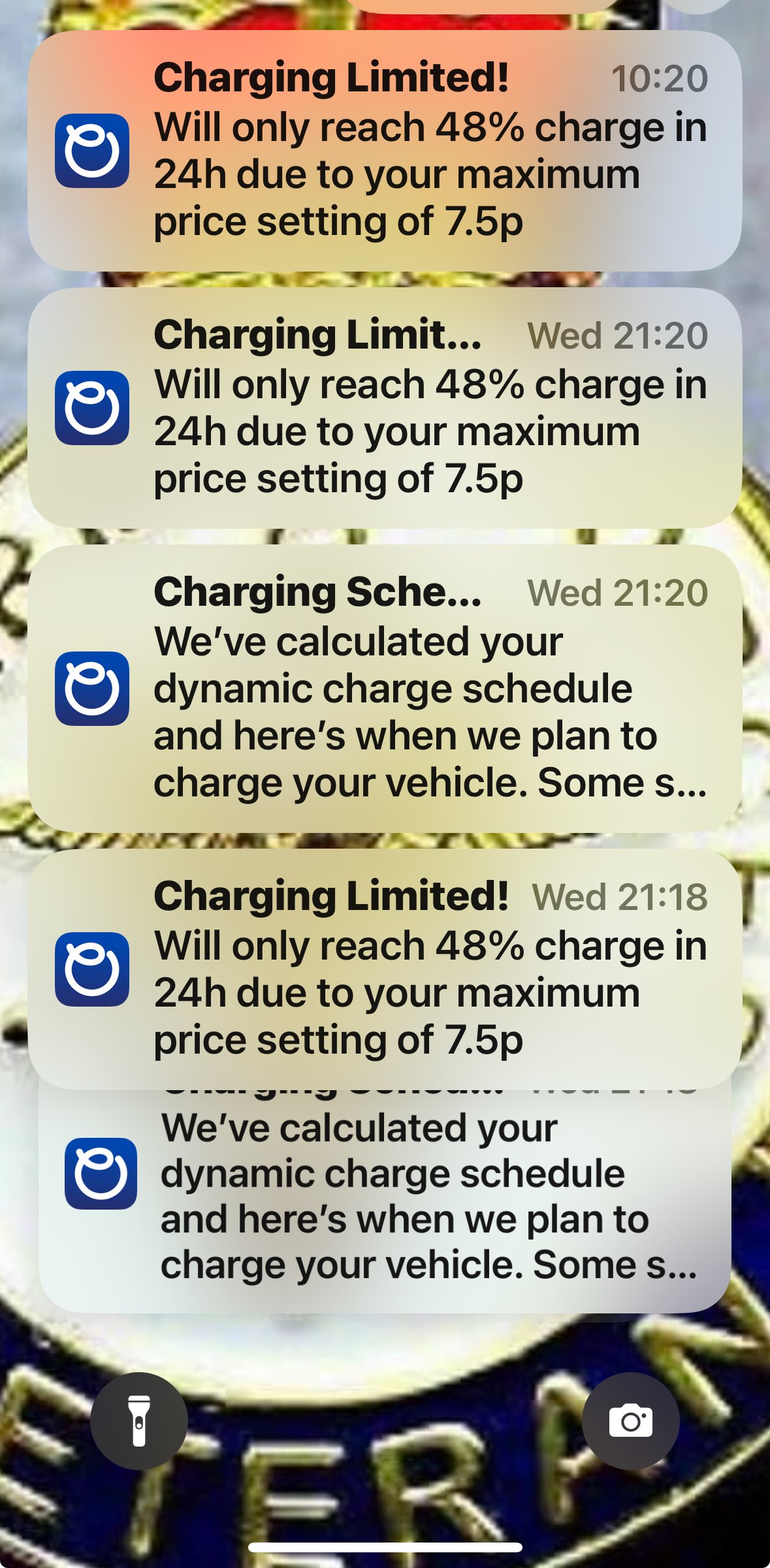

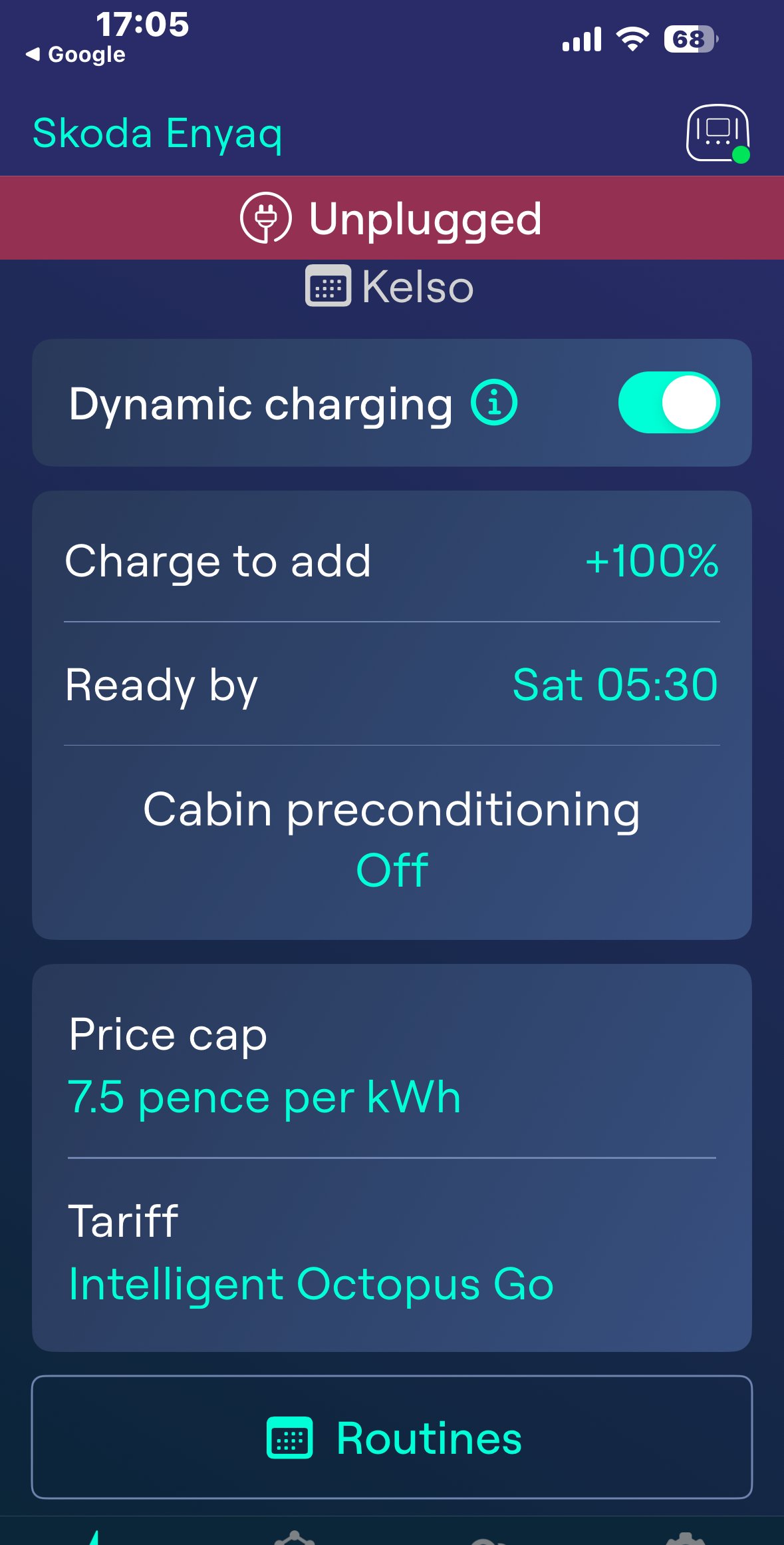

Screenshots from Ohme app
That’s interesting regarding Ohme. Mine often reports it’s lost its connection but we have great signal here.

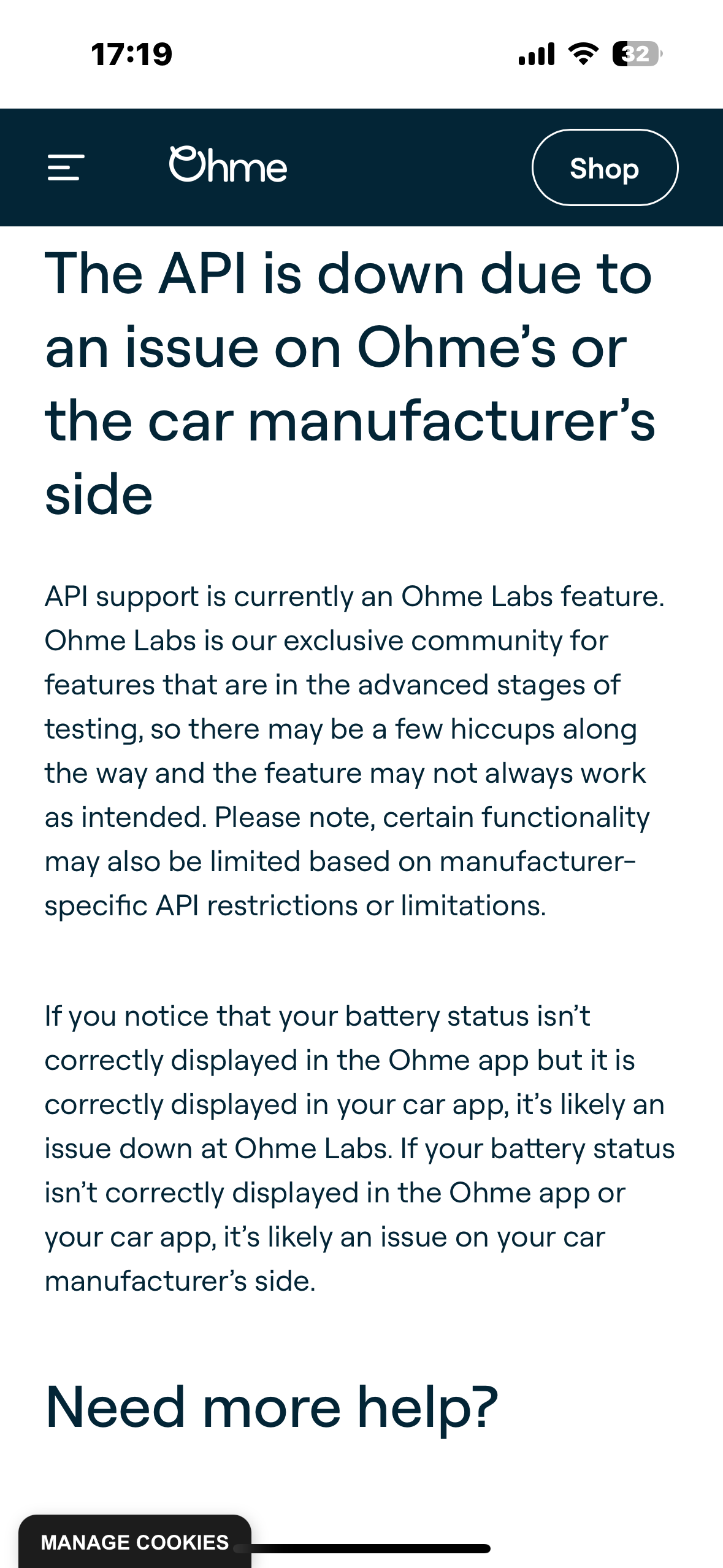

Found this on the Ohme site so I believe the fault is with the Ohme not the ŠKODA IMG_0392.thumb.png.363d20724be00962130a311edf1055be.png
