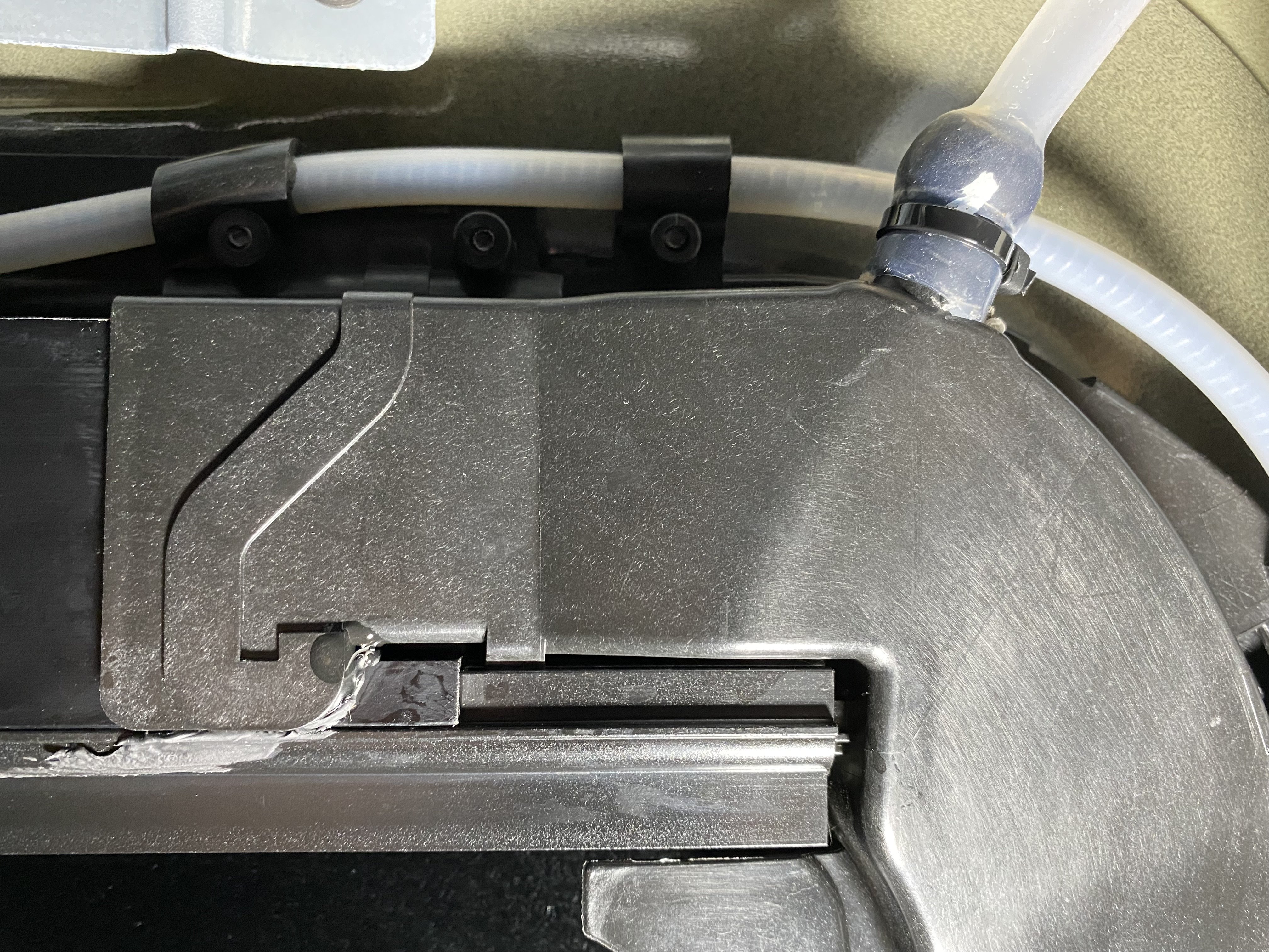

Good tip, cheers for sharing your experience! However if you have the roof lining down you can soon spot a leaking cassette - there's no way to get it mixed up with a leaking windscreen. I still haven't worked up the courage to take mine down and fix it, and am driving around bare-roofed for a third year. Doesn't bother me too much TBH but my wife's patience is running out.
The picture is from the front off-side corner and you can just see the water building due to the broken seal between the front and side panels of the cassette. The video is from the rear near-side corner and this time the leak is due to a blocked drain hose.

Have you watched this series of videos?
Using something like Captain Tolleys might be enough to sort it over time without you having to get totally destructive with the roof lining. I can't 100% get my head around exactly where you leak is when viewed from the top of the car but where he runs the crack repairer in the video might get to it.
