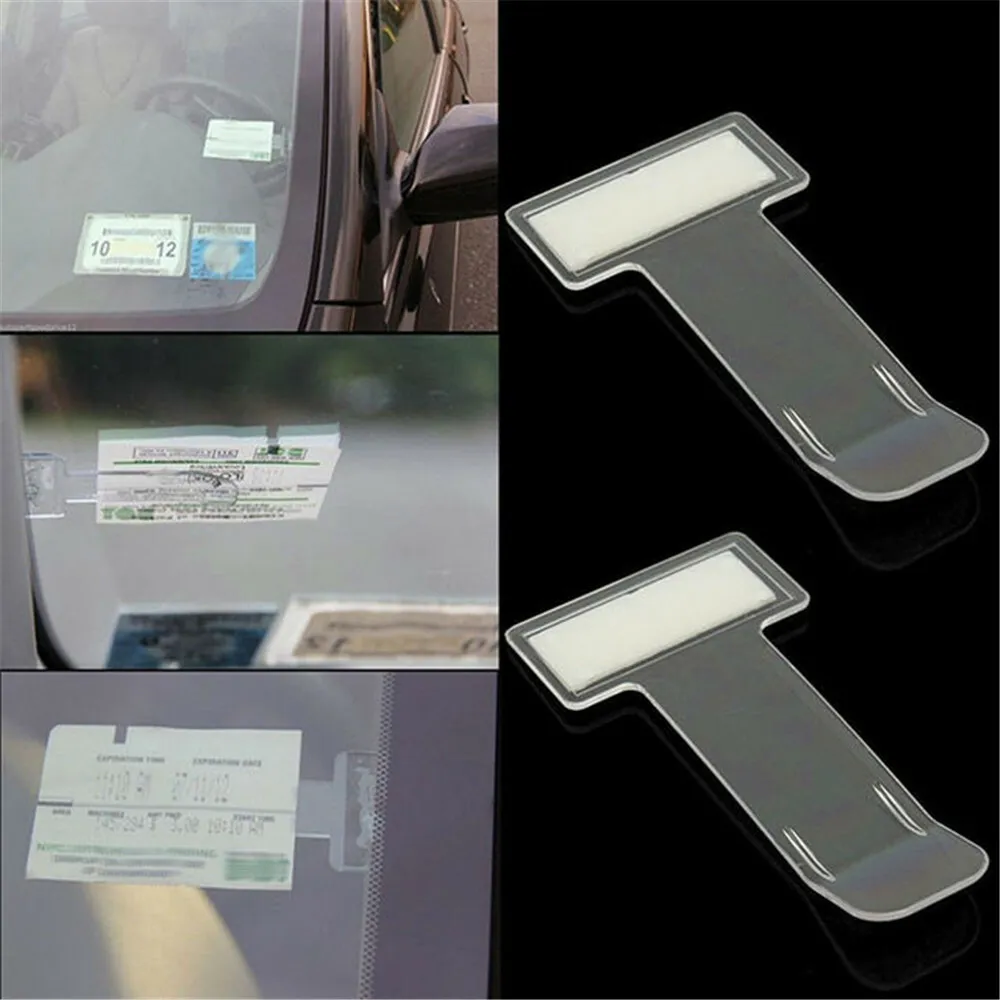

If you feel it is too difficult or too much hassle to remove the trim. You can buy stick-on transparent clips on ebay for a coupl
