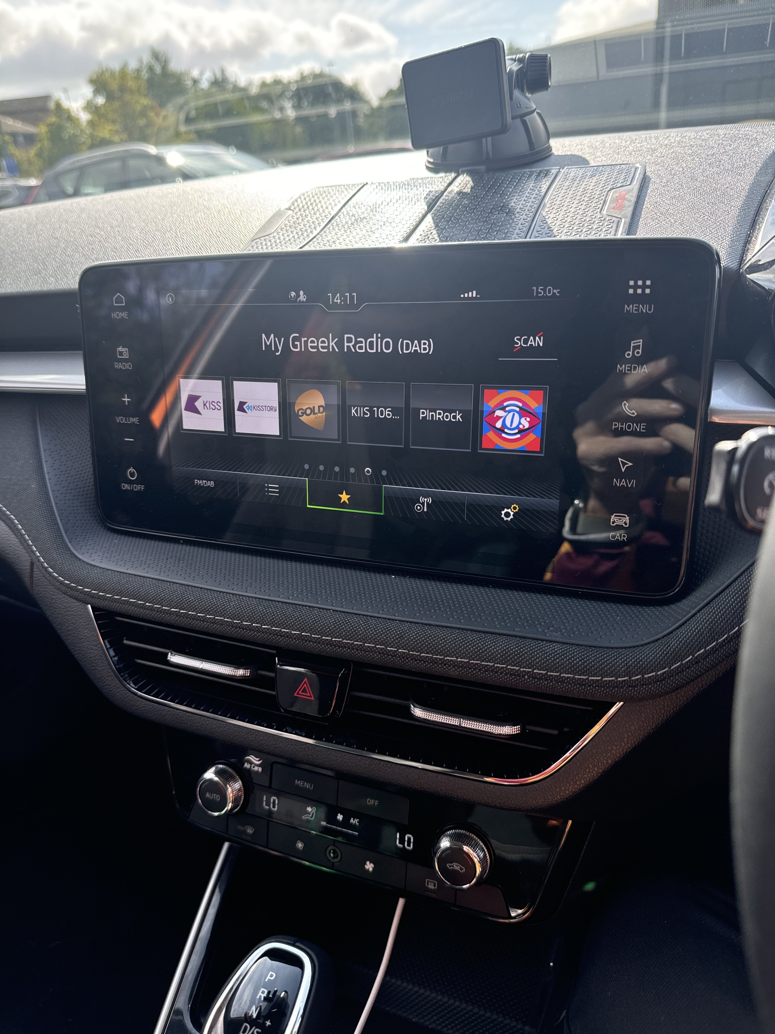

9
Your photo is of the AMUNDSEN 9" unit (which is the one I have in my 2024 Fabia SE L car) but - as I said above "I can't find anything in the infotainment unit's options that would allow me to add a logo to a station in the listing that lacks a logo, nor to alter/delete the logo of a station with a logo."
The part of the Fabia MK 4 online manual that relates to the Amundsen unit's radio does have references to station logos, but not to what (I think) you want to do.

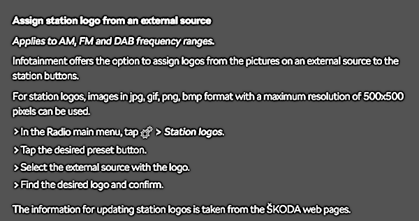

I've looked at the online Owner's Manual for a 2019 Fabia Mk 3 and this contains the following guidance relating to the Amundsen infotainment unit fitted to that model.
Although Fabia Mk 3 and Fabia Mk 4  cars can both have Amundsen infotainment units, the units themselves are quite different. There is no equivalent  "Assign station logo from an external source" advice in the part of a Fabia Mk 4's online Owner's Manual that refers to the Amundsen unit, so it is reasonable to assume that capability is no longer present for Fabia Mk 4 models..
I understand that assigning a 'custom' radio station logo to a Fabia Mk 3's Amundsen infotainment unit involved transferring the logo from an SD-card into the unit, but the Fabia Mk 4' Amundsen unit has no SD-card slot and - to the best of my knowledge - there is no way to to transfer a logo to that unit by using one of the car's  USB-C ports.
